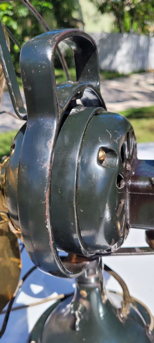

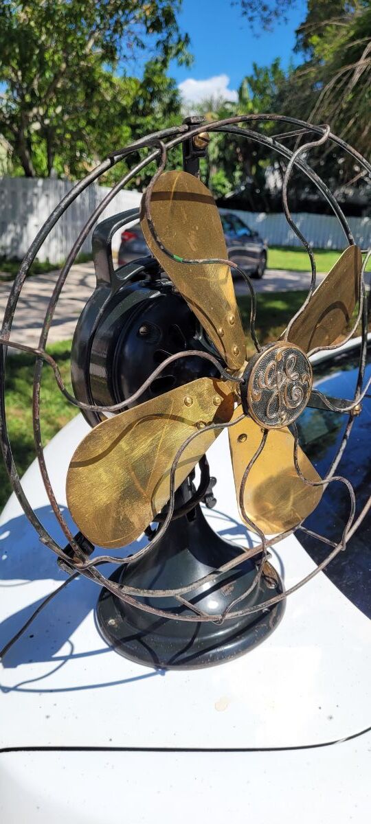

  5. Steve Stephen’s example pictured and the one in my living room are welded cages just like yours. I would say yours is correct especially since the badge paint appears to match the motor paint. Nice solid find.

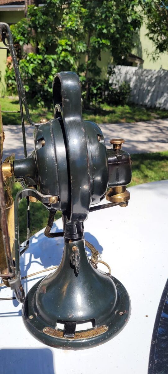

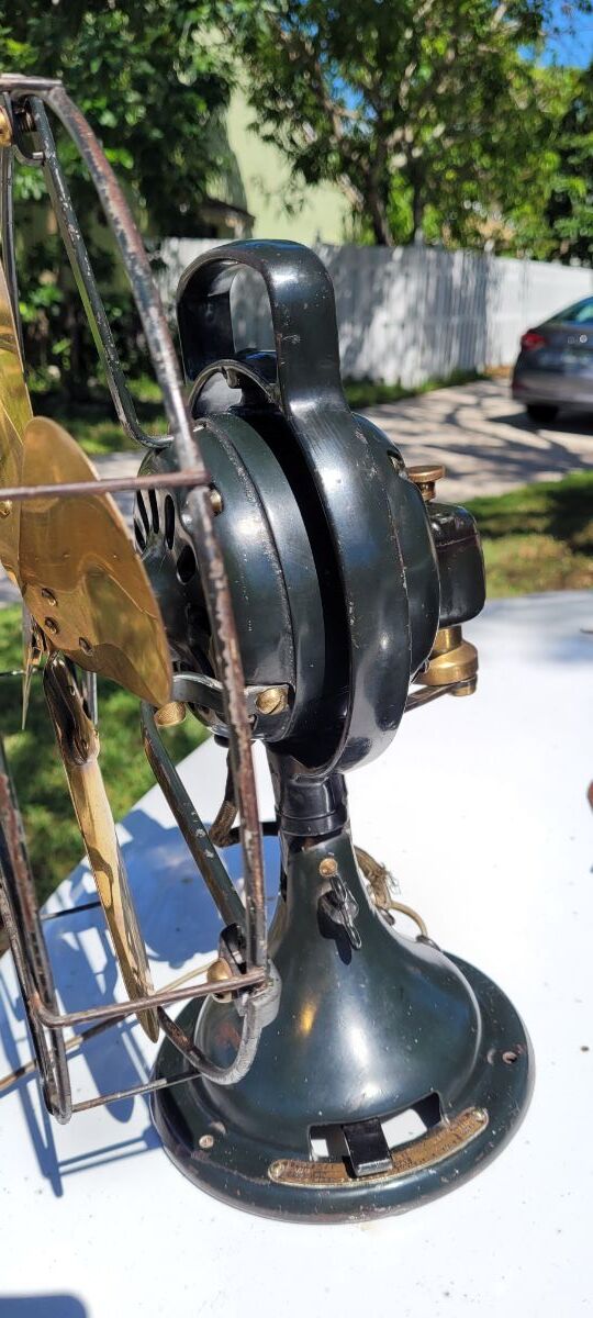

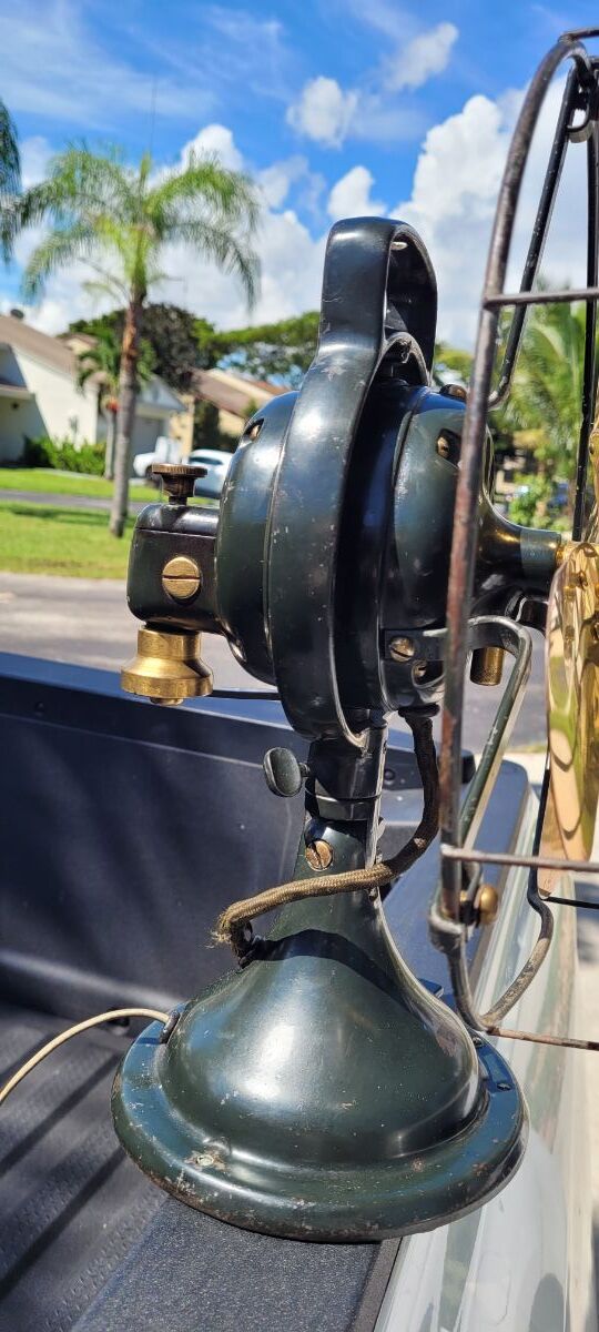

  6. Another, Form AB, with original finish. So often someone removes the paint from the brass bell but GE painted them all the same color as the rest of the fan.

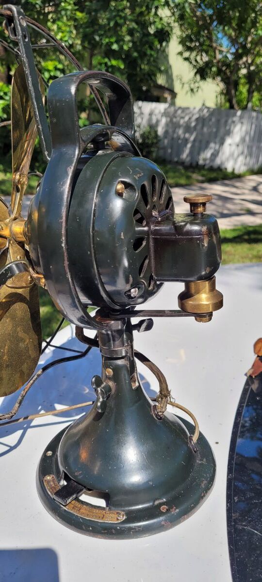

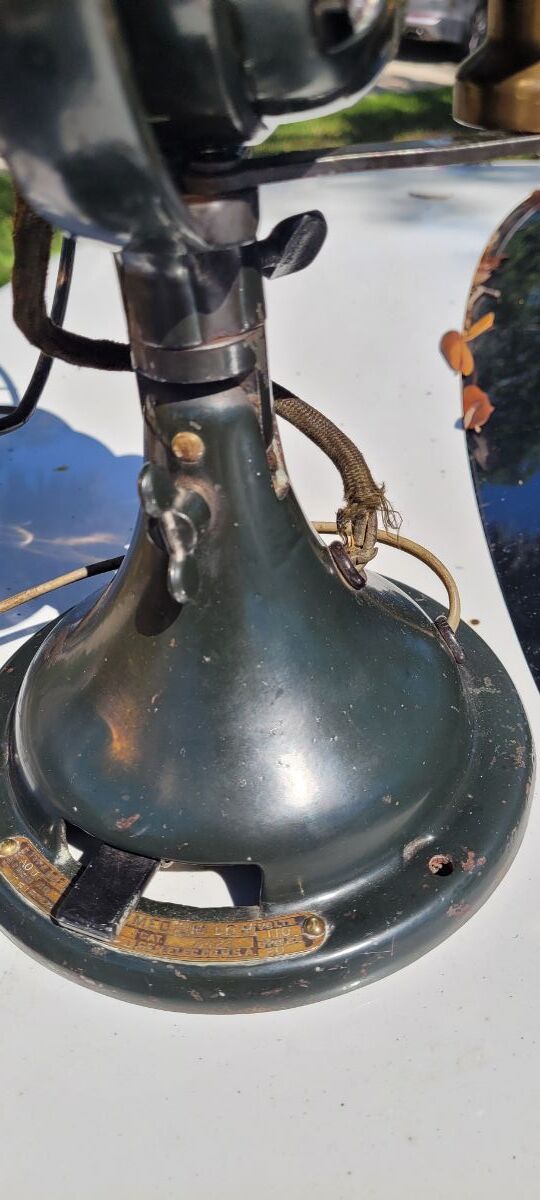

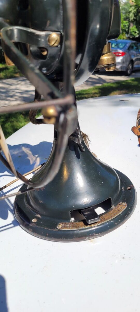

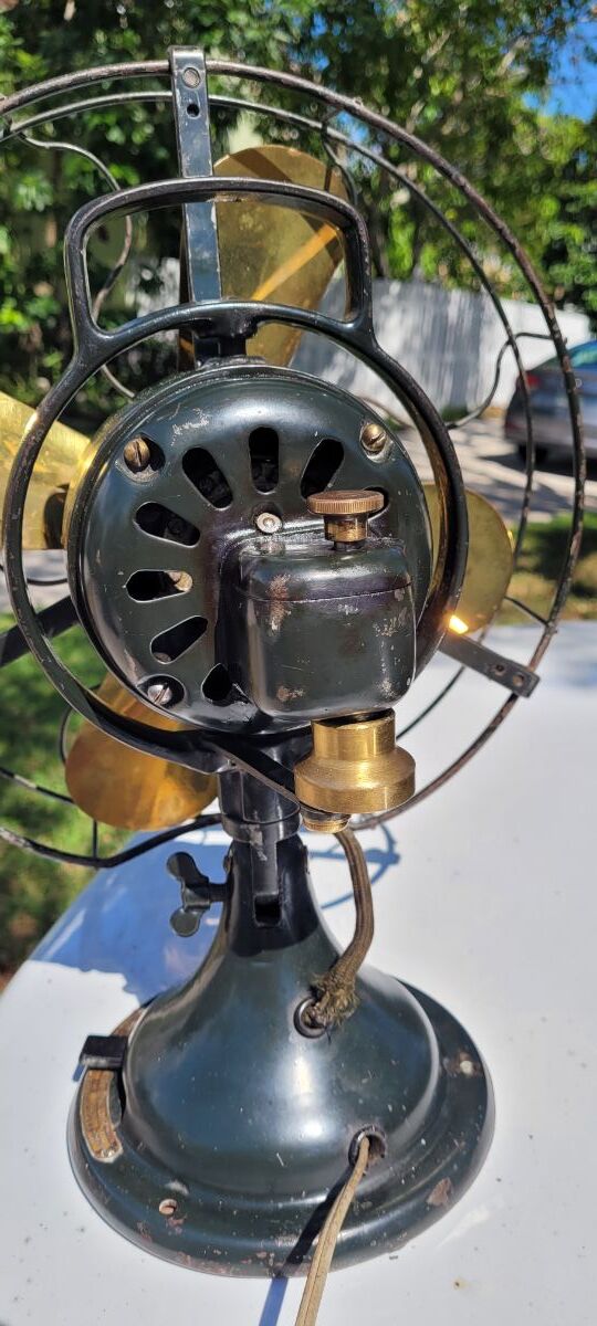

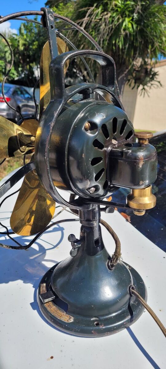

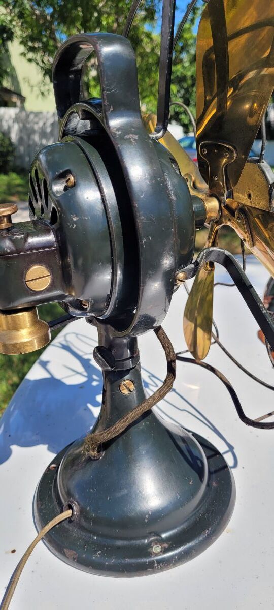

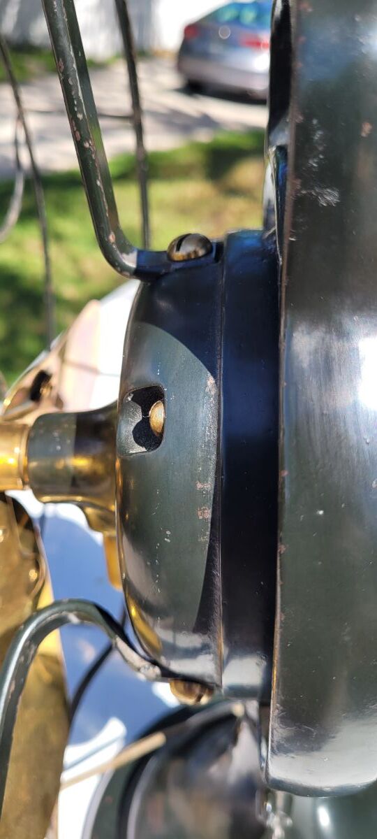

  7. Picked this fan and it has its original paint in pretty good condition. Form V5 which is 1920 according to the Form # chart. Original headwire also. Cage is welded and should be wrapped? Wrong cage?

  8. Also called a round back because of the gear box shape. The link screws on to make it oscillate continuously instead of having a place to tighten and engage the oscillator on top. The next model after that one has the same shape gearbox with an early star engagement.

  12. Thank Stephen, the tag was the main reason I bid on it. I couldn’t make out the type number in the photos but realized it had the earlier braille tag. The only other one I have is on my 1520.
