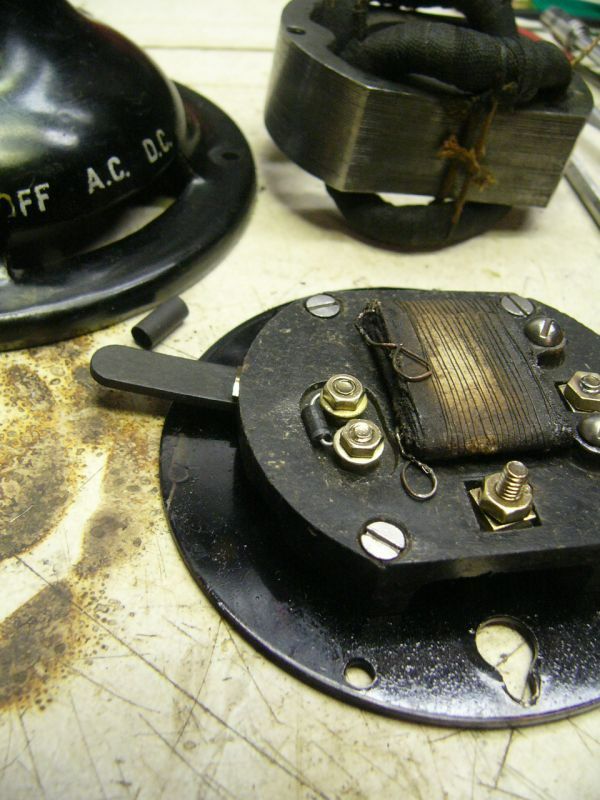

  6. No pot metal. Base is cast iron, motor housing is cast iron, The blade is heavy stamped steel sectioned at the hub. The stator and armature are quality made. Model 3500 on the left, model 3504 with oil cups on the right. The AC and DC selections were intended for the circuit you were on. The DC selection was intended to compensate the increased RPM direct current would create using a small wind of resistance wire in series. In the image below I used a half wave diode to do the same and bypass the resistance wire. On AC current the resistance wire or diode serves as a nice second lower speed.
