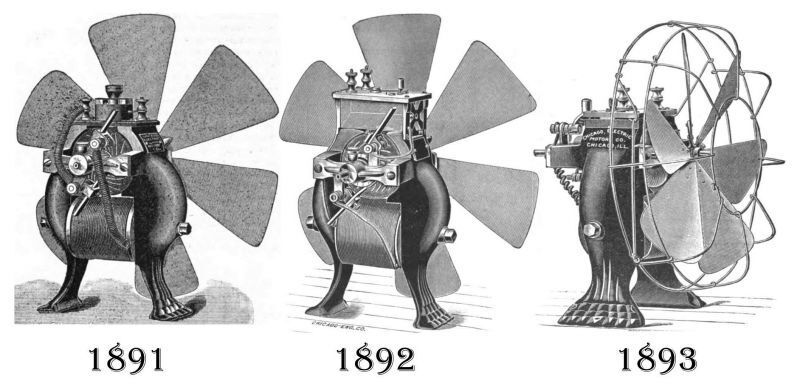

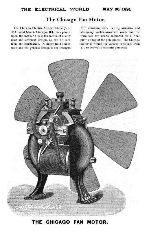

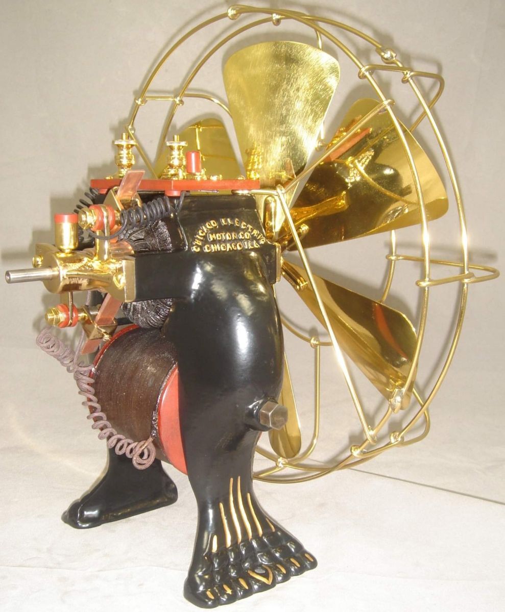

    I’m posting some 1890's fan images, perhaps weekly, or at least until a correct response is posted. In theory, each succeeding image should become more difficult to identify than the previous; in cases where the fan isn’t so hard to name, perhaps I’ll post just a portion to make the task a bit more of a challenge…
    Images courtesy of   miSci   The Museum of Innovation and Science      Schenectady NY
Year number three...
Edited by Jim Kovar
Randy Welch has one...

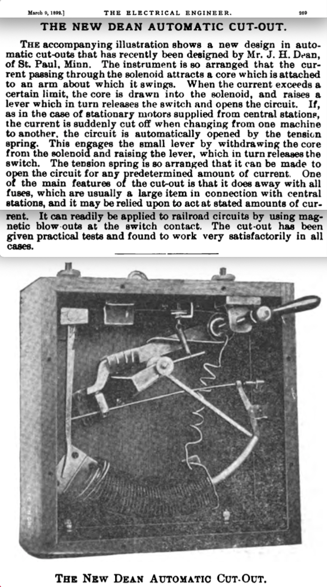

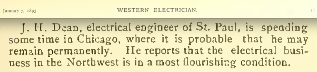

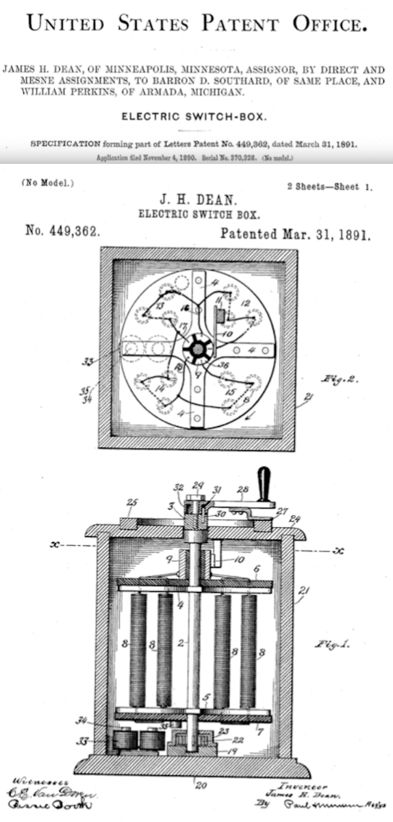

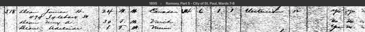

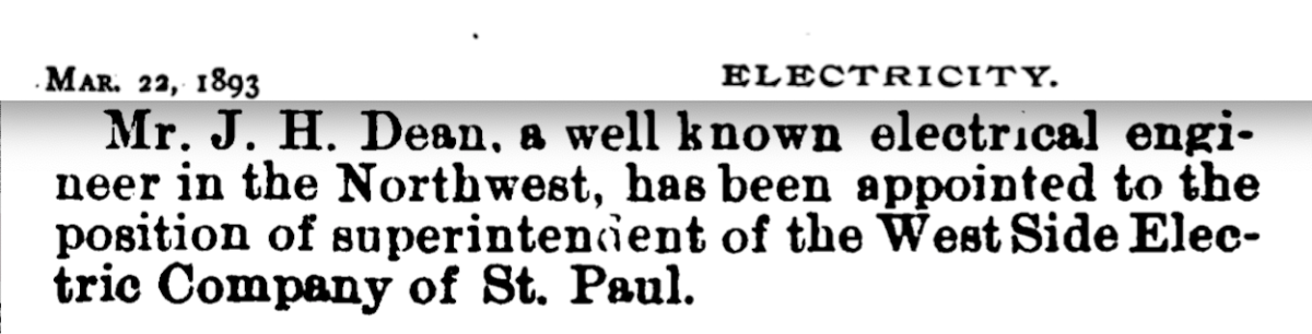

          More on James H. Dean, the only one of the three principals to keep at electricity...
211607526_7Feb1891WesternElectrician-ChicagoElectricMotorIncorporationcopy.png.5baf9a23f4ee47af9138775f8c7f32a6.png.7f387378b9170fff3b143fcc8e9cdb61.png
932962121_9Mar1892ElectricalEngineer-Dean.thumb.png.91c67d1961826ec3c132de361cc26e1c.png
447873838_7Jan1893WesternElectrician-Dean.thumb.png.f502e66d0773887a5b7b05b1716cfefd.png
583770936_18Nov1893ElectricalWorld-Dean.thumb.png.de4abfda71578c0a85fd894402ed7f29.png
Edited by Steve Rockwell

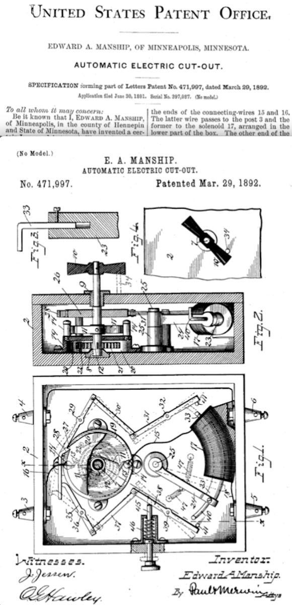

          The remaining member of the three principal organizers, Edward A Manship, seems to have never moved to Chicago, seems to have been in the shirt business consistently through the company's existence, and departed the twin cities (where the three appear to have first connected) to set up in Sioux City Iowa, where he perished year 1900.

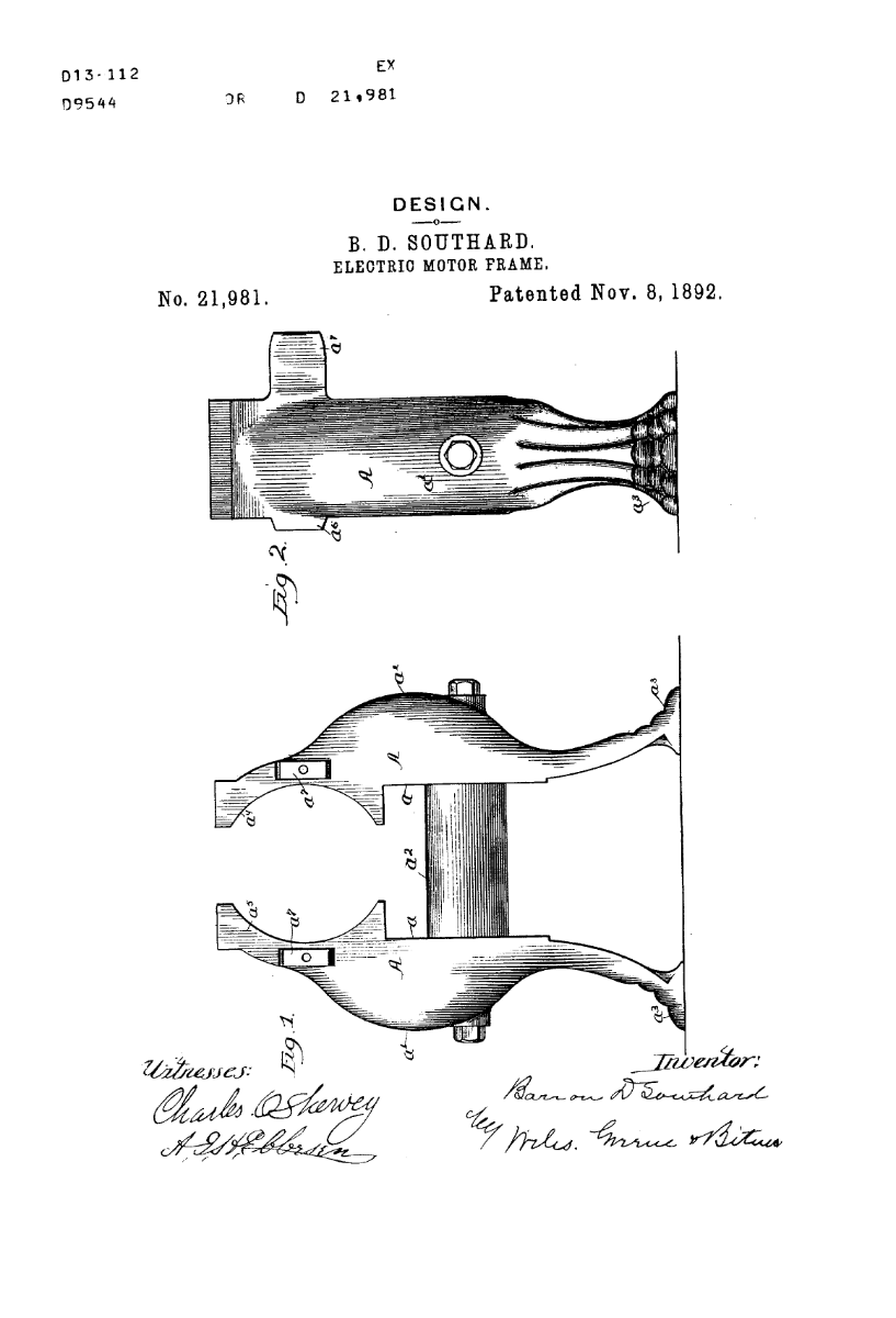

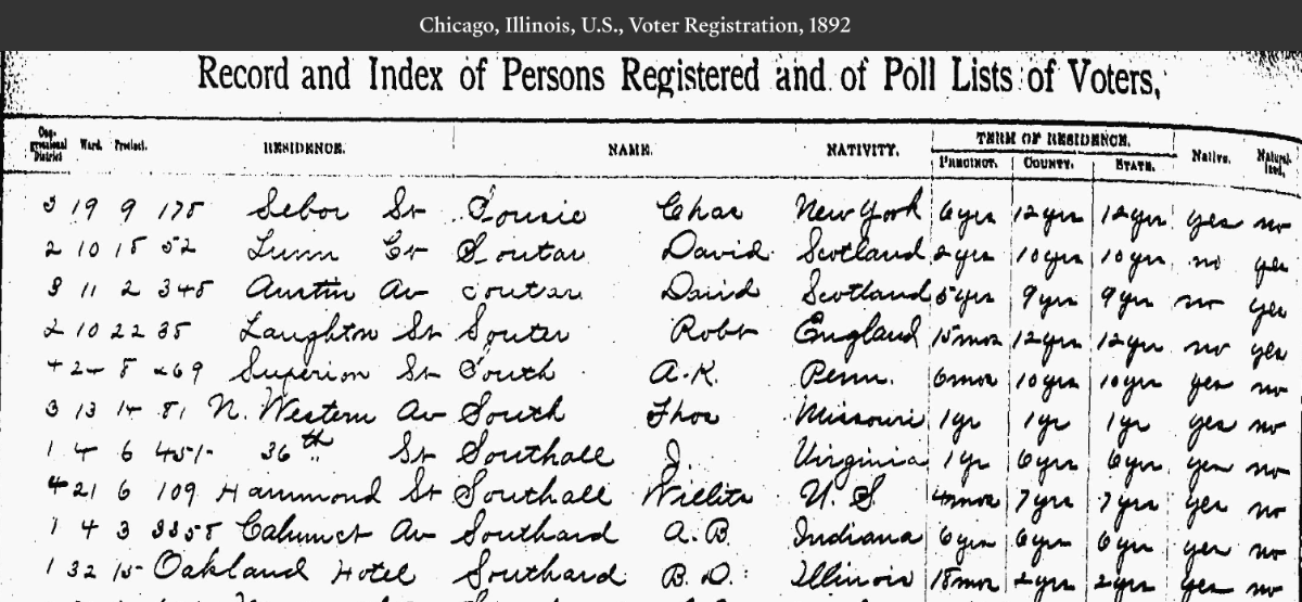

            Southard, the president, seems to have been the most active of the three in the C.E.M. Co., but he soon changed employment to the paper industry, next went east to Newton MA after turn of the century, ended up running a mill in Providence RI, and moved to the LA area before 1915, having left the field of electricity by 1896.
1540358165_1882ManchesterNHDirectory-Southard.png.dff7e0435b4bedeef8a4a6d4fbe5c7d3.png
1680206303_1890MinneapolisDirectory-Southard.png.665d051a3c44c42d901a9426dd412121.png
1851311090_1892ChicagoVoterReg.-Southard.thumb.png.7532875ae83c79c2be5ee90660163a37.png

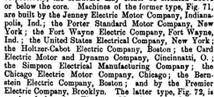

          To conclude, I guess, after the three years of fan production so nicely stitched together in Jim Kovar's image, there are no further Chicago Electric business announcements I've found, barring a single mention in an 1895 electrical directory, possibly or likely an obsolete listing by that time... Did the Company perish in the economic panic of 1893? Were they swallowed up by another local firm, or one of the giants, or simply fizzle out? I lack access to Chicago records to further the story...
            The Chicago Electric Motor Co. was substantial enough to merit attention not only from the journals of the day, but as the photo would indicate, recognition from competitors... I'm hoping someone can prove me wrong and provide further elements to the story, particularly 1894-'95........

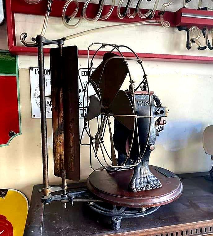

Found these photos on
Alan Willms' Facebook.
