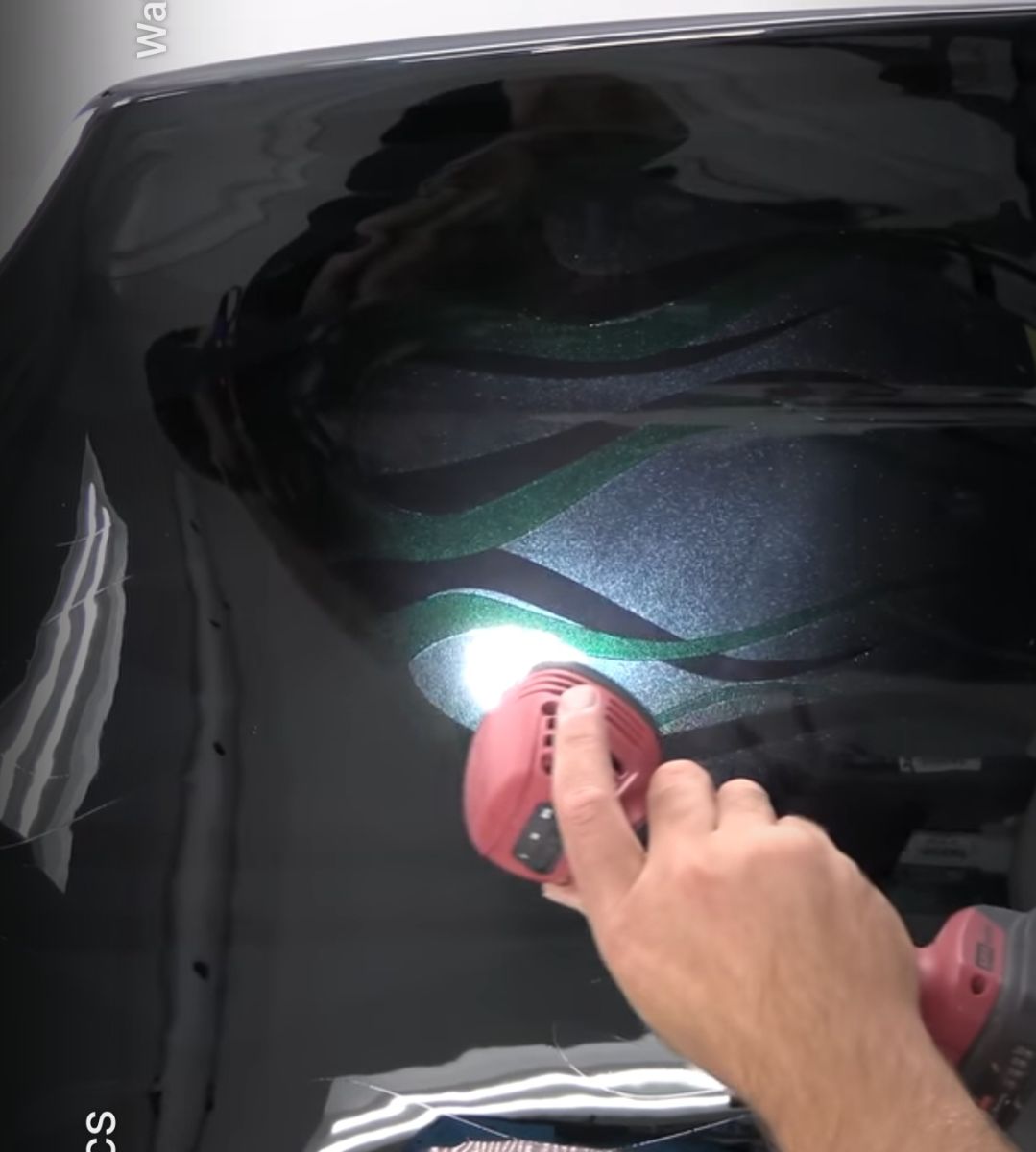

Trevor Andersen Posted March 22 Share Posted March 22 Interesting. I am going to do a fan soon with this "ghost candy" technique. Probably on a 16 inch 77xxx Emerson or one of the R&M 1920s steel tanks. Quote Link to comment Share on other sites More sharing options...
Trevor Andersen Posted March 24 Share Posted March 24 On 3/22/2023 at 10:08 PM, Chris Campbell said: Look at the youtube videos of PNP Blue etching with salt water electrolysis or an acid bath. @Trevor Andersen you can buy ghost pearl pigments and mix into inter clear. It is cheap and easier than mixing in clear top. PearlEx has a good micro pearl and Paint with Pearl sells the iridescent and interference and small handful of for color shifting as well. That pic looks more of a maco pearl whereas the ghost pearls will change color of highlights and reflections. I have been using Createx wicked colors and their line of metallics, pearls, candies etc. Im thinking something simple to start like this style paint I did on my 19666 with pinstripes or small scrollwork that only shows up in certain lighting or angles. Quote Link to comment Share on other sites More sharing options...
