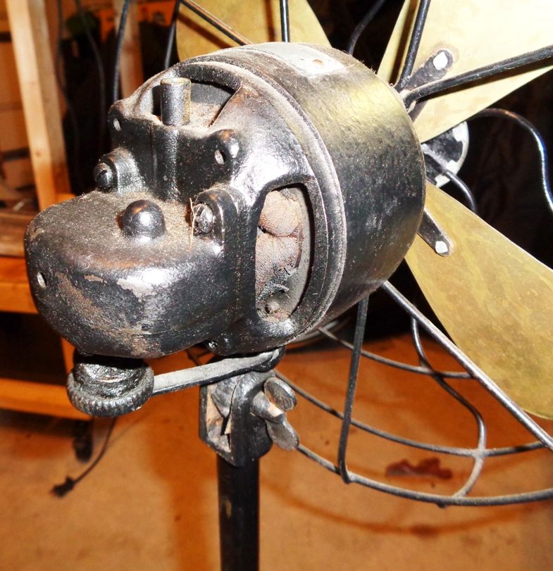

Tim Babcock Posted March 17 Share Posted March 17 Its a 3804, that all seems to be there no missing parts I can see. Runs good, oscillates good. Only thing is there is a bit of play in the bearings. Not a lot but when you grab the blade and pull it up and down there is a slight knock. You can hear it when running. I have never torn one of these down, and it will be a bit as I have a National Cash register on my bench and its bigger than I thought it would be[and much more money. LOL] But when I was looking it over I saw its stamped steel. There is a set screw for what I assume are the bearings front and back. I am hoping that the bearings can be replaced with out trying to replace the hole front and back. If so I was wondering if any one knows or has the bearings I could buy? Also when was this fan made? I am assuming in the 20s. 1 Quote Link to comment Share on other sites More sharing options...

Tim Babcock Posted March 19 Author Share Posted March 19 Is there a way to make it run quieter if I can not find replacement bearings? If not I may sell it for parts or part it out. Quote Link to comment Share on other sites More sharing options...
Paul Carmody Posted March 19 Share Posted March 19 I have not messed with the motor of an R+M yet.I have three in the later pile.I repaired 2 inoperative switches and they run fine.I had ask about the screw and someone said it was a retainer for the bearing.So I don’t have the hands on to give a definitive answer. Hopefully someone will join the discussion that has experience.It may be possible to spin the bearing around top to bottom and drill another wick hole? It could also benefit from just a cleaning,new oil,wick and spacers.Try that first. Im knee deep in a Westinghouse at the time that’s near completion or I would crack one open to see. Quote Link to comment Share on other sites More sharing options...
Tim Babcock Posted March 22 Author Share Posted March 22 I have not torn it down yet. Between finishing up the National cash register and a friends Emerson JR. I will be busy for a week or two. Thanks for the info. I was almost sure it had to be a bearing set screw. Once I take it down, I will post on the wanted and send a email to a couple of fan parts places to see if I can get new ones. I am 99% sure its worn. I don't think anything else would make it knock when I push the blade up and down Could be only one is worn. That I will not know until I tear it down. Quote Link to comment Share on other sites More sharing options...
