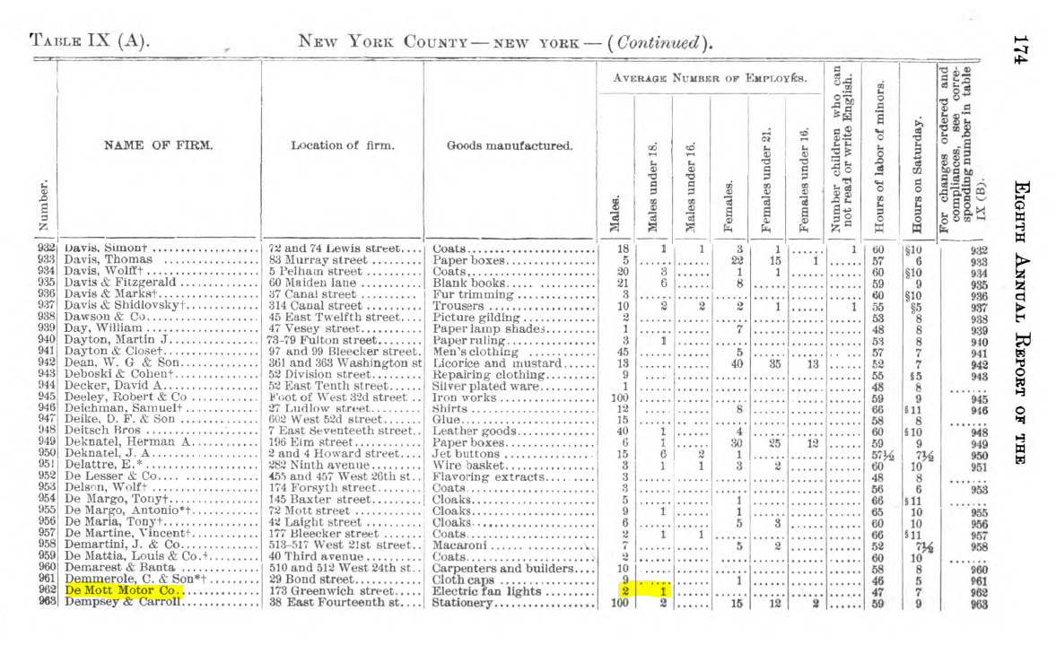

Jeff Lumsden Posted April 22, 2023 Posted April 22, 2023 (edited) On 4/20/2023 at 9:05 AM, Jeff Lumsden said: They were certainly a small affair...from the 1893 factory inspection report https://babel.hathitrust.org/cgi/pt?id=coo.31924055997708&view=1up&seq=192&q1=De Mott De Mott Motor Co not listed in the Factory inspection report taken in 1894. https://www.google.com/books/edition/_/y1c-AQAAMAAJ?hl=en&gbpv=0 Edited April 22, 2023 by Jeff Lumsden Quote

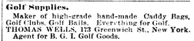

Jeff Lumsden Posted April 24, 2023 Posted April 24, 2023 On 4/21/2023 at 11:21 PM, Russ Huber said: So where were the older male and the teenager making the De Mott motors? If you Google map it, the address looks to have been across the street from from where the World Trade Center buildings were built. The factory report lists that address, so I'd assume that's where they made them. Quote
Russ Huber Posted April 24, 2023 Posted April 24, 2023 30 minutes ago, Jeff Lumsden said: The factory report lists that address, so I'd assume that's where they made them. 1 Quote
Russ Huber Posted April 24, 2023 Posted April 24, 2023 (edited) 16 hours ago, Jeff Lumsden said: If you Google map it, the address looks to have been across the street from from where the World Trade Center buildings were built. The factory report lists that address, so I'd assume that's where they made them. I learned that lesson a long time ago. You have to be really careful doing your homework distinguishing the actual factory location address as opposed to sales office address. 136 Liberty St. New York (example) was a large building loaded with manufacturer's (elsewhere) sales offices and independent agencies. In some cases, like the De Mott concern, you may or may not pin down the actual factory (shed) location. This has been a very common stumbling block on this website through the years. Agencies and electrical contractors late 19th and early 20th century were a manufacturers lifeline to get marketing foothold in various locations. Edited April 24, 2023 by Russ Huber Quote

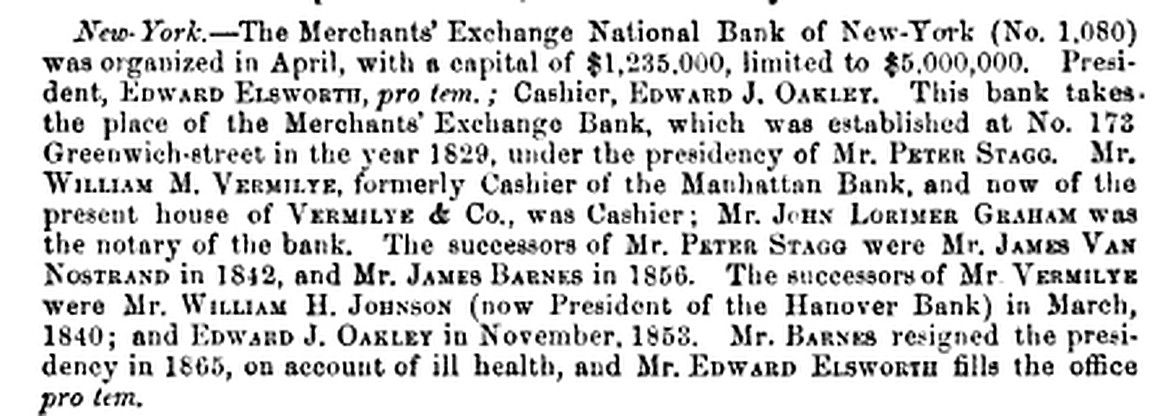

Jeff Lumsden Posted April 24, 2023 Posted April 24, 2023 (edited) 3 hours ago, Russ Huber said: I learned that lesson a long time ago. You have to be really careful doing your homework distinguishing the actual factory location address as opposed to sales office address. 136 Liberty St. New York (example) was a large building loaded with manufacturer's (elsewhere) sales offices and independent agencies. In some cases, like the De Mott concern, you may or may not pin down the actual factory (shed) location. This has been a very common stumbling block on this website through the years. Agencies and electrical contractors late 19th and early 20th century were a manufacturers lifeline to get marketing foothold in various locations. In De Mott's case, the State of New York Factory Inspection Report is listing 173 Greenwich St as the De Mott factory address. I give a little more weight to this report than, to your point, what gets listed in the trade magazines. I think the 173 Greenwich St address was both the home/sales office and the 'shed'. Also from the inspection report... Edited April 24, 2023 by Jeff Lumsden Quote
Russ Huber Posted April 25, 2023 Posted April 25, 2023 I am trying to find an image of the building at 173 Greenwich St back then. It must of been decent sized. Yes, IF.....De Mott was actually 2 people slapping those mighty mouses together, factory & sales could be sandwiched in one big room. Quote

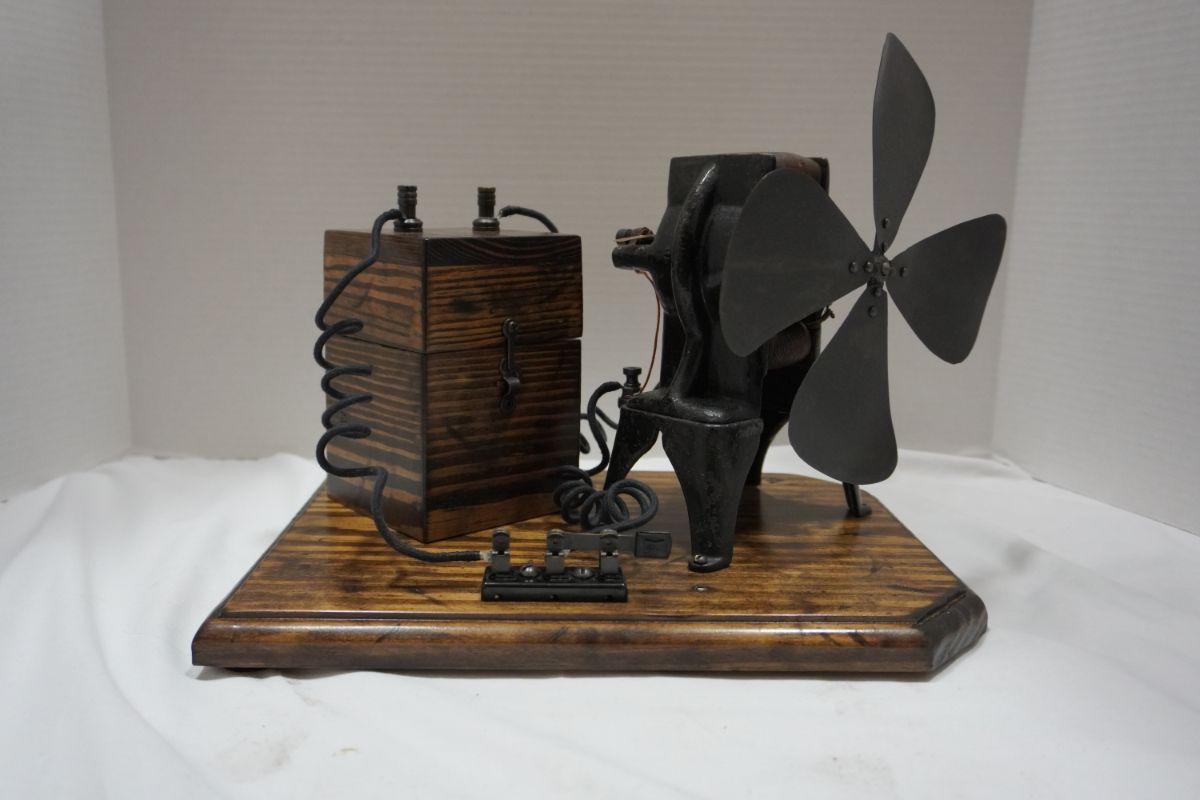

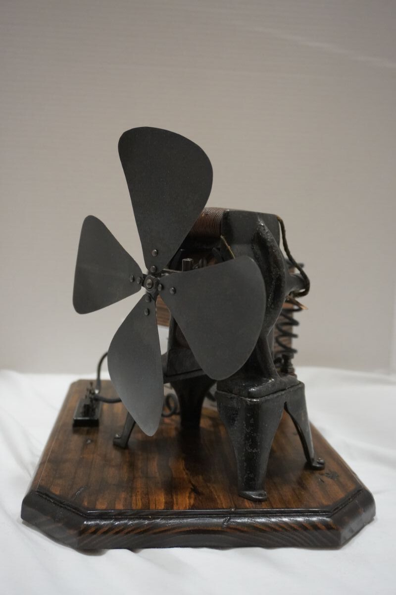

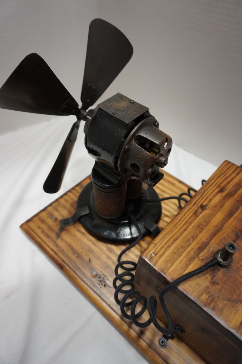

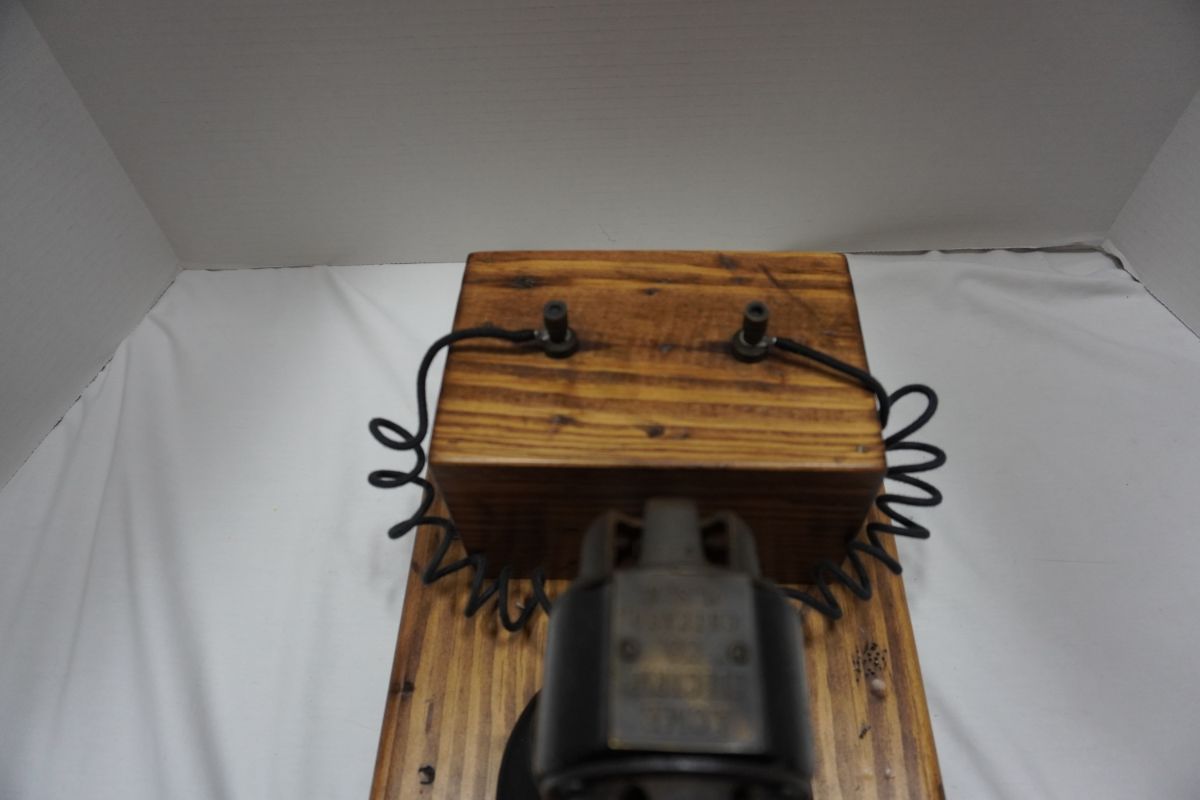

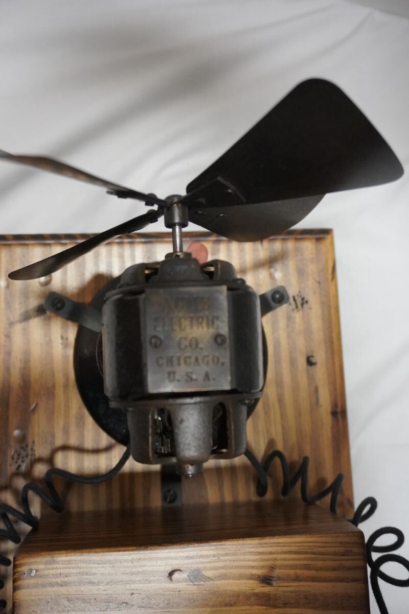

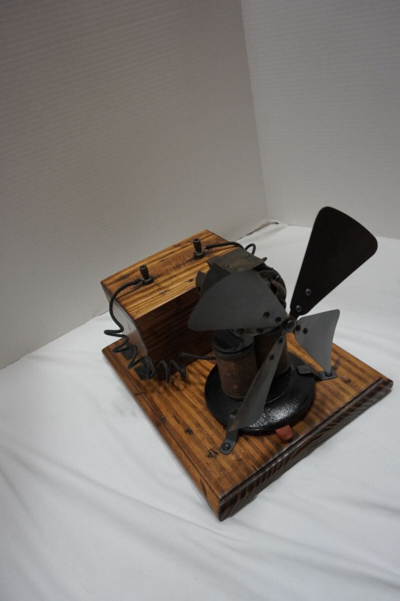

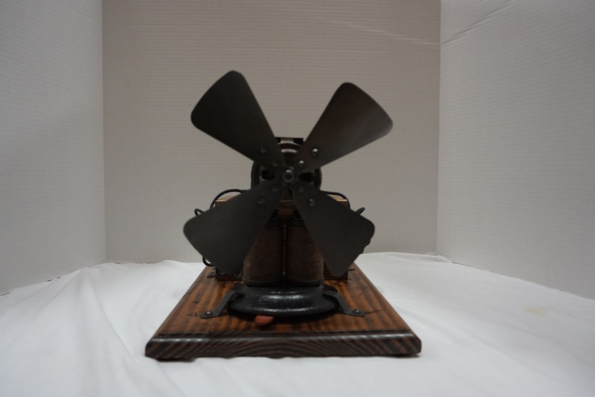

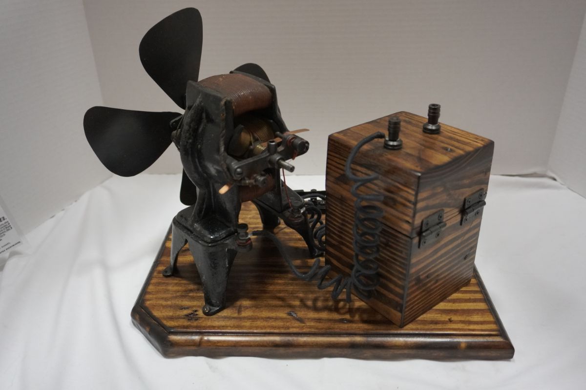

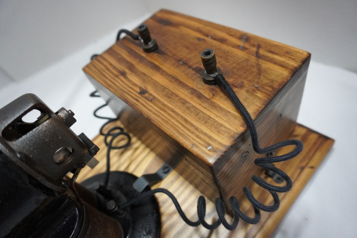

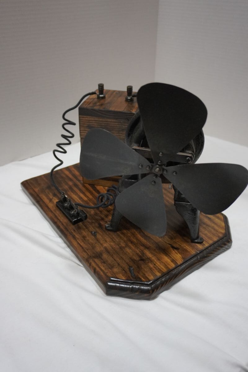

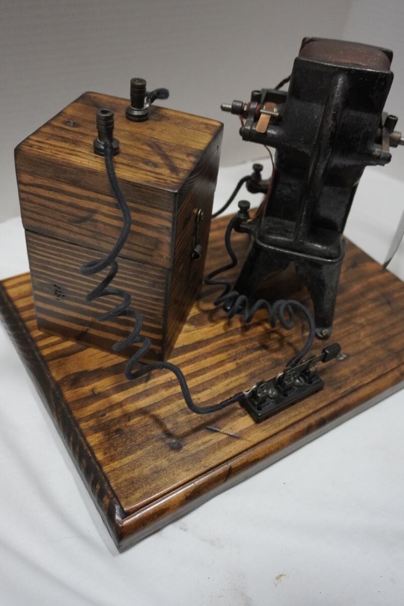

Ed Frank Posted July 24, 2023 Author Posted July 24, 2023 I did a little work on the Battery Fans Here's the ACME 4 Quote
Mel Lagarde Posted July 27, 2023 Posted July 27, 2023 Great post, Ed. Thank you for posting this for us. Not too many of these around. Great adds to your collection. Quote
