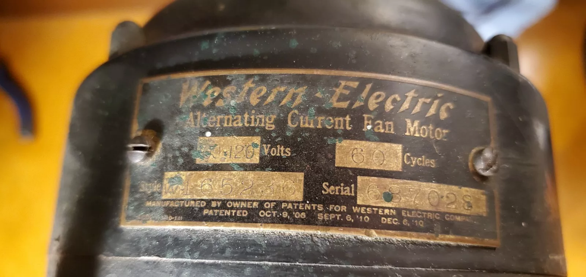

James Lawson Posted June 15, 2024 Posted June 15, 2024 I've got a couple of Western Electric branded Westinghouse fans in my collection. Both are stamped steel motors. I was wondering if Western Electric started selling the Westinghouse stamped steel fans as soon as they were introduced in 1912, as I have not seen a 1912 Western Electric catalog. One of mine is a model W165236 with a tag microdate of what appears to be 11-10-11 (month number is slightly obscured, but I'm positive the last digit is 11) and the last patent on the tag is 1910. That would likely put it as 1912 production. Does anyone have a 1912 Western Electric catalog? If so, can you look and see if this model is listed? Quote

James Lawson Posted June 18, 2024 Author Posted June 18, 2024 I called my wife last night to have her look at the fan since I'm going to be away for work for a while (she's the one who found this fan, by the way). She said the bearing caps have small dimples in them and no rivets, so it sounds like the later ones where they are attached from the inside. I have a non-oscillating Westinghouse with the rivets, so I know exactly what you're talking about. She also said it looked and felt like it has three speeds, but the only way I know of to tell for sure is to open the base and look at it. For that matter, the tank switches I've seen look like they are three speed from the outside, but as far as I know, all tanks only had two. So if it has the bearing caps fastened from the inside, would it be a '13? If it's later than that, this will be the biggest discrepancy I ever saw between a motor tag microdate and the actual date of manufacture. Quote
