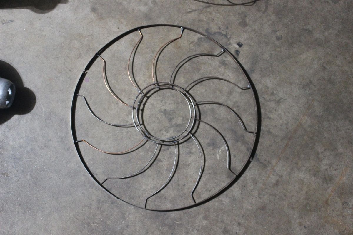

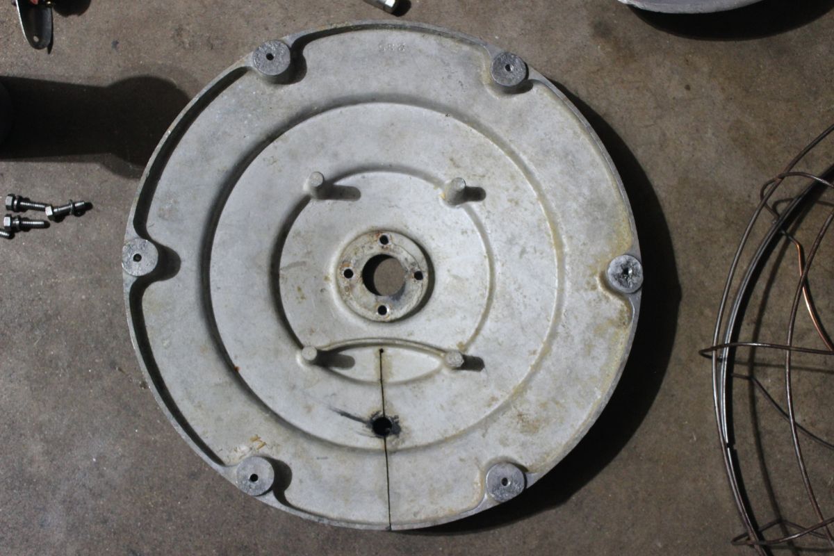

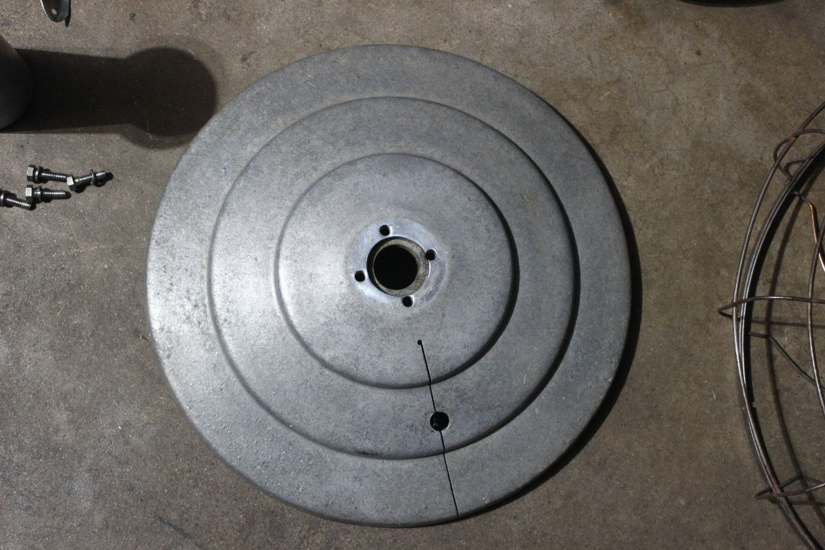

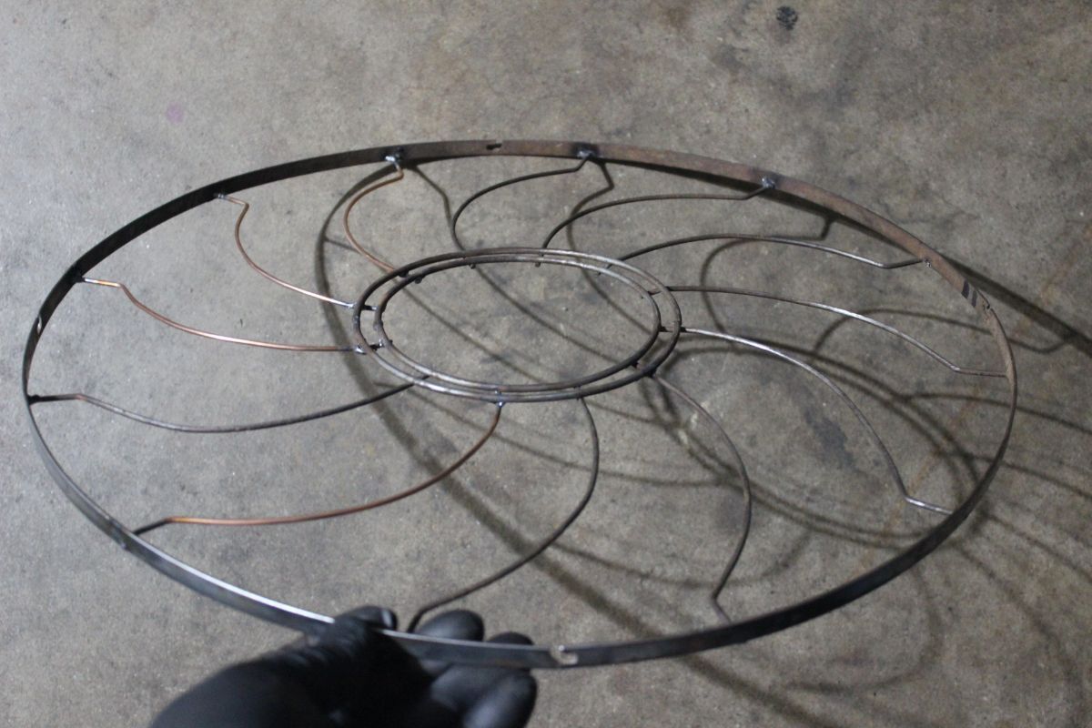

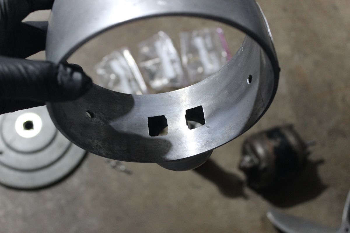

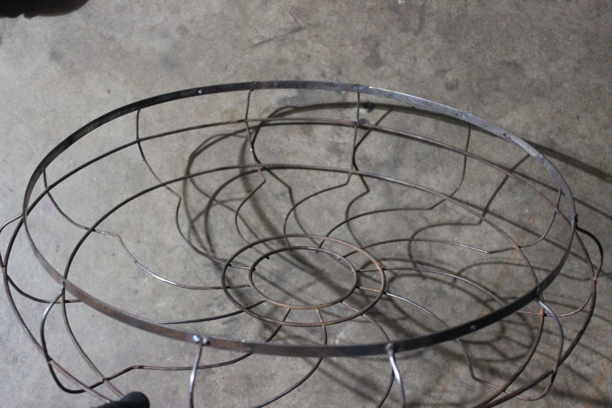

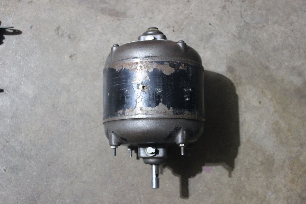

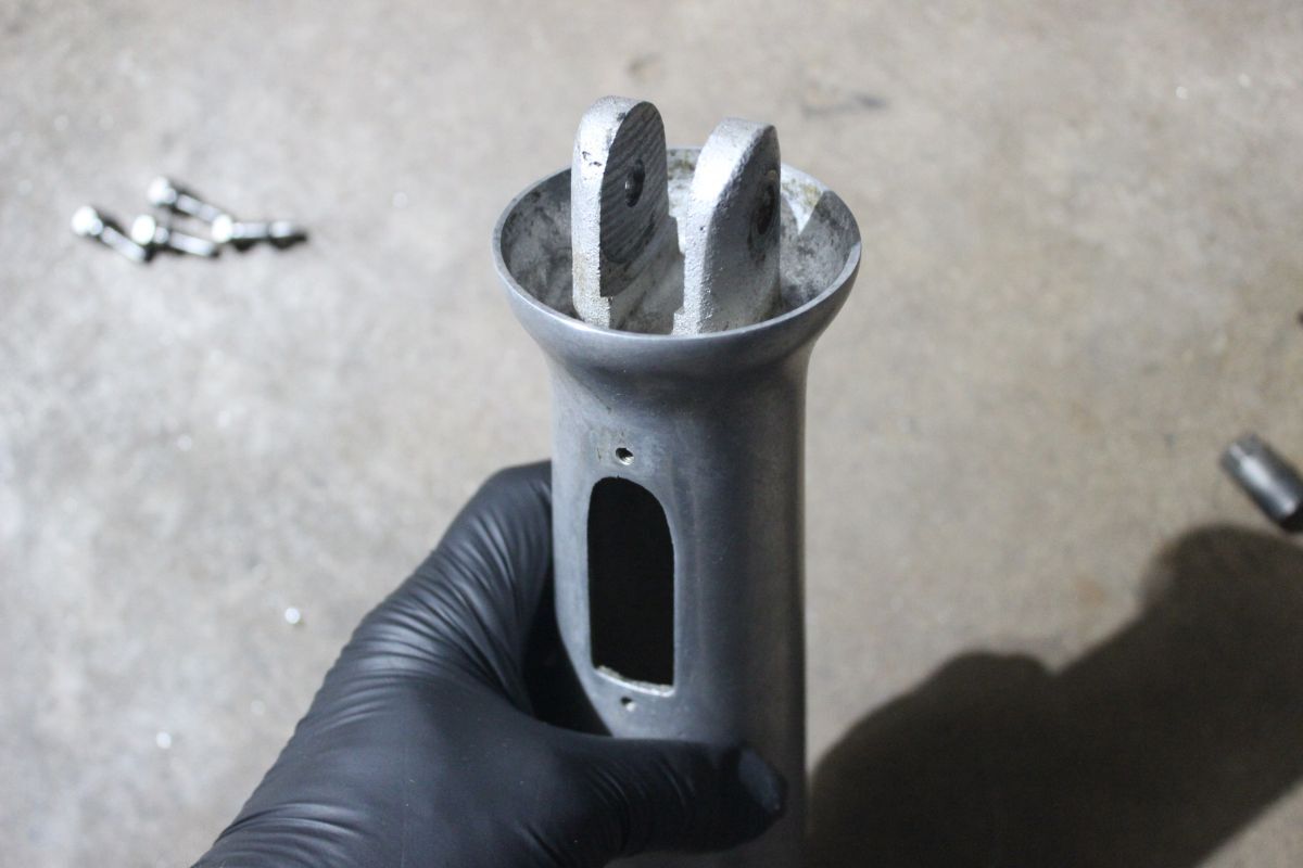

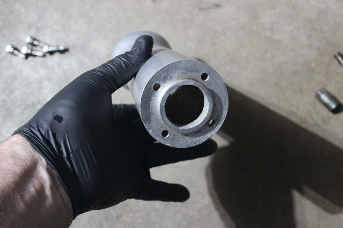

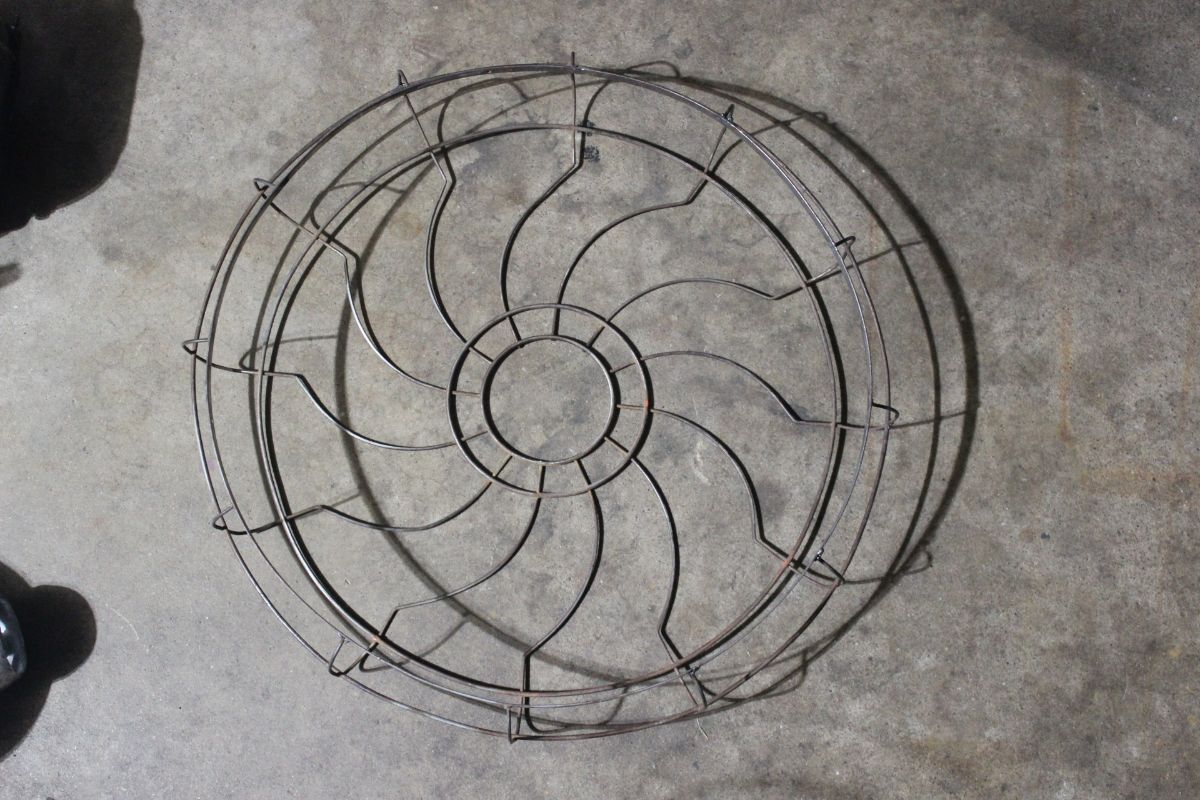

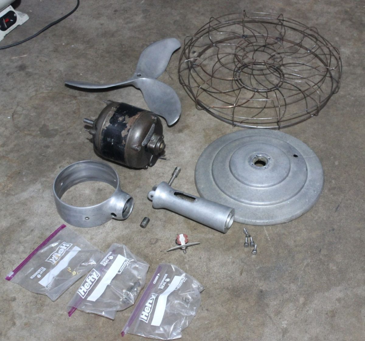

Not rocket science. The motor was stuck firm in the aluminum collar. A friend of mine and I on each side of the motor in collar with propane torches heated the aluminum collar. He with the use of heavy gloves braced the collar and I used a section of 2x4 against the motor housing and hammered it free from the collar. Guard wires were missing on the motor mount section so my friend cut and shaped correct gauge steel wires and Mig welded them in place. Getting all the original base rubber feet screws out required a propane torch with lots of heat and a pair of vice grips to slowly work them free and out. Factory base feet threading is 1/4 - 20. Steel threaded into aluminum over a number of years can be super stubborn to remove with risk of snapping off the bolt or screw. Lots of heat.
f4497b.thumb.jpg.037d3cbbf4f0da9b811a9a41e1841b9d.jpg.47254e01a5161a0a77783f03b9369e9d.jpg
wire wheel that cage and fire up the Baldor on all the other aluminum parts.  I expect to see your reflection in them by Monday!
