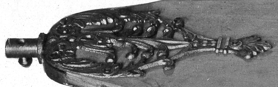

Not a Tuerk, it's something yet to be found in modern times. The blade irons looks like Western Electric, I have a set of those. That motor = unobtanium status.
I agree with Louis. Looks like Peerless irons. The motor looks like a R&M “B” and a DL Bates hooked up 😂

Agree with @Louis Weedman and @Jack Minor: from what can be seen in the photo, the blade brackets look very similar to the Peerless Type A from 1901, and subsequently used on other, concurrently-produced models from Western Electric at that time. The blade hub appears to have an integrated oil reservoir just above it that also turns, as well as a switch ball housing that looks to be of the same design as that on the Western Electric Louis XV Standard. The blade wing-tip shape mirrors the blades from both makers.
I've never fully understood the marriage between Warren Electric (which I've always believed was the originator of the "Peerless" brand) and Western Electric (which seems another wholly separate company whose production & manufacturing concerns have always been a bit murky). BUT! I digress...
Numerous manufacturers around the turn of the 20th century produced half-round, full globe or teardrop-shaped ceiling fans. Backus, Diehl, Hunter, R&M, Sprague, even Dayton. The motor in this photo is unlike any from the the previously mentioned producers. A very, very gilt, ornate motor basket, which seems like it's made of two relatively rounded halves joined at the middle. I wouldn't be surprised if both top and bottom covers were solid cast brass: they look just as ornate and detailed as the solid brass top and bottom covers on the big WE Standard, which is incredibly intricate for a casting.
I'd peg this fan (based on its design) as earlier than the XV Standard. And judging by the shape and ornamentation of the basket, it's possibly earlier than the Peerless A.
I have no definite idea of what it is, only guesses. Super, SUPER find.
EDIT: I keep staring at it. I see some tell-tale signs (beyond the obvious brackets, hub and blade shape) that look slightly familiar.
I'm going to go out on a limb and ID this as a Western Electric, model unknown. It's gilded in just the right way that matches some of their earliest fans. Though I've never been aware of any globe-shaped Western Electrics, maybe Eric found the first one.

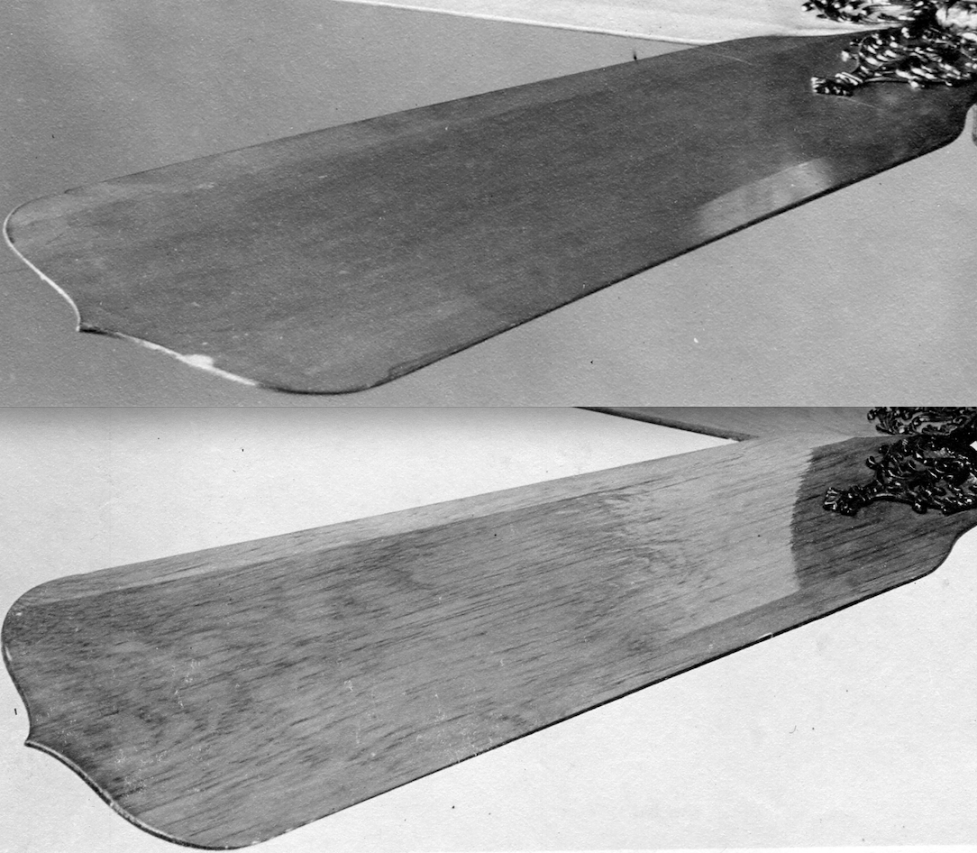

                     Western Electric blade (1901) above Sprague blade (1902), identical irons...
                                                                             1907
