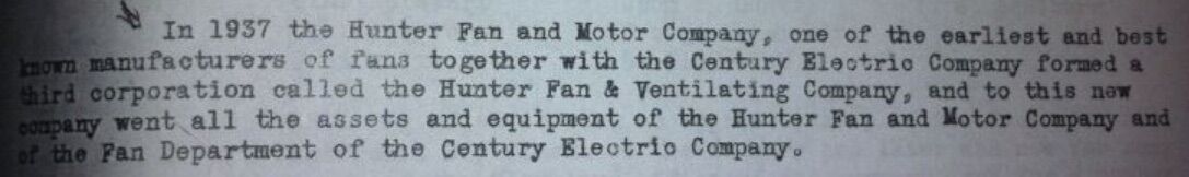

Steve Rockwell Posted November 4, 2024 Posted November 4, 2024 This clip, I have it listed as being credited to Brad Chaney..... Quote

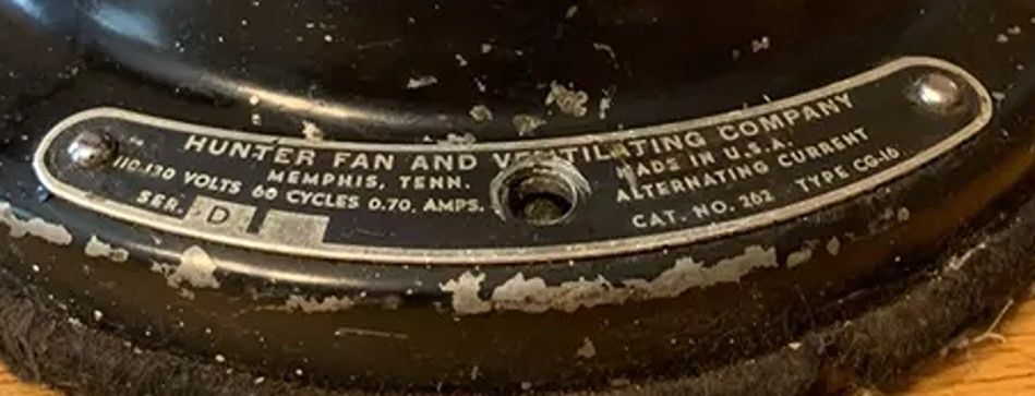

Russ Huber Posted November 4, 2024 Posted November 4, 2024 "Manufacture Date for Hunter Century" No Century name on a Memphis, TN. address tag, Robert. 🙂 Quote
Robert Todd Posted November 4, 2024 Author Posted November 4, 2024 Thanks, guys. I appreciate your input. Hey, Russ. The tag you have posted looks just like mine except mine is a Ser. E. Quote
