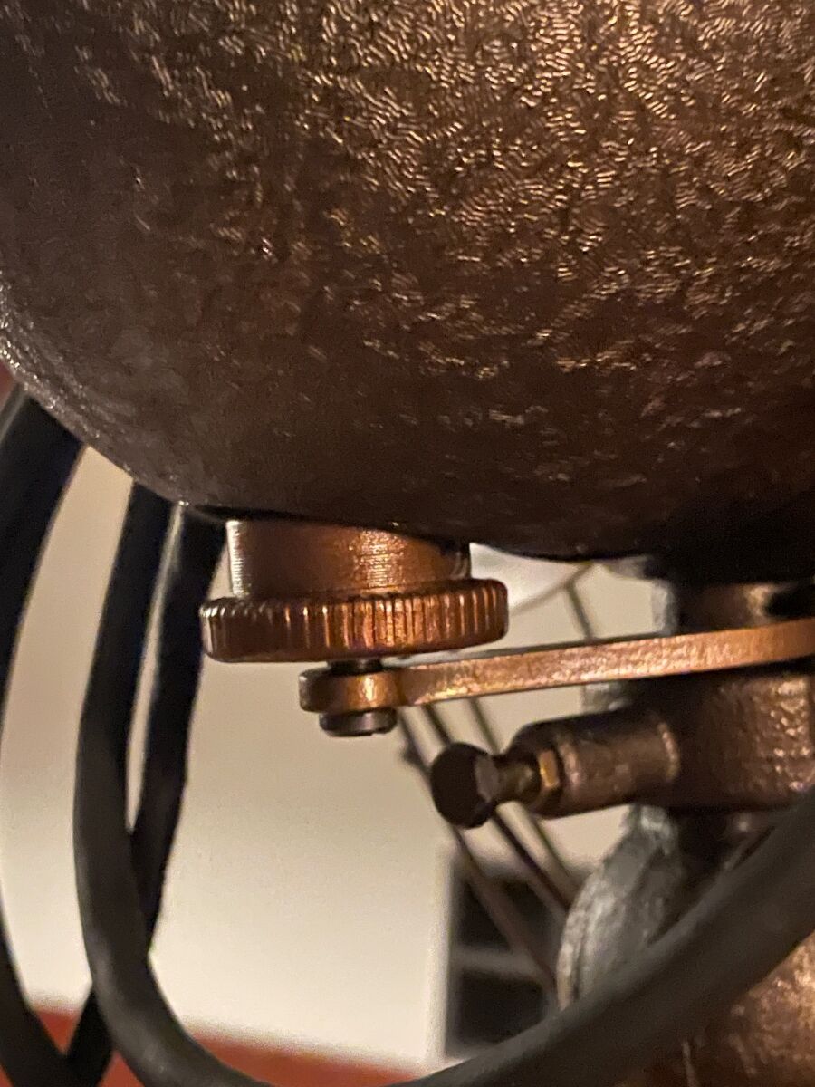

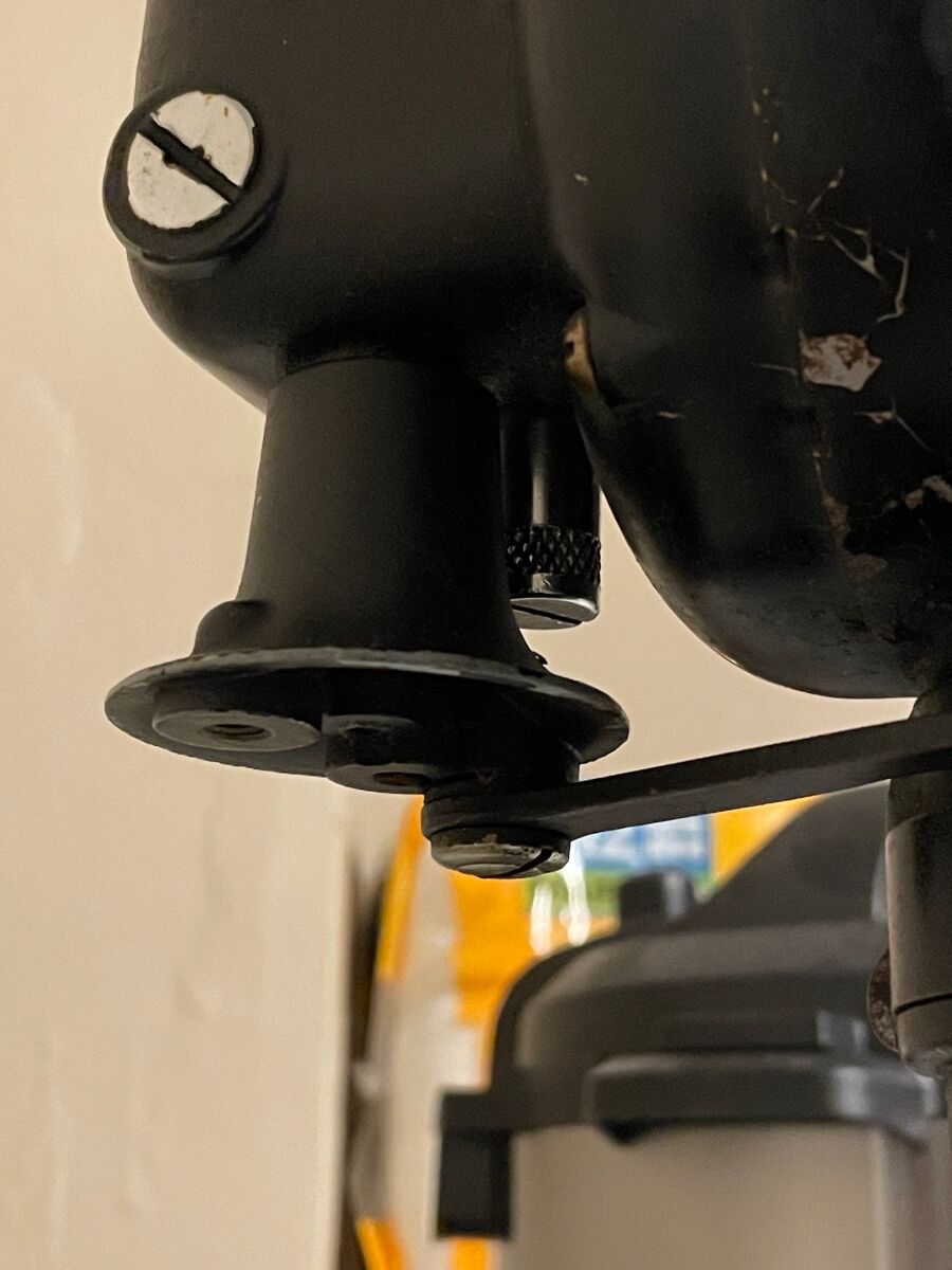

    Fwiw on Emersons of this era (and earlier) it’s more commonly referred to as a wheel not bell. “Oscillating wheel”, “ratchet wheel” etc. Many GE have a bell shaped wheel so it’s more common to call them bells. But neither is necessarily wrong.
  First photo GE vorty, second photo 77648AN
