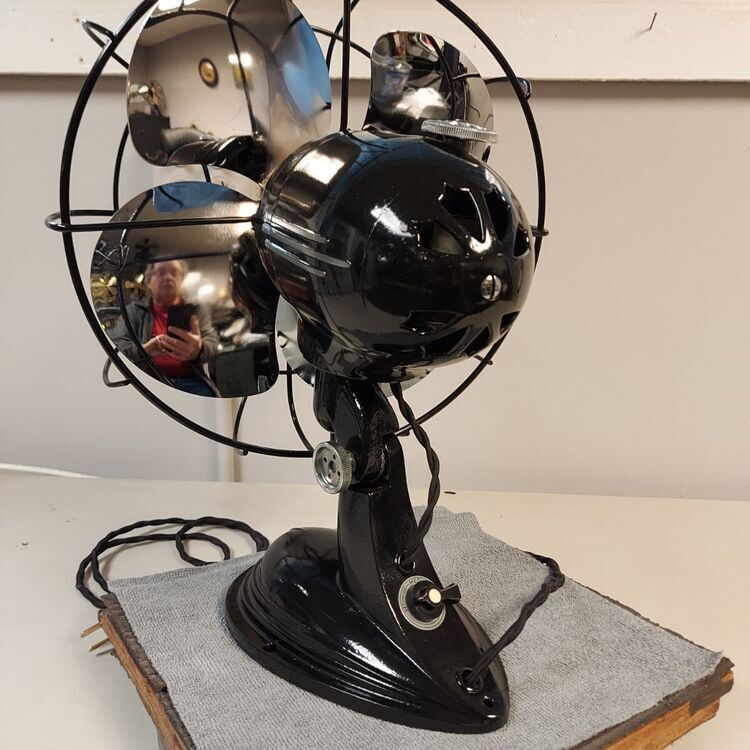

I finally finished restoring the Arctic Aire. I took the blade in to be chrome plated that took a month to get it back. I powder coated the motor housing, cage and base. It runs and oscillates smoothly on three distinct speeds. Tony Clayton made me the wire for it. Circa is late 30's- early 40's. Model # is unknown.

Nice job, Vic. Those fans are built, and then some. 🙂
Looks amazing 👏 Vic! That blade was worth the wait.
