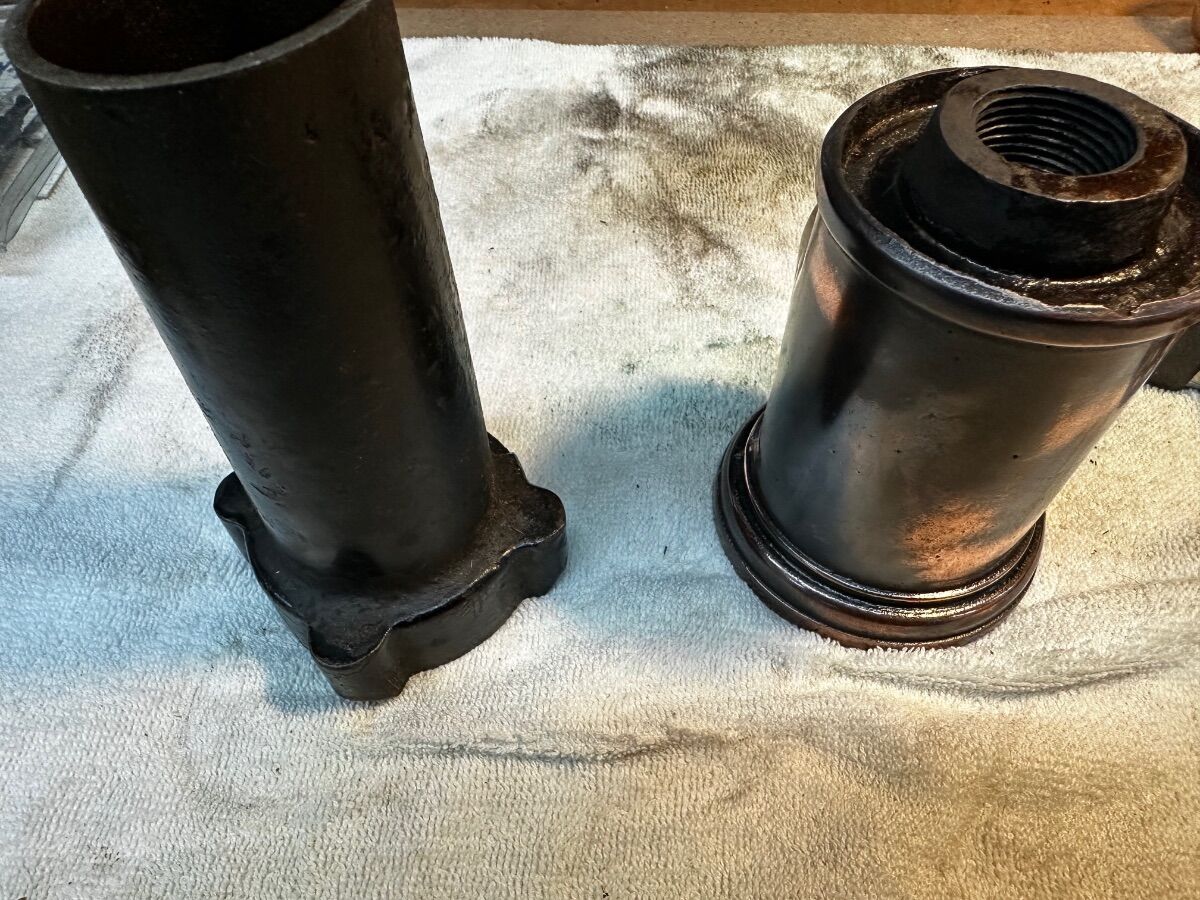

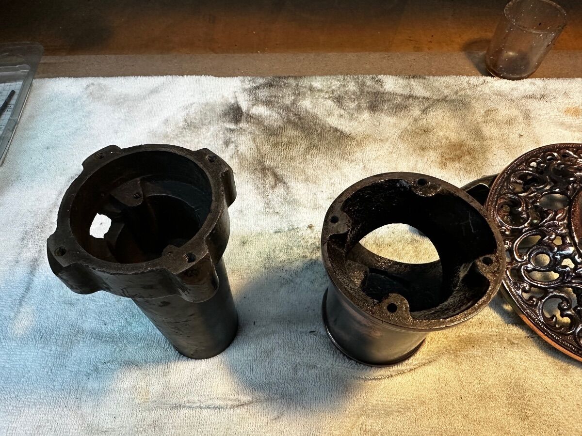

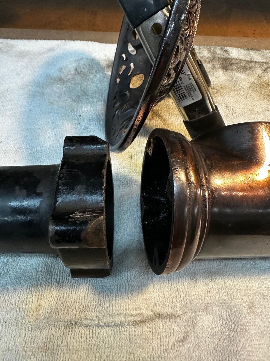

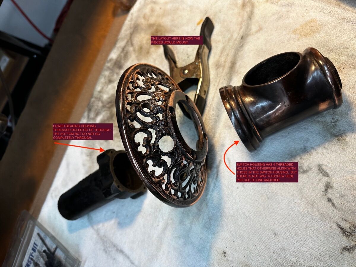

I am in the process of (slowly) restoring two Westinghouse Deluxe ceiling fans.  One is an original counter mount and the other will be a column mount.  They were in pieces when purchased.  My challenge is figuring out how the lower bearing housing attaches to the switch housing.  A decorative piece is supposed to be mounted between the two pieces previously mentioned.  However, both the lower bearing housing and the switch housing have holes with female threads.  It would be impossible to connect these two pieces together, especially since the threaded holes do not go all the way through either the bearing housing or the switch housing.  I realize I have probably completely failed to describe the problem in an understandable way.  Hopefully the photos will do a better job.

Sure, Geoff.  I described having two fans that are being worked on.  One is an original counter mount.  The other started life as a ceiling hung fan, but I have the parts to make a column fan.  One of the bearing housing pieces had what appeared to be enlarged holes.  I assumed these holes were drilled to address the same problem as I was dealing with.  It seemed to be a pretty hack fix, as the holes were considerably larger than what would work for the 10/32 machines screws.  There were also some sort of fabricated spacers that looked to be an attempt to compensate for the overly large holes.  I assumed both bearing housings were intended to be identical, but the second piece did not have holes all the way through as would be needed for the column mount.  As I pondered this I began to think that maybe the hack-fix holes were original.  Maybe someone enlarged them along the way and then realized they now need a spacer.  Nevertheless, I am now convinced that the column mount switch housings have mounting holes that penetrate all the way through the part and the ceiling hung switch housings do not.  So I drilled out the other switch housing.  This was always an option, but I didn't want to alter an original part.  But I think I'm good with modifications that make the ceiling hung piece into a column mount piece.  At least that's what I choose to believe.
In summary: Operator error.
