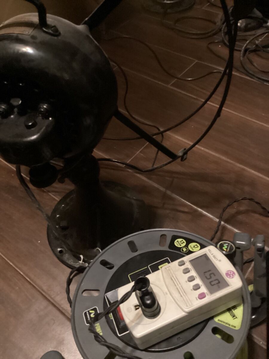

Paul Carmody Posted February 18 Posted February 18 (edited) On 2/16/2025 at 3:17 PM, Marc Sova said: On I terstonb bait the paint concern. Yeah….as a professional painter/decorator, I know silicone caulk is the bane of our existence lol Fwiw….so do collectors just not run the older stuff unless they’re on a variac? This 21648….the couple times I’ve rolled the variac up from 110 to 120v it’s pulling like 120 watts (110 on the motor tag) and 1.8-1.9 amps. At 110v it’s right at 100 watts and 1.65 amps. I sleep with mine running.I really don't have any fans in running order with amps that high.The most out of a 16" has been around 1.25 amps.at around 124v I'm sure less if dropped them back to 110v.I don't think I have one exactly like your model so I can't say on that.The ones I slowed down I just use a triac fan speed controller wired in line set on 110v.The 12"fans I run regular I just run on house current in low.They are Westinghouse.A tank and a centrifugal 6 blade.They run cool as a cucumber 🥒 Edited February 18 by Paul Carmody 1 Quote

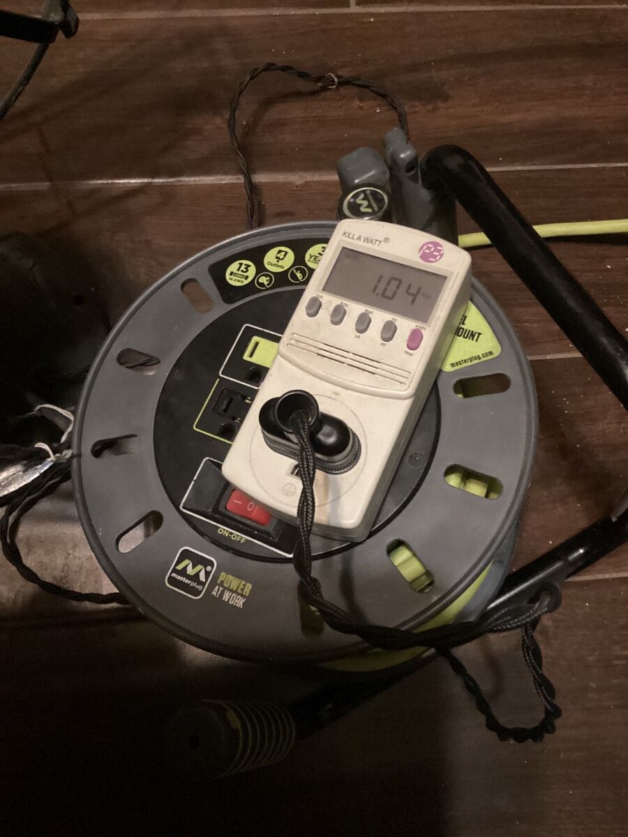

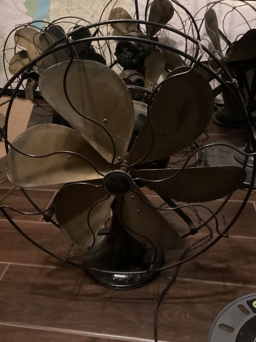

Paul Carmody Posted February 18 Posted February 18 (edited) So out of curiosity I pulled out this big motor 16' Emerson to see the amps.I haven't done anything to this fan its raw.The 1.04 amps is low and 1.50 high.As it warms up the Amps are getting lower. The watts low 65.3 mid 74.9 w high 104w .122v .Guess I should have said the highest Amp on a 16" Westinghouse before. Edited February 19 by Paul Carmody Quote
Marc Sova Posted February 18 Author Posted February 18 4 hours ago, Paul Carmody said: So out of curiosity I pulled out this big motor 16' Emerson to see the amps.I haven't done anything to this fan its raw.The 1.04 amps is low and 1.50 high.As it warms up the Amps are getting lower. The watts low 65.3 mid 74.9 w high 104w .122v .Guess I should have said the highest Amp on a 16" Westinghouse before. I So the 1.5a on high on the Emerson…,at what voltage? When temporarily wired in the switch form a 19648, on 110v on high I got 1.54 and 103-104 watts well below the 110w on the motor tag. Yeah I’m def not gonna run this on straight 120 line voltage….th couple times I’ve don’t that for about a minute the amps were too high for comfort. (1.9ish and watts were like 121 or 125!) Quote
Marc Sova Posted February 19 Author Posted February 19 7 hours ago, Paul Carmody said: It was at 122v. Oh….just noticing the fan. It’s a big six wing. 29668 or 73668???? Even though a big motor, it is six pole versus four pole for the 21648. So they run a bit slower and less amps. My 29668 runs at about 1.5 in 120v. So…not really a a just comparison as I learned from mark olson’s comment on my post about it which I’ll link below. Circling back to the grease though….in my comment above with the YouTube video you can see I didn’t notice much difference at all with the gearbox removed. But…I do notice a slight increase in amps (from like 1.65 to 1.68 or 1.69) and watts (from 110 to about 113) when oscillating obviously a more load translates to more amp/watts. I may still try swapping the grease and see if there’s a difference but probably won’t Quote

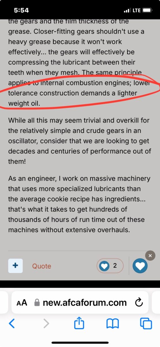

Nicholas Denney Posted February 24 Posted February 24 The goal of gear lubrication is to keep the contact surfaces lubricated, while at the same time minimizing fluid resistance... this means not clogging a gearbox with sticky grease. If you are using a sticky grease, only use enough to coat the gear teeth. More than that is too much. If you're using a non-clinging grease, fill the gearbox to the lower surface of the gears. You also have to consider the tolerance of the gears and the film thickness of the grease. Closer-fitting gears shouldn't use a heavy grease because it won't work effectively... the gears will effectively be compressing the lubricant between their teeth when they mesh. The same principle applies to internal combustion engines; lower tolerance construction demands a lighter weight oil. While all this may seem trivial and overkill for the relatively simple and crude gears in an oscillator, consider that we are looking to get decades and centuries of performance out of them! As an engineer, I work on massive machinery that uses more specialized lubricants than the average cookie recipe has ingredients... that's what it takes to get hundreds of thousands of hours of run time out of these machines without extensive overhauls. 2 Quote
Marc Sova Posted February 25 Author Posted February 25 17 hours ago, Nicholas Denney said: The goal of gear lubrication is to keep the contact surfaces lubricated, while at the same time minimizing fluid resistance... this means not clogging a gearbox with sticky grease. If you are using a sticky grease, only use enough to coat the gear teeth. More than that is too much. If you're using a non-clinging grease, fill the gearbox to the lower surface of the gears. You also have to consider the tolerance of the gears and the film thickness of the grease. Closer-fitting gears shouldn't use a heavy grease because it won't work effectively... the gears will effectively be compressing the lubricant between their teeth when they mesh. The same principle applies to internal combustion engines; lower tolerance construction demands a lighter weight oil. While all this may seem trivial and overkill for the relatively simple and crude gears in an oscillator, consider that we are looking to get decades and centuries of performance out of them! As an engineer, I work on massive machinery that uses more specialized lubricants than the average cookie recipe has ingredients... that's what it takes to get hundreds of thousands of hours of run time out of these machines without extensive overhauls. Great explanation. Thank you. Did you mean to say lower tolerance construction requires a heavier weight oil? Quote
Todd Adornato Posted February 25 Posted February 25 2 hours ago, Marc Sova said: Great explanation. Thank you. Did you mean to say lower tolerance construction requires a heavier weight oil? Lower tolerance means a tighter fit, so lighter weight lubricants are the order of the day. 1 Quote
