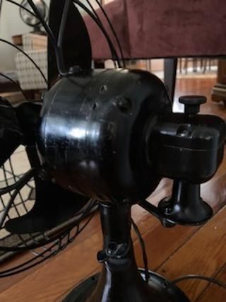

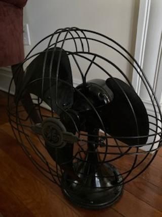

Sorry. I could have been more specific. It's a 1951 16 inch. Here are pictures of the front and back.
I see what may be cracks in the rear bearing block @ 11:00 o'clock and 9:00 o'clock.
At least compared to my 16” from around this time period, it appears to be mold lines from the casting of the bearing/gearbox assembly. I wouldn’t be too worried

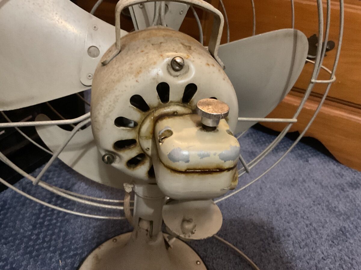

Just last evening I was servicing my oldest 12-inch Vortalex which I inherited in 1979 from my grandfather. This one is a frequent runner in my living room. Although the fan seems to run great, the spin-down time does not seem to be as long as the other 12-inch Vortalex fans I own. There also seems to be a disparity among Vortalex fans on weather they have a rear oil cup or not. This one does not. (Also notice it is a sealed motor - probably built to Coast Guard standards. My grandfather got it from the shipyard where he worked for many years. My dad - who also worked there - speculated it may have come off a ship.)
This topic made me look around - the black and aluminum 12-inch (and 16-inch) Vortalex have both front and rear oil cups. The brown and tan 12-inch does not. The 12-inch "blue" model with the circular guard - similar to the model David D posted here also does not. Is different grease recommended depending on whether the fan has a rear oil cup or not?

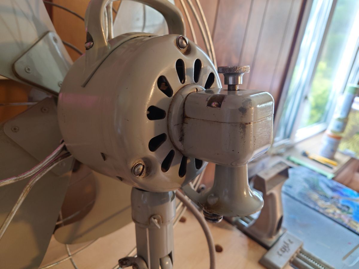

I think it was time frame….earlier ones had it. Later ones did not. I’ve been using red and tacky but I’m moving away from that in favor of regular wheel bearing grease (like from Napa) as Stan suggests. I think the red and tacky is TOO tacky to the point of almost having resistance, certainly so if you use too much. And as Stan said, the regular grease, though it won’t break down like the old grease would’ve, at least has some hope of breaking down and living the rear bearing. So…I def would use it in a vorty quit a rear oil cup. Here’s one of my “with handle” polished blade vorty with cup. (I think the early handle versions still had the rear cup)  IMG_6969.thumb.jpeg.a93855c82998d2c5806079071b22294a.jpeg
