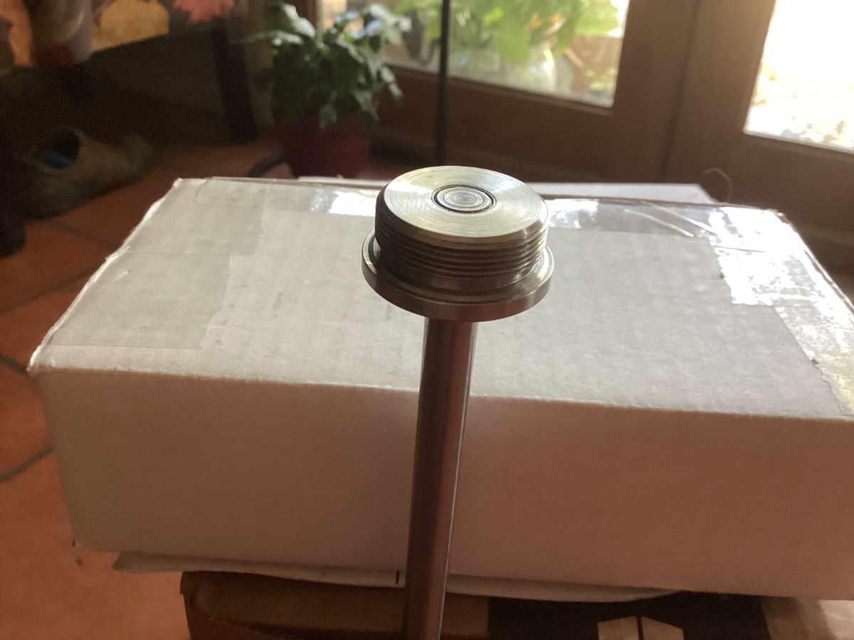

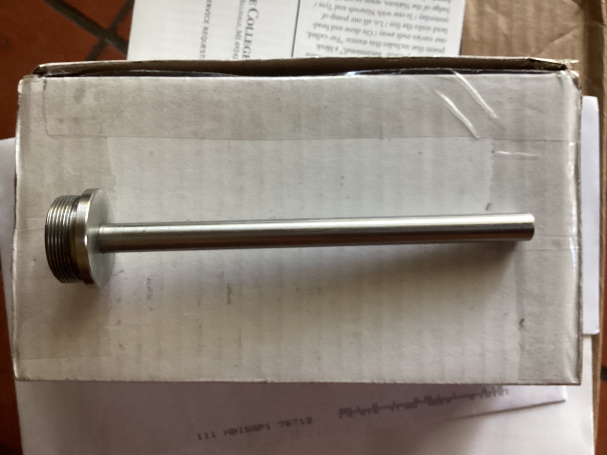

Paul Carmody Posted September 5 Author Share Posted September 5 Look at this beauty! I’m like a kid At Christmas and can’t wait to try it out! 2 Quote Link to comment Share on other sites More sharing options...
