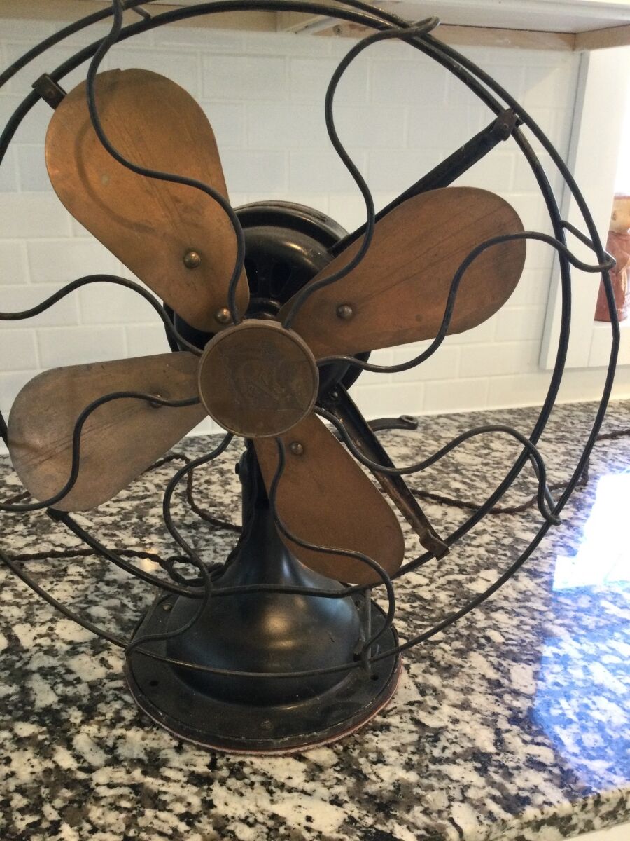

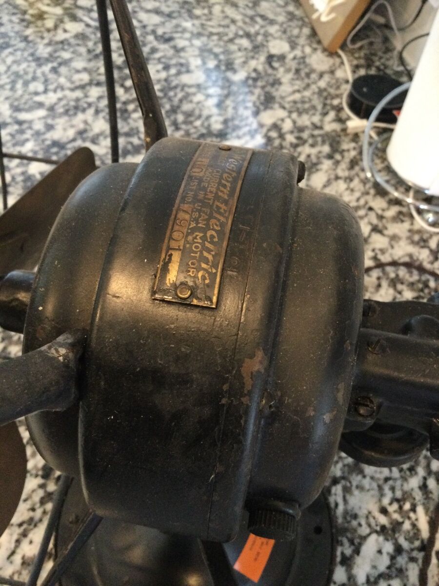

Anthony Lindsey Posted August 30, 2023 Posted August 30, 2023 It's a Direct Current fan. It gets hottest on low but less on medium and none on high. Quote
James Byerly Posted August 30, 2023 Author Posted August 30, 2023 Thanks Anthony ! Just not use to a fan component getting so hot . Quote
Anthony Lindsey Posted August 30, 2023 Posted August 30, 2023 On low the switch generates heat from the power it's restricting from going to the motor. Less on medium and none on high. There's a better way to explain that probably. Quote
Anthony Lindsey Posted August 30, 2023 Posted August 30, 2023 Are you running that on standard AC power? Quote
James Byerly Posted August 30, 2023 Author Posted August 30, 2023 Right ! I’m on 120 volts A/C . Quote
Russ Huber Posted August 30, 2023 Posted August 30, 2023 10 minutes ago, James Byerly said: Right ! I’m on 120 volts A/C . That's a no no. You need as full wave bridge rectifier to convert AC to DC in route to your switch? Anthony will help you with his big brain. Quote
Anthony Lindsey Posted August 30, 2023 Posted August 30, 2023 Well, your not supposed to. Some fans will run and some don't Send me your address and I will send you a small bridge rectifier "extension cord" to plug the fan into. 1 Quote
Anthony Lindsey Posted August 30, 2023 Posted August 30, 2023 BIg brain? I know there is a joke in there somewhere. Quote
James Byerly Posted August 30, 2023 Author Posted August 30, 2023 Thanks Guys ! Hey Anthony ,Just let me know the price of the cord and I can pay you for it. My address: 700 west 74th street Kansas City, Mo 64114. Thank-you. Quote
Anthony Lindsey Posted August 30, 2023 Posted August 30, 2023 No worries don't worry about it. Plug fan into it and it into wall. Quote
James Byerly Posted August 30, 2023 Author Posted August 30, 2023 Thank you Anthony ! I really appreciate it ! Quote

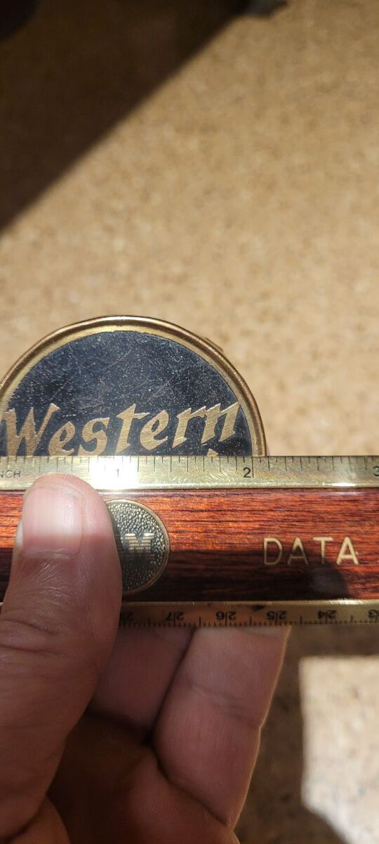

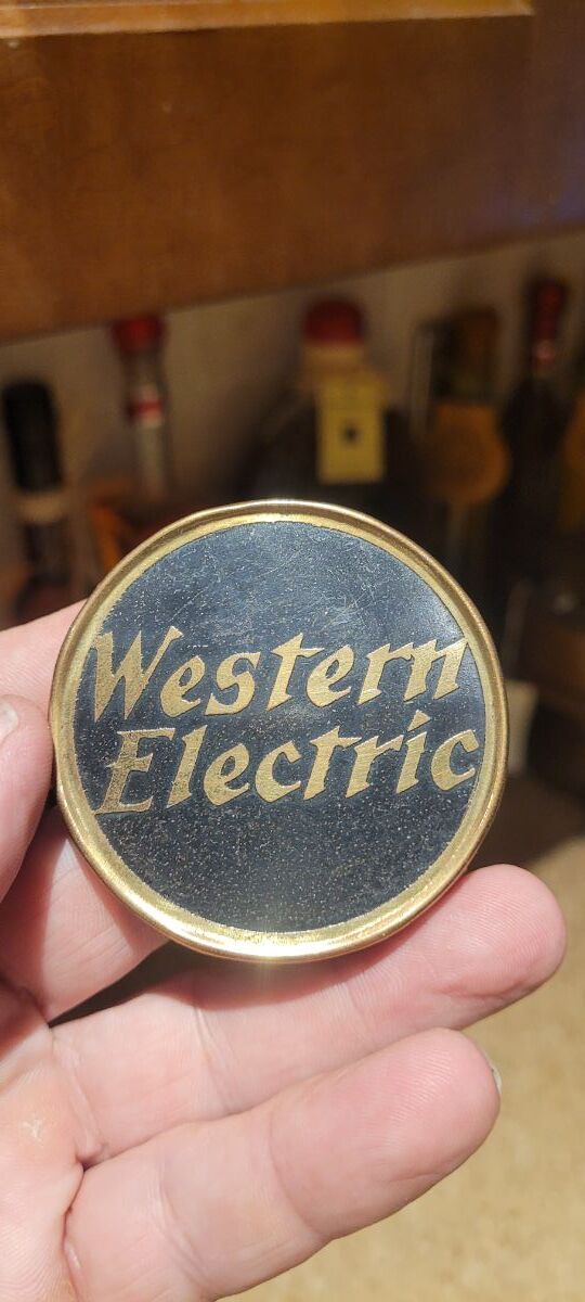

James Byerly Posted September 1, 2023 Author Posted September 1, 2023 Its got a R&M badge on fan guard and western Electric name on motor tag . Would that have been original to this fan . Thanks Quote
Anthony Lindsey Posted September 4, 2023 Posted September 4, 2023 It should have an Western Electric badge. I have a nice one if your interested. 2 1/8" wide. Quote
Steven P Dempsey Posted September 6, 2023 Posted September 6, 2023 Those fans were meant to be run on 110 volts, I use a VARIAC at 90 volts or less Quote
