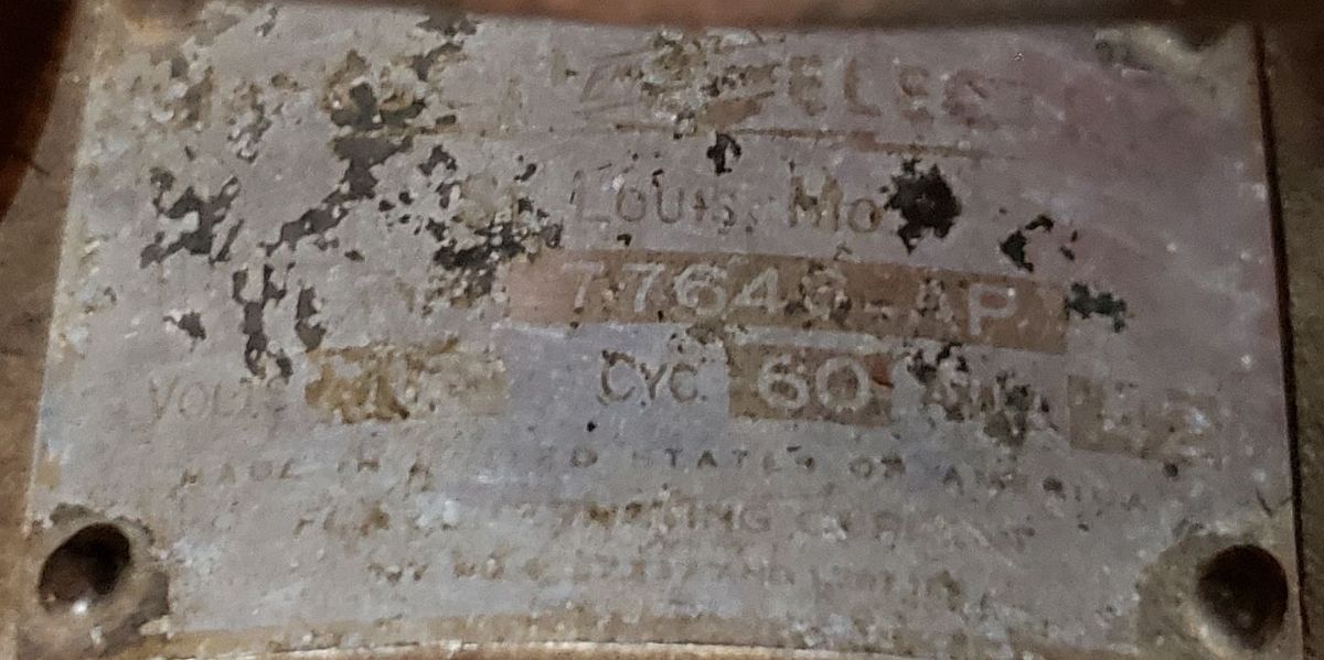

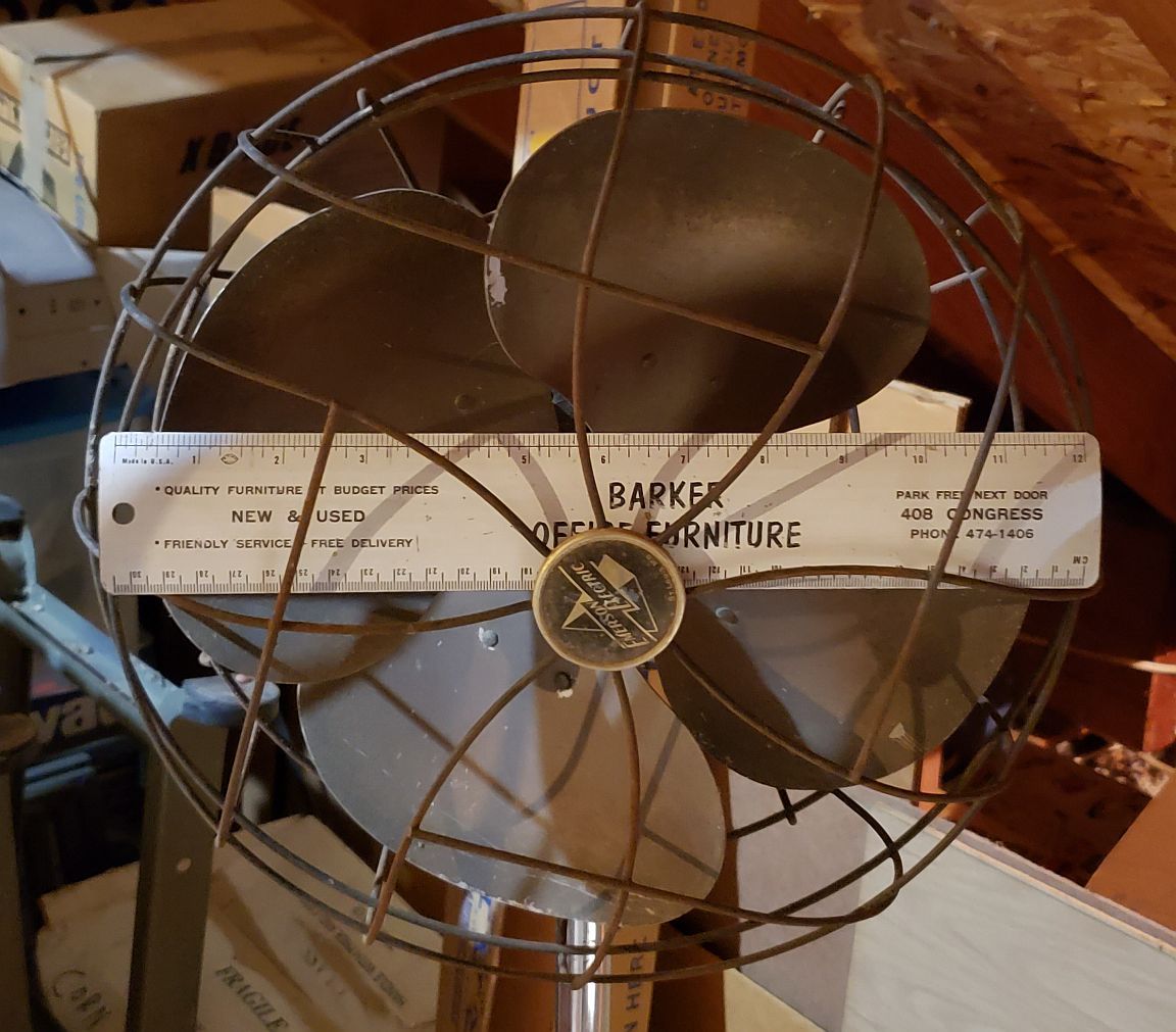

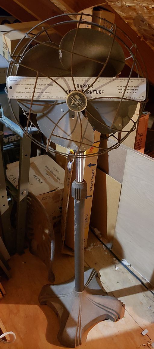

Dennis Long Posted September 4 Author Share Posted September 4 (edited) On 9/1/2023 at 11:55 AM, Stan Adams said: Dennis, you said Emerson pedestal. Is it a K60 & if so, what size? Stan, this fan's data plate is a bit messed up (see picture below). The data plate seems to say 77648-AP, even though I was expecting to see 77646 since, as you can see in my picture below, it's a 12" fan. It's a bullet back with the krinkle paint. The cord was cut, but I hooked it up and all 3 speeds work, once I push-started the fan with my "test" capacitor. I'm a little confused that the fan is a 12", since the data plate seems to say 77648 and it has the larger capacitor. I had the thought that maybe the fan was a 77648 originally, but the blade and cage were replaced with 12" blades and cage? Are those interchangeable? Brandon has one of these at his house 30 minutes away, but he's out of town. I will be going to his house later this week to do something for him, so I plan to remove the bottom plate and check his capacitor specs since his works perfect. I was planning to buy whatever his fan uses, but what if my motor was a 77648? He also has a 77648 pedestal, so I might check that one too. Edited September 4 by Dennis Long Added pictures Quote Link to comment Share on other sites More sharing options...

Stan Adams Posted September 5 Share Posted September 5 Well Dennis this is a strange character. Yes that model number is a 16" motor, leads me to believe it got kicked over & someone put a different blade & cage on it. That cap still has me scratching my head though. A 77648 normally takes a 2.5 MFD. Quote Link to comment Share on other sites More sharing options...

Stan Adams Posted September 5 Share Posted September 5 If its a 77648, I would stay with the 2.5. 1 Quote Link to comment Share on other sites More sharing options...
