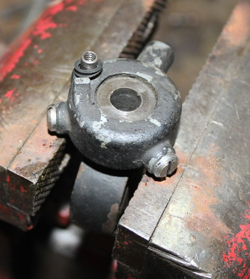

Russ Huber Posted September 1, 2023 Posted September 1, 2023 (edited) Mike, I would assume you have removed the two screws from the collar and collar adjustment spring loaded plunger. With those removed did you clamp the pivot into a bench vice and get a firm grip on the collar and try to twist it free from the pivot. If despite this the collar remains stubbornly frozen to the pivot that would be a heads up any further action would involve risk of damage. If you choose to risk it, I would put some heat resistant heavy gloves on and with a propane torch heat the collar up until you start to see the pot metal alloy start to bubble out and then with your gloved hand carefully grip the collar and try to twist it free. The bubbling out areas on the collar from heating can be wire wheeled clean if it survives the heating process. Edited September 1, 2023 by Russ Huber Quote

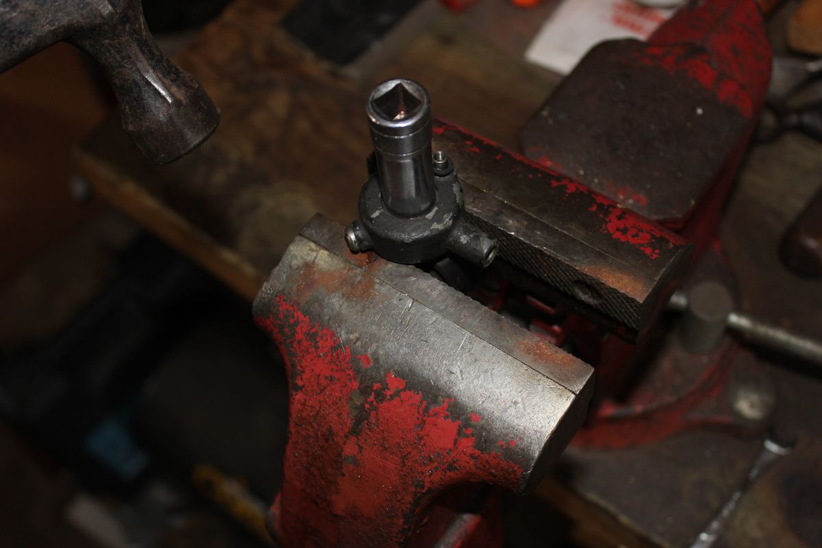

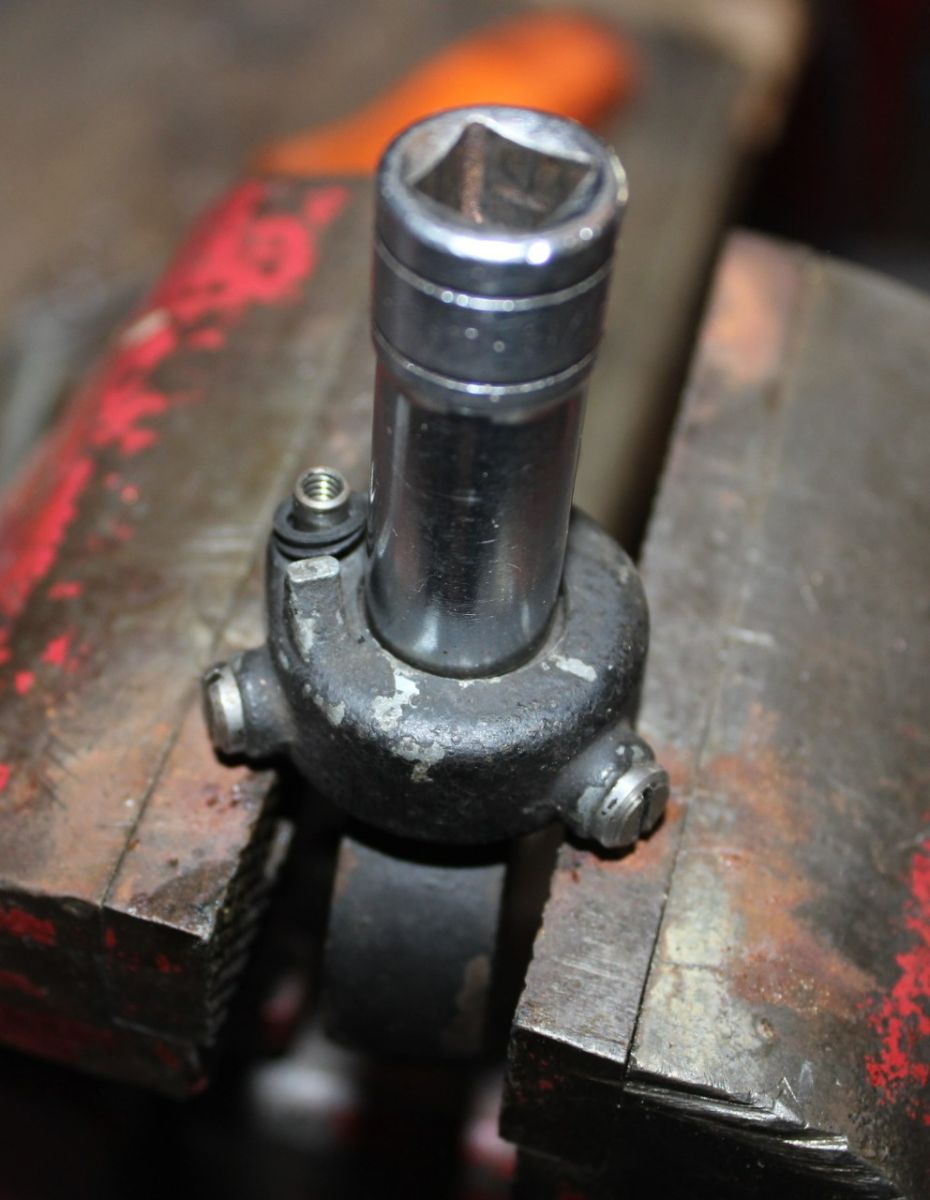

Russ Huber Posted September 1, 2023 Posted September 1, 2023 #2 Risk method. With both screws removed and adjustment plunger removed from the collar, rest the lip of each side of the collar on the bench vice jaws. With a correct diameter deep well socket, carefully try to tap the pivot free from the collar. Quote
