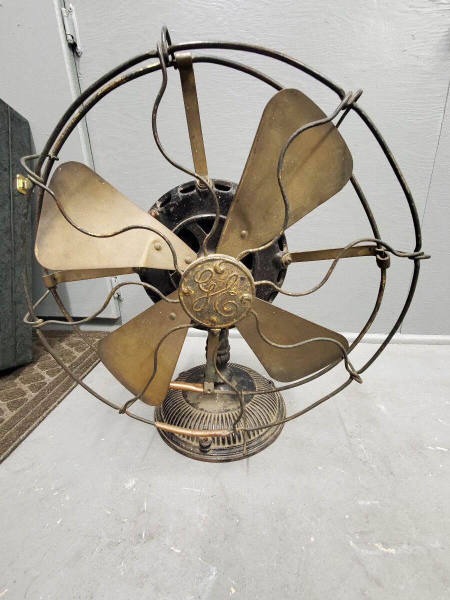

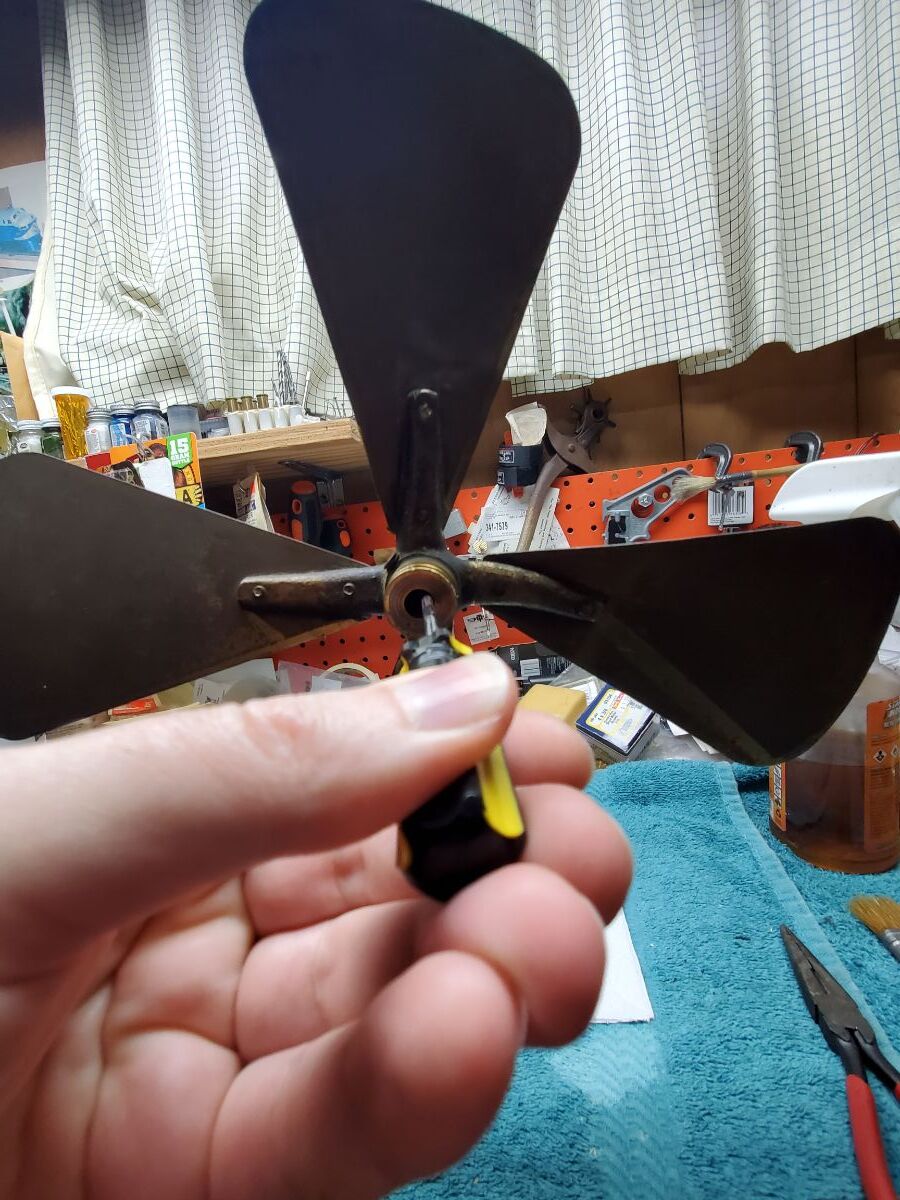

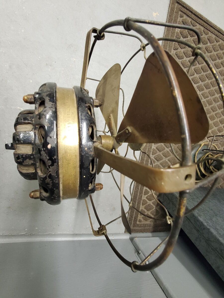

Jeff Jones Posted September 18 Share Posted September 18 (edited) Picked this up over the weekend. Unfortunately the blade is f'ed...and the cage is all bent to crap and was repaired at the bottom. But it's complete, it runs, and the bushing seems to be pretty tight. Anyone know where I might get a blade that won't break the bank? Edited Sunday at 03:03 AM by Jeff Jones Quote Link to comment Share on other sites More sharing options...
Arjun Saini Posted September 18 Share Posted September 18 5 hours ago, Jeff Jones said: Picked this up over the weekend. Unfortunately the blade is f'ed...and the cage is all bent to crap and was repaired at the bottom. But it's complete, it runs, and the bushing seems to be pretty tight. Anyone know where I might get a blade that won't break the bank? Ask @Kim Frank Quote Link to comment Share on other sites More sharing options...
Steve Butler Posted September 18 Share Posted September 18 (edited) Nice score, congrats. See if Jerry Bravi will re-wing it. Edited September 18 by Steve Butler Quote Link to comment Share on other sites More sharing options...
Steve Stephens Posted September 18 Share Posted September 18 Looks like a 12" model with a later (wrapped) guard. The badge is later than 1902 also. I don't necessarily see anything that is not fixable. Quote Link to comment Share on other sites More sharing options...

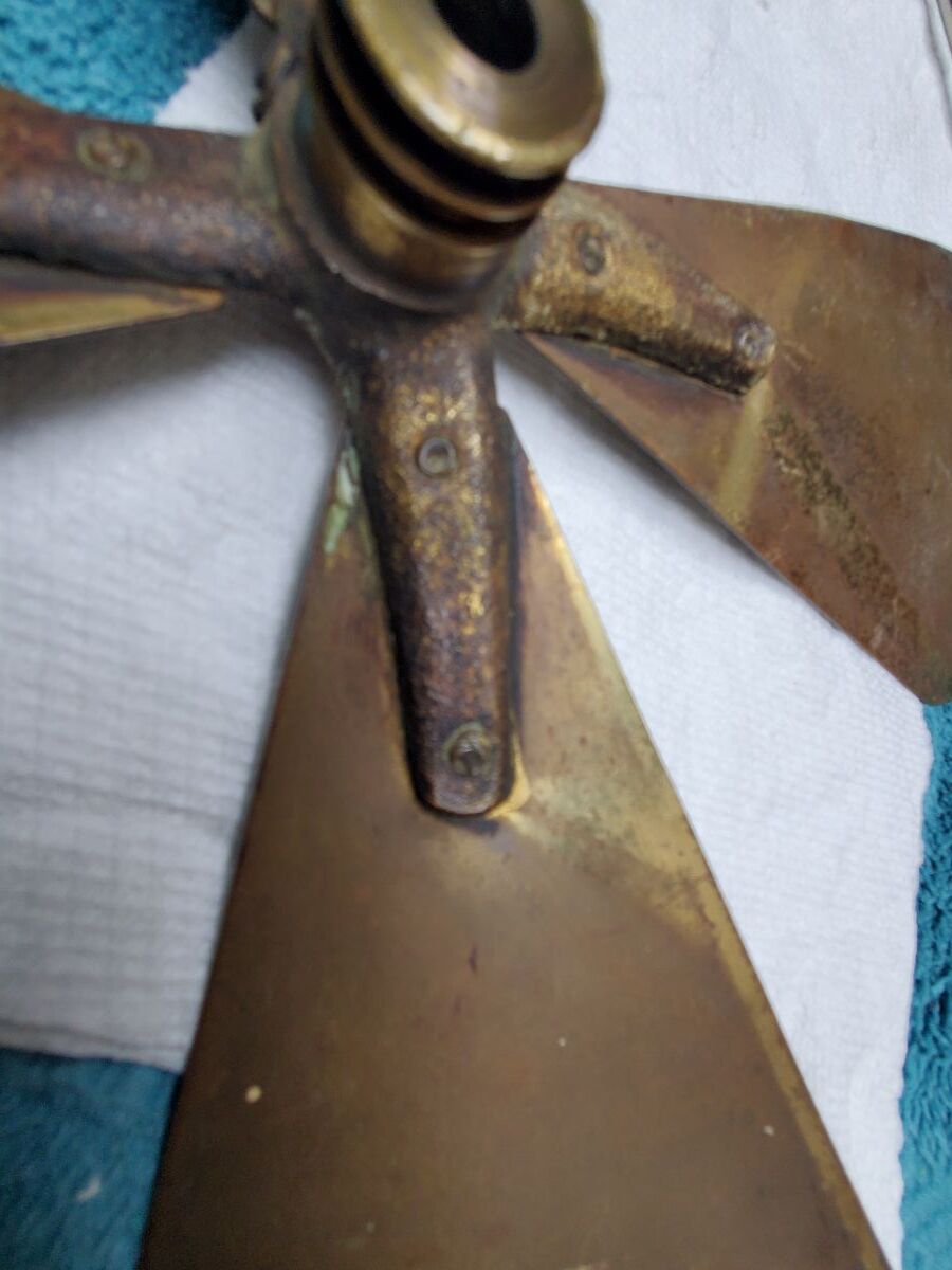

Jeff Jones Posted September 19 Author Share Posted September 19 Just confirming this wasn't one of the ones ge had intentionally put out of clock right? The one spoke on the spider that's bent (curved) almost looks like it was cast that way? The blade was way out of balance...but before attempting to soften it and bend it back wanted to make sure it wasn't intentional. Quote Link to comment Share on other sites More sharing options...
Lane Shirey Posted September 19 Share Posted September 19 5 hours ago, Jeff Jones said: Just confirming this wasn't one of the ones ge had intentionally put out of clock right? The one spoke on the spider that's bent (curved) almost looks like it was cast that way? The blade was way out of balance...but before attempting to soften it and bend it back wanted to make sure it wasn't intentional. It’s my understanding that it was the brass bell era, maybe 2 stars that were “de locked”. The ones I had were brass bells Quote Link to comment Share on other sites More sharing options...
Kim Frank Posted September 19 Share Posted September 19 You're going to need a ten s-wire cage with pinned rear ring. 8 wire cages didn't start showing up on cakes until 2nd variant 1903 and 8 wire wrapped rear ring cages until 1904. Quote Link to comment Share on other sites More sharing options...
Jeff Jones Posted September 20 Author Share Posted September 20 On 9/19/2023 at 7:27 AM, Kim Frank said: You're going to need a ten s-wire cage with pinned rear ring. 8 wire cages didn't start showing up on cakes until 2nd variant 1903 and 8 wire wrapped rear ring cages until 1904. So is my cage wrong? Was able to get it pretty straight. Also this bend on this blade looks almost too perfect....there's no way this would have been cast this way correct? Got the wings themselves straight bit it's still way outta balance...as I'd expext because it's so far out of clock. Quote Link to comment Share on other sites More sharing options...

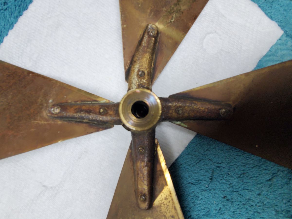

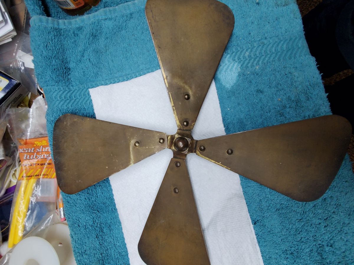

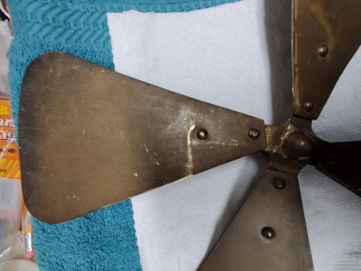

Jeff Jones Posted Sunday at 03:03 AM Author Share Posted Sunday at 03:03 AM Well we attempted to straighten it and it snapped... so now I really need a blade... or I guess I'll post this for sale and try to recoup what I spent on it. How does it get bent that bad in the 1st place but when you gently try to coax it back using heat even it must snaps? Why doesn't it snap initially? Quote Link to comment Share on other sites More sharing options...
Louis Luu Posted Sunday at 03:22 AM Share Posted Sunday at 03:22 AM 18 minutes ago, Jeff Jones said: Well we attempted to straighten it and it snapped... so now I really need a blade... or I guess I'll post this for sale and try to recoup what I spent on it. How does it get bent that bad in the 1st place but when you gently try to coax it back using heat even it must snaps? Why doesn't it snap initially? Snapped....the blade or the hub? If the hub is broken, I would love to own it for drawing purposes. Quote Link to comment Share on other sites More sharing options...
Bill Dunlap Posted Sunday at 04:47 AM Share Posted Sunday at 04:47 AM I've had pretty bad luck fixing those once they've been bent that bad. Even if you could get it back in alignment, could you really trust it not to come apart while running? There might be some hubs left floating around. Someone made some a while back.... Quote Link to comment Share on other sites More sharing options...
Lane Shirey Posted Sunday at 10:48 AM Share Posted Sunday at 10:48 AM It likely became work hardened when it bent. Annealing it before trying to bend it back might have helped. Or there was a micro crack already existing. Quote Link to comment Share on other sites More sharing options...

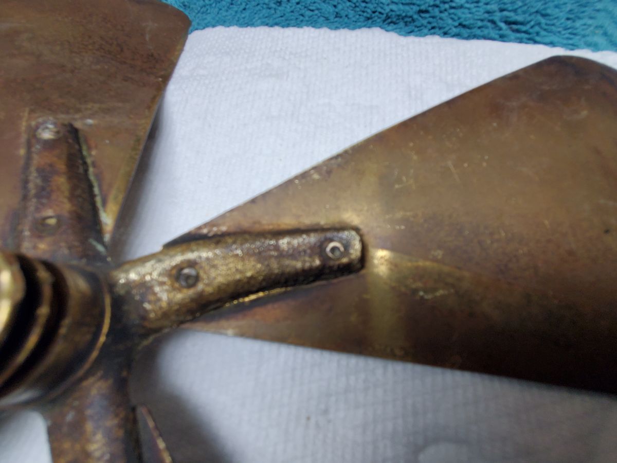

Jeff Jones Posted Monday at 10:11 PM Author Share Posted Monday at 10:11 PM On 9/23/2023 at 11:22 PM, Louis Luu said: Snapped....the blade or the hub? If the hub is broken, I would love to own it for drawing purposes. The hub snapped. The guy repaired it by brazing it using some brass rods. It doesn't look bad...but again my worry is will it fly apart when running...if it's even balanced enough to run. Quote Link to comment Share on other sites More sharing options...
