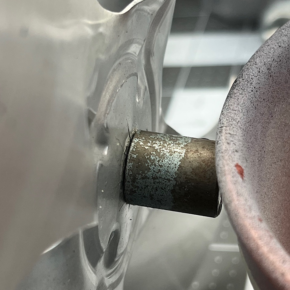

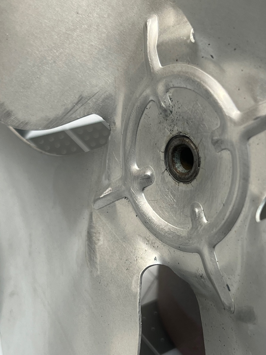

John Landstrom Posted October 11 Share Posted October 11 I’m sure some of you have run into this problem. I have a small 10” Diehl with an aluminum blade that has come loose on the hub. It’s evident that the blade was originally placed over the end of the hub and the hub was pressed to expand and hold the blade tight to it. When I got the fan it had a whiteish hard substance around the front of the hub which looked to me like gorilla glue that had foamed up when curing. When I stripped the paint off and soaked the blade in lacquer thinner it dissolved whatever was put there as a “fix”. Now the blade spins freely on the hub. I’ve tried to solder it with a small torch and flux solder, as well as flux and standard solder but nothing will stick or flow down into the area below the flared end of the hub to secure the blade. I didn’t super heat it fearing the aluminum blade would melt. Also, I don’t have anything close to a press to try and replicate what the factory did. Someone here has to have dealt with this situation and come up with a solution. Quote Link to comment Share on other sites More sharing options...

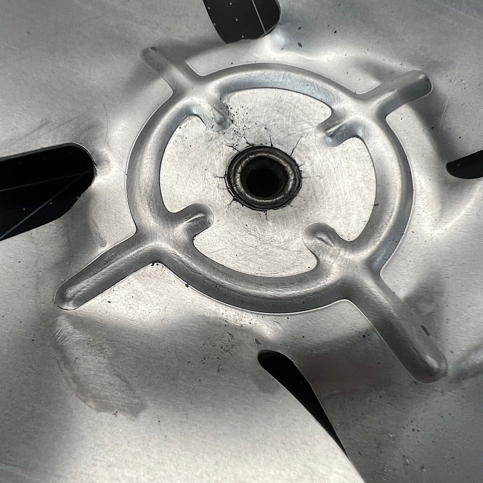

Paul Michael Posted October 11 Share Posted October 11 Restaking it isn't the problem. The hoard of radiating fractures is. I'd replace the blade. 3 Quote Link to comment Share on other sites More sharing options...

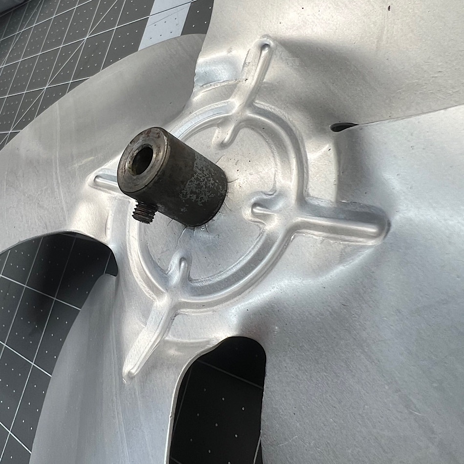

Lane Shirey Posted October 11 Share Posted October 11 3 hours ago, Paul Michael said: Restaking it isn't the problem. The hoard of radiating fractures is. I'd replace the blade. Generally I’d suggest finding a socket that is the same size as the steel hub flange and place the socket on the flange with the other side of the hub on a vice heel. A few good whacks with a hammer on the socket will tighten the hub, but I agree with Paul that the stress fractures are a safety concern. 1 Quote Link to comment Share on other sites More sharing options...
John Landstrom Posted October 12 Author Share Posted October 12 I’m planning on trying all the above suggestions, though Lane I can’t readily picture your method. looking at it it lookes to me they had a “grommet” style seating shaft in a press. I get using a socket on the backside to stabilize the hub, but can’t picture what to use on the front side to compress the steel. I’ll keep thinking about the ideas. I’m also looking for my JB Weld tomorrow morning. 1 Quote Link to comment Share on other sites More sharing options...

Lane Shirey Posted October 13 Share Posted October 13 (edited) On 10/11/2023 at 9:37 PM, John Landstrom said: I’m planning on trying all the above suggestions, though Lane I can’t readily picture your method. looking at it it lookes to me they had a “grommet” style seating shaft in a press. I get using a socket on the backside to stabilize the hub, but can’t picture what to use on the front side to compress the steel. I’ll keep thinking about the ideas. I’m also looking for my JB Weld tomorrow morning. The socket goes on the front of the blade, and the back of the blade hub rests on the vice or anvil. The hammer hits the socket on the front of the blade hub. Do some searching, this topic has been covered several times in the past with pictures. Hope that helps. Edited October 13 by Lane Shirey Quote Link to comment Share on other sites More sharing options...
George Durbin Posted October 13 Share Posted October 13 Adding to this post I have discovered nearly all blades repaired with epoxies or other glues just do not hold up over time... The reason is a blade spinning at roughly 1500-1750-3500 rpm causes enough vibration to eventually come unglued so to speak... I have used a 1 ton press with a socket to crimp the blade back to the hub... 3 Quote Link to comment Share on other sites More sharing options...
