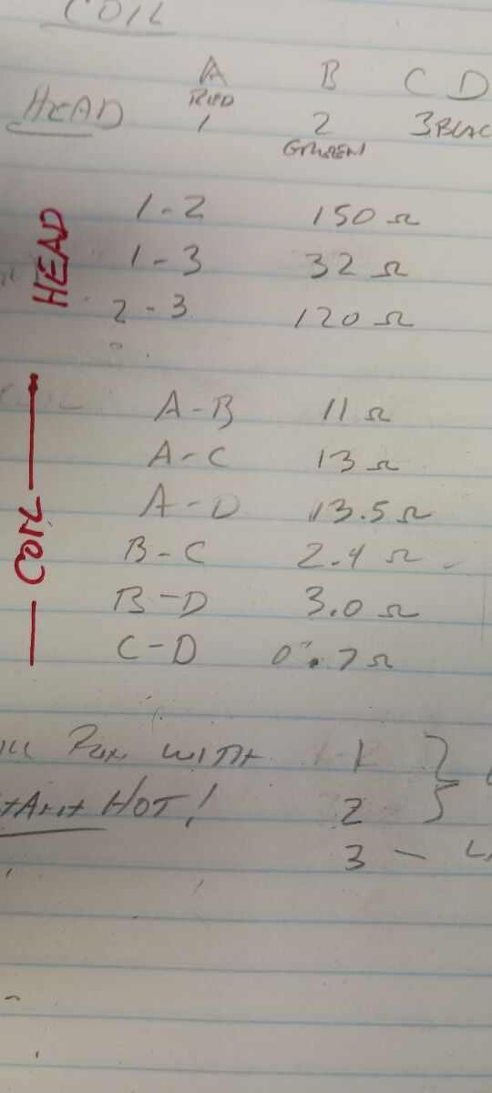

Subject: 1943 Hunter 235 Type C12; 3 speed desk fan.
Purchased non running due to some genius cutting all wires in the base. I have ohmed the motor and speed coil but have been unable to get it running. four wires at speed coil and three to head. I have hotwired the head but will only run on one speed and only if I spin the blade to get it going. Below are the resistance values of the coil and head. Appreciate any assistance on this one!
