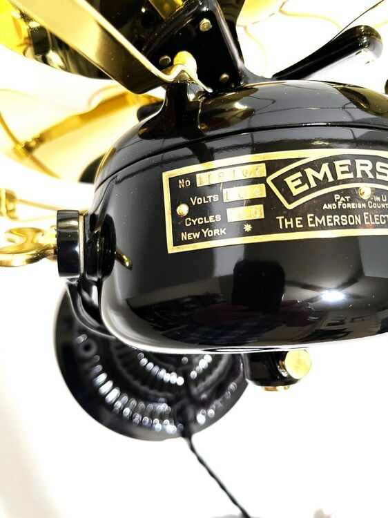

Bobby Gaines Posted October 28 Share Posted October 28 (edited) Hi Fan Friends! I finished restoring my Emerson 11646. I bought it from Karen at Doc's meet in June. The motor and switch was in pretty good shape,the base and motor case needed to be repainted. I got Jerry Bravi to rewind the blade (beautiful job) and send me a kit for the centrifugal start switch which was perfect! New head wire and power cord. Had a lot of work on the cage straightening, silver soldering and polishing. I had help from members with several problems beyond my expertise. All and all I think it turned out pretty go. Edited October 29 by Bobby Gaines miss spelled 7 Quote Link to comment Share on other sites More sharing options...

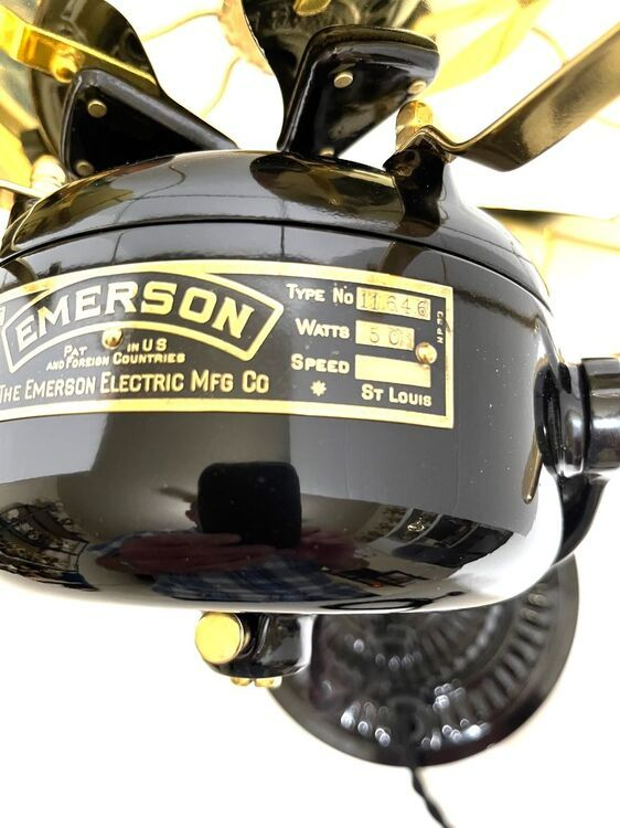

Bobby Gaines Posted October 28 Author Share Posted October 28 3 Quote Link to comment Share on other sites More sharing options...
Bobby Gaines Posted October 28 Author Share Posted October 28 I forgot to show the back,so Cool! 7 Quote Link to comment Share on other sites More sharing options...
Paul Carmody Posted October 28 Share Posted October 28 (edited) Holy smokes that’s a beautiful fan Bobby!I commend all who were involved! Edited October 30 by Paul Carmody Quote Link to comment Share on other sites More sharing options...
Bobby Gaines Posted October 28 Author Share Posted October 28 Paul thanks for turning me on to that Menzerna Medium Cut compound, That made a lot of shine! 3 Quote Link to comment Share on other sites More sharing options...

Stan Adams Posted October 28 Share Posted October 28 Gorgeous! That is the first design base, so early model. Quote Link to comment Share on other sites More sharing options...

Dennis Long Posted November 2 Share Posted November 2 Bobby, that is truly beautiful! 👍 Impressive paint laydown - is that automotive? What's the secret to polishing blades so smooth, i.e. without any scratch marks? I understand that even microfiber cloths will scratch brass................ If you get tired of this fan, let me know, my son wants this very fan, in this condition ............ 😉 Quote Link to comment Share on other sites More sharing options...
Bobby Gaines Posted November 3 Author Share Posted November 3 Dennis that is Rust-oleum appliance paint polished out after curing 7 or 8 days. I used Menzerna medium cut. 2 1 Quote Link to comment Share on other sites More sharing options...
