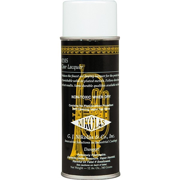

Josh Atkinson Posted November 4 Author Share Posted November 4 Any specific lacquer that you guys prefer? Quote Link to comment Share on other sites More sharing options...
Dave McManaman Posted November 5 Share Posted November 5 1 Quote Link to comment Share on other sites More sharing options...
Josh Atkinson Posted November 5 Author Share Posted November 5 Thanks. I will find some Quote Link to comment Share on other sites More sharing options...
Lane Shirey Posted November 6 Share Posted November 6 On 11/4/2023 at 9:46 PM, Dave McManaman said: If you buy McMaster Carr’s “clear metal coating” it’ll be Nikolas brand. They don’t list manufacturers names. 2 Quote Link to comment Share on other sites More sharing options...
Doug Wendel Posted November 6 Share Posted November 6 (edited) 6 hours ago, Lane Shirey said: If you buy McMaster Carr’s “clear metal coating” it’ll be Nikolas brand. They don’t list manufacturers names. Yup. What he said. It’s used on brass musical instruments too. Edited November 6 by Doug Wendel 1 Quote Link to comment Share on other sites More sharing options...
Jim Roadt Posted November 7 Share Posted November 7 6 hours ago, Doug Wendel said: Yup. What he said. It’s used on brass musical instruments too. I had a Mark VI Selmer Saxophone years ago and was selling it to a Sax player who would not have bought it if it was lacquered , messes with the sound he said.... Quote Link to comment Share on other sites More sharing options...
