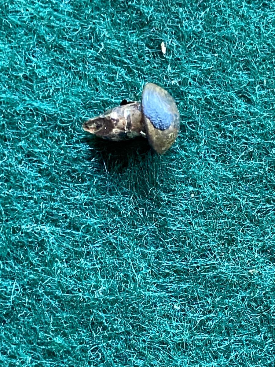

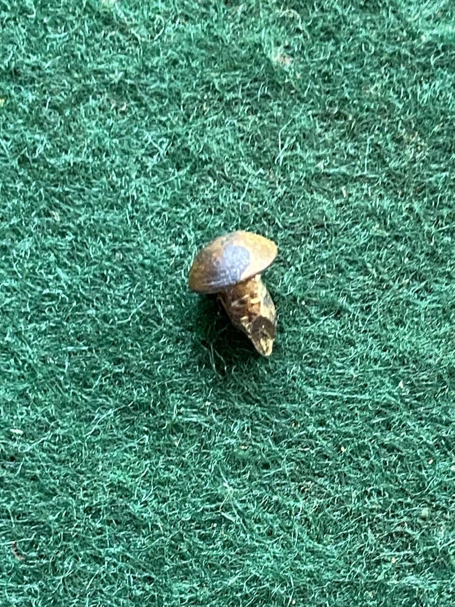

Scott Braswell Posted November 5 Share Posted November 5 Anyone know the correct size rivet for a GE AOU 75425 name plate? I appreciate the help. Quote Link to comment Share on other sites More sharing options...

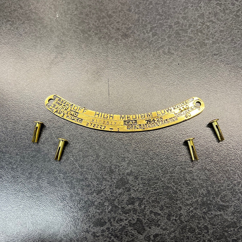

John Landstrom Posted November 6 Share Posted November 6 (edited) Scott, I’ve used these on my old GE’s and they look fine. Granted, they’re not as domed as the originals but I gave up after months of searching. I’d be happy to send you some to try out / use. Just send your address to me in a message and I’ll pop ‘em in the mail. Note: You do have to cut the split deeper with a small hacksaw blade so that the remaining solid part is about 1/8”. That way they’ll hold well. I just popped the head in a small vice and gently sawed down the split to the desired depth. Took 2 minutes each. Check out the pic and you’ll see the differences in the split rivets. john Edited November 6 by John Landstrom 1 Quote Link to comment Share on other sites More sharing options...

John Landstrom Posted November 9 Share Posted November 9 1/8” x 7/16” brass split rivets work well and come close to the originals; albeit the dome is flatter. Can’t remember where I got them but just Google them and you’ll find a few places that have them. Look for solid brass. The solid part of the shafts are a bit long making them loose but just tale a thin hacksaw blade and cut the split deeper and they work fine. 1 1 Quote Link to comment Share on other sites More sharing options...
