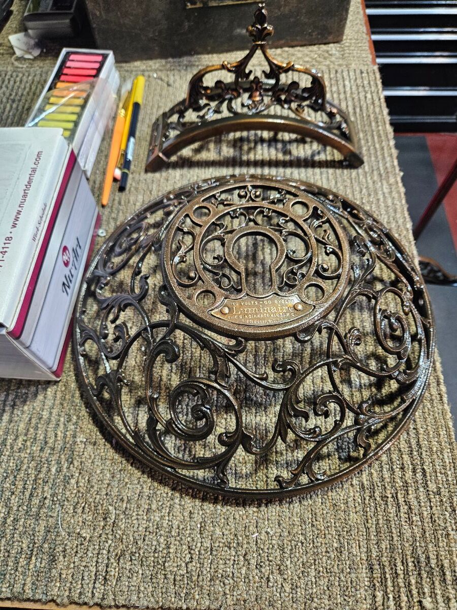

A little steel wool to make highlights standout better followed by secret sauce and heat17020683576983161252171141103220.thumb.jpg.8db8f891a9e2c6f38cf1f1b1898236e6.jpg17020684050163057675851541765366.thumb.jpg.a71f1ad82961c360e551af1c94969345.jpg
On 12/7/2023 at 11:10 AM, Evan Atkinson said:
Victor. I think your Luminaire is the “Florentine Bronze” finish. Nice looking. Interesting that your fan has that ornamental union mid-way on the pole stand. Mine does not have that. Your motor is the early one with the pot-metal bearing holders, with oilers. Tread cautiously!
Evan, that decorative piece on the shaft is exclusive to the 6’ model along with the 15” feet. The 5’ models did not come with it., and they came with 10” feet. That is a 6’ model.
  • Like 4
Thanks for the info Russell. I know nothing about Luminaires other than having "seen 'em around" and I hadn't noticed there was a height difference between models. Learning though!

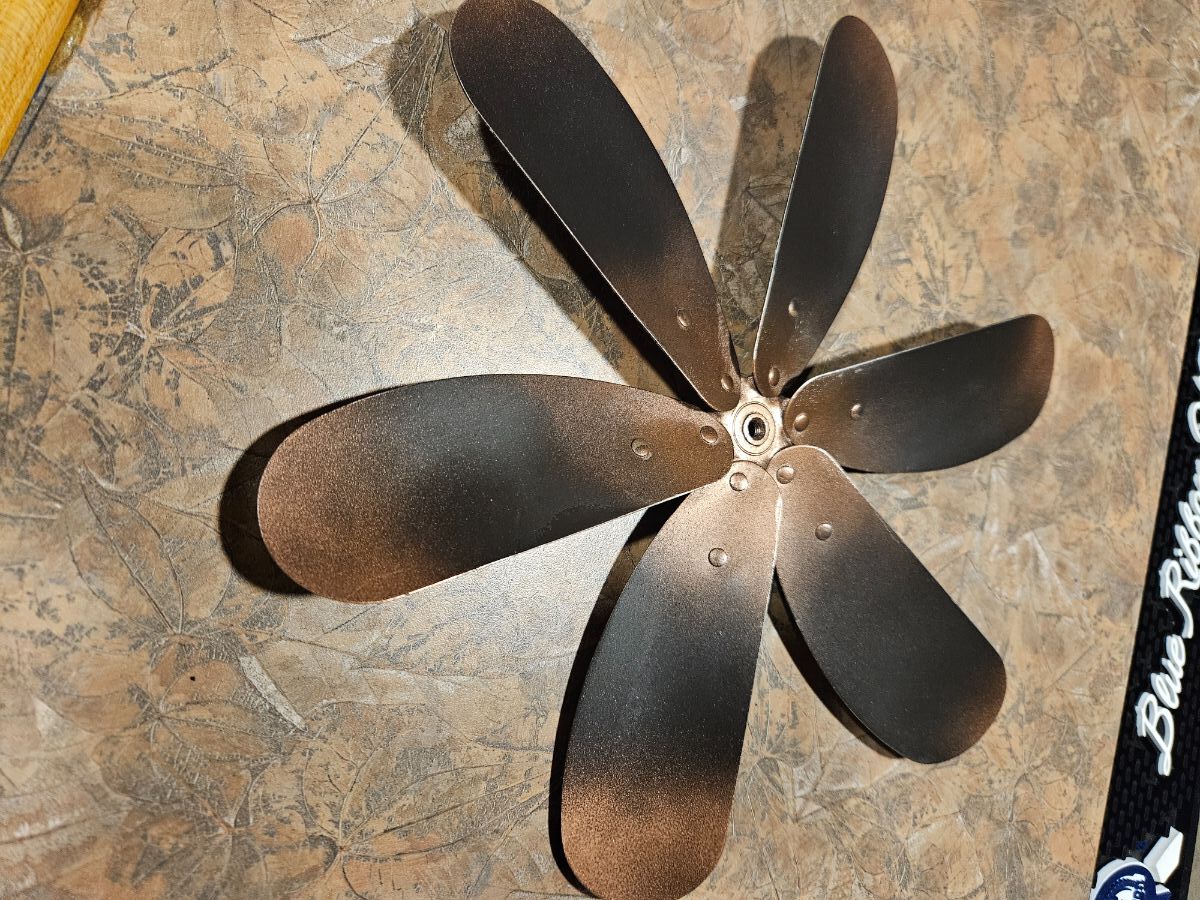

blades cleaned up nicely....original finish??17020509738157328671261841975735.thumb.jpg.cc7e747e145db509e961c0a07c5d9ca4.jpg
Sure looks like Florentine Bronze to me!
 Thanks...Glad to hear it because  I repainted blades, too far gone for my taste and can barely see them once it is put back together

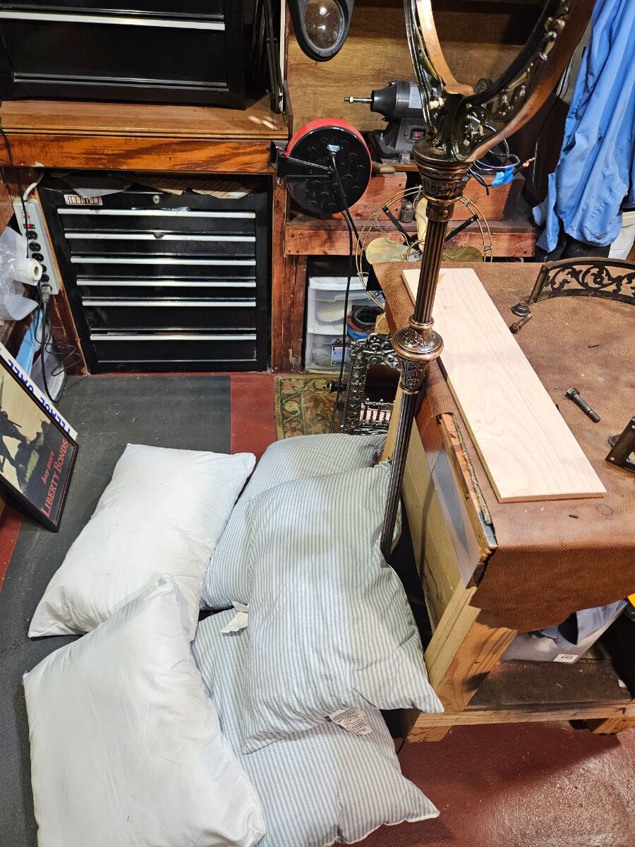

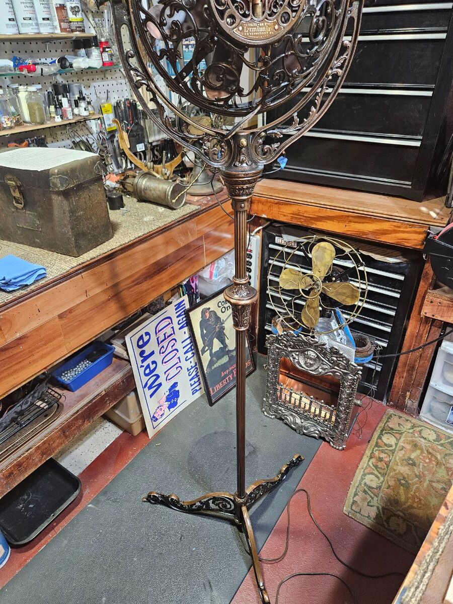

Starting to reassemble.  Glade I didn't work at the Luminaire factory , those cast pieces seem to be spring loaded,   hence the landing pad20231211_173357.thumb.jpg.e963ea237f6abe8185c04d711a032445.jpg20231211_173009.thumb.jpg.2b0c7de4408d0d90cf6972a93804df08.jpg

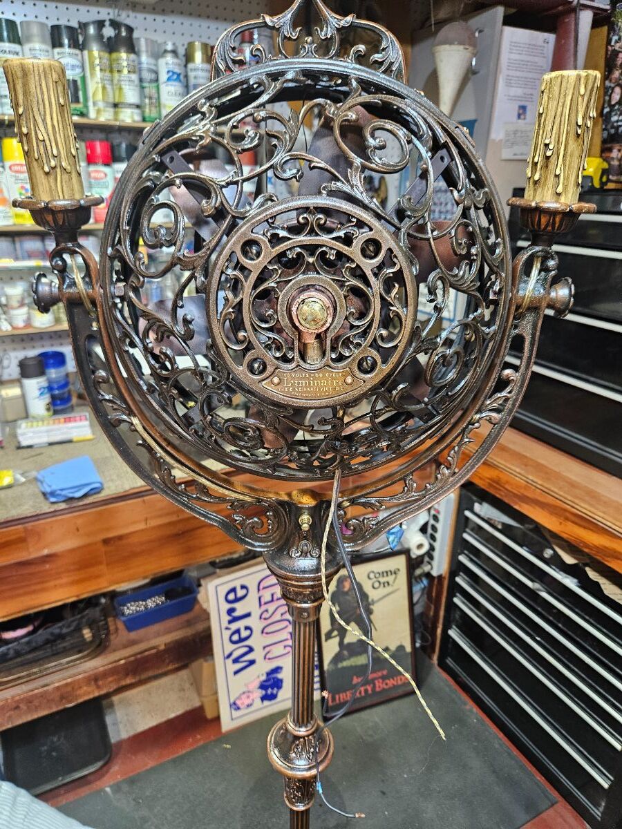

Warning !!!!   NEVER EVER take a job at the Luminaire assembly plant.  Spring loaded ,slightly off holes with no access etc.....What was the average wage there?17024037729257453115822182313131.thumb.jpg.b1cbb49abc8e9d15e12200285e6e8f74.jpg

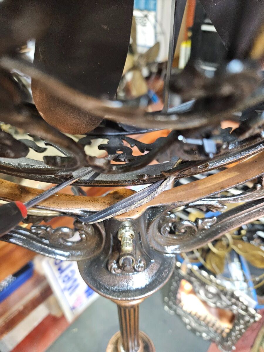

The black wires are for power the yellow striped wire was never connected to anything and everything worked.  Is that a ground wire?20231212_120317.thumb.jpg.455d71cebb1ac09d3863a330ec9f7a7b.jpg

I live less than 20 miles where that fan was made so they are quite prevalent around here.. the famous picture of two luminaires set out to the trash is from Covington Kentucky, where the designer lived.. 95% of these fans have damage filagree, because of how the legs wind up getting repositioned….. position two legs up front and one leg  in the back, not the other way around or  you may also fall prey to falling backwards … if your motor self-destructs, from the crumbling bearing holders you can replace the hole thing with one from any Victor breeze spreader.
By studying the filigree castings carefully, you can see places designed to help carry the wires, modern wiring is too thick. You will need to use the old stuff.

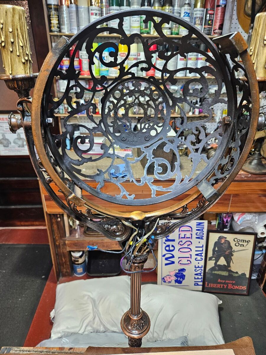

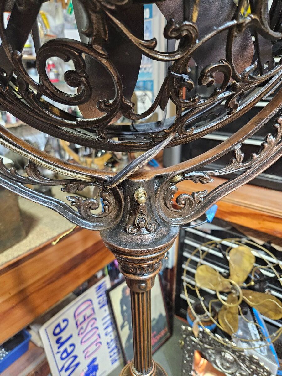

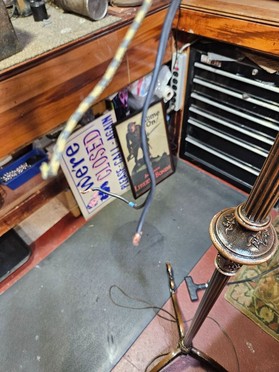

mine was originally wired as pictured, however,  I notice a hole in center of bottom casting ( screw driver pointing )that looks like it should go there?17024152804992735988565099311703.thumb.jpg.7404fdb85613197b69bc1b3692e23747.jpg17024153723341603854909468515227.thumb.jpg.64f1fb06c12085c0b31c0e08eff7959f.jpg17024153968467037167503241698234.thumb.jpg.fd0c9e74ad808473b56b728cfe55fbbe.jpg
That center hole was in each of the cast panels that make up the top, sides and bottom of the cage, and the purpose was to mount the crest with its threaded nipple in that hole in the top panel. Victor realized it didn't need to make a special panel for just the top, so it made all four quarter panels the same. My wires thread out the back of the motor, to the sides, and down the yoke sides to enter the union.
All I can say is…once properly wired you will be able to swivel the motor in the yoke..
yep.... pointing in proper direction now
