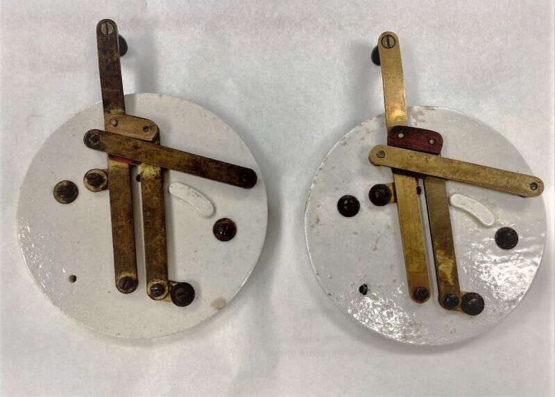

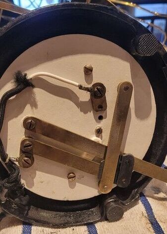

  4. Anthony Lindsey
    Need your help!
    They seem the same based on appearance from bottom.

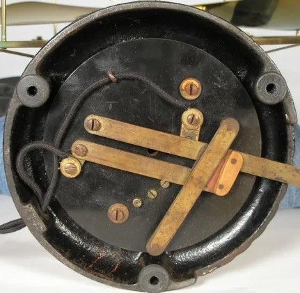

  5. Russ Huber
    Need your help!
    Tesla restored for Ron Jeter by Mike Petree.

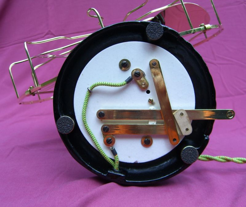

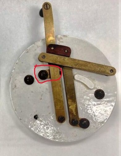

  6. Russ Huber
    Need your help!
    David Dimitrion posted in past switches.

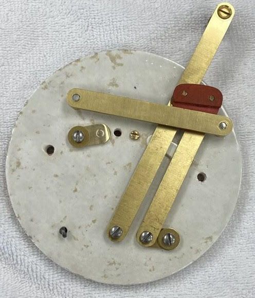

  7. Russ Huber
    Need your help!
    Switch image borrowed from Antique Fan Parts Tesla listing.

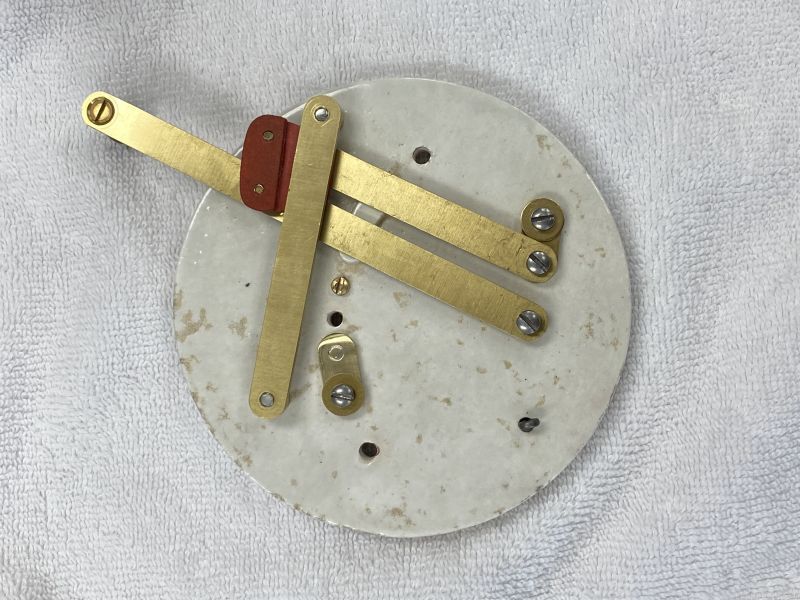

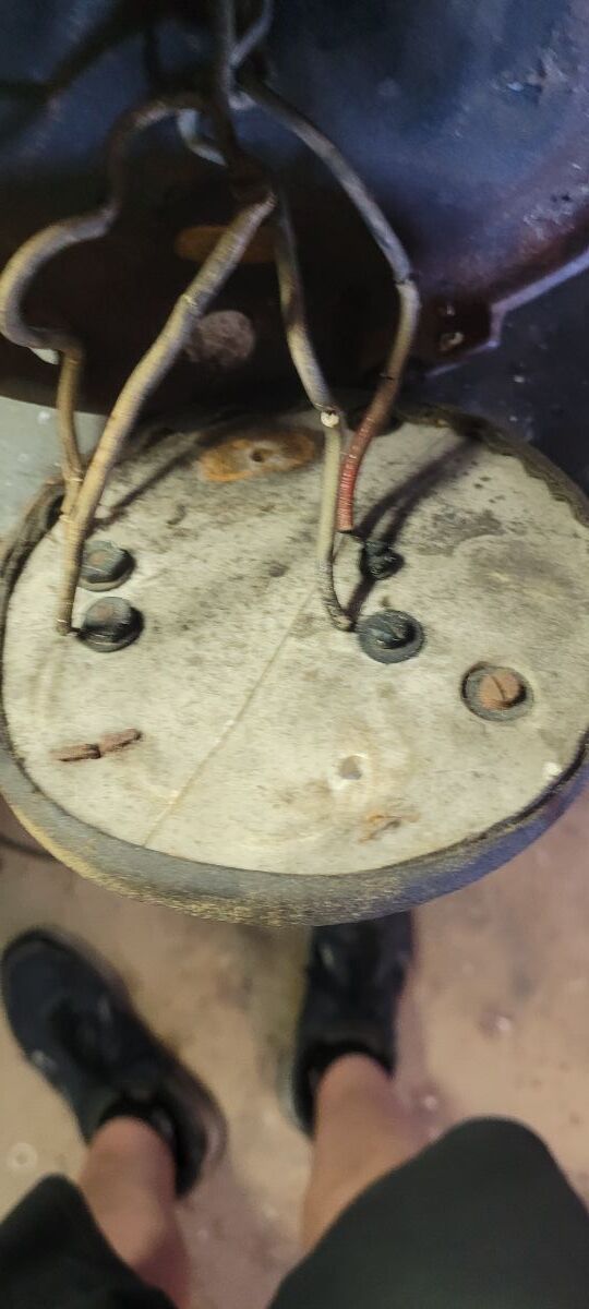

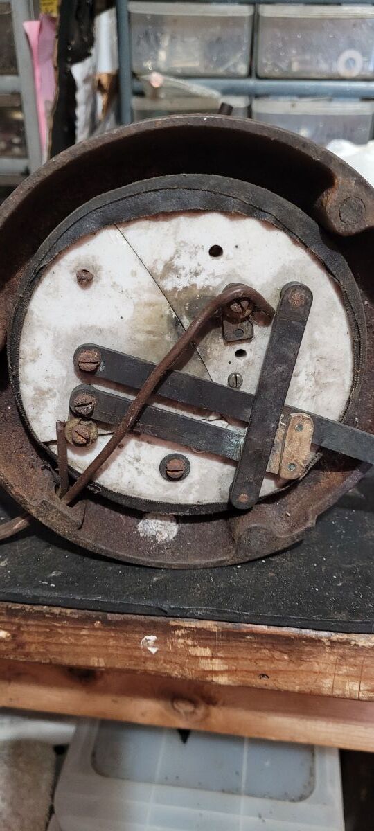

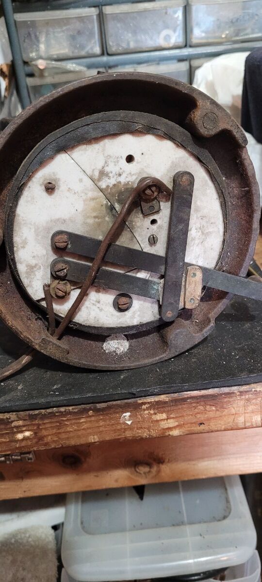

  9. Anthony Lindsey
    Need your help!
    Original condition pictures

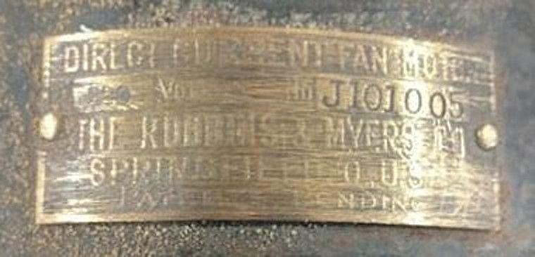

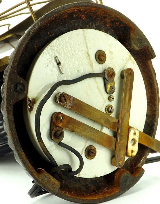

  10. Russ Huber
    R&M J101005
    No use of the word LIST, yet the tags appear to fit same time period.

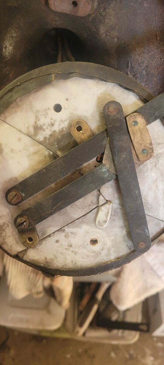

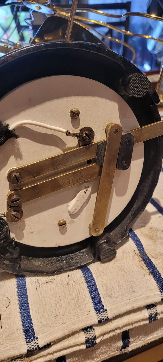

  12. Russ Huber
    Need your help!
    Is your switch missing some screws/contacts/wiring, Anthony? Compare the photos. Could be what is creating this strange issue?

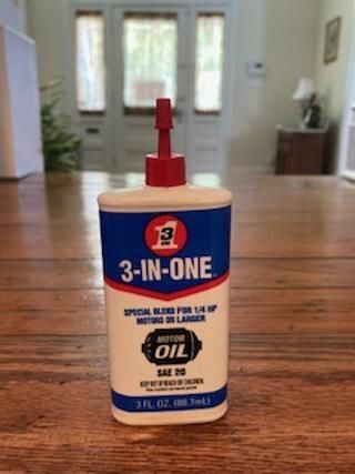

  14. Marc Sova
    Which oil to use in a GE fan oil cup?
    What others said above. Blue 3in1 is the best easiest to get (ace hardware etc). But I find that I can smell it when a fan’s been running a. While. Not terrible. But I do like that it’s 20wt and not 10 like the zoom. I’ve yet to try any 30wt. As for balancing….quick and dirty method is to try to do it on the cage that way you can use your finger on the cage ;front and then back and back and forth until you get it right) as a sort of “depth gauge”. There’s a good few videos on YouTube. I made a simple jig to hold a pencil (eraser end). But finger works. Sure…a strobe light is ideal…but you can get it pretty good without.

  16. David Northam
    It's partly a matter of person preference on what oil and grease to use, but these are my usual "go to" products. If you use the 3 in 1, it's important to use the blue can and NOT the red one. Unfortunately, Jeff is very likely right about the blades being out of balance. But just to be sure, I'd recommend removing the blades just to make sure the the set screw is properly aligned with the divot in the shaft and the set screw is very tight. That is likely not the problem - but wow if it is, you'll save yourself a lot of time and frustration compared to straightening the blade. Unless you have a strobe light and know how to use it to straighten/balance blades, I recommend trying to adjust them while on the fan. Assuming the cage is straight, you can use it, along with a tape measure or even your finger to find out which blade(s) are bent too far forward or backward. If the blades are out of clock, that's a different issue entirely. Just looking at yours from the photo, they don't appear to be out of clock. Your fan appears to be in very nice condition. With a little cleaning and polishing, it will be stunning! Those 16-inch Vortys are impressive running fans.

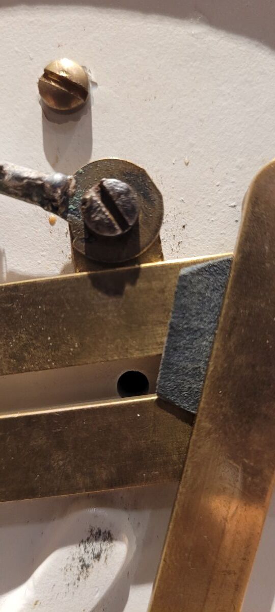

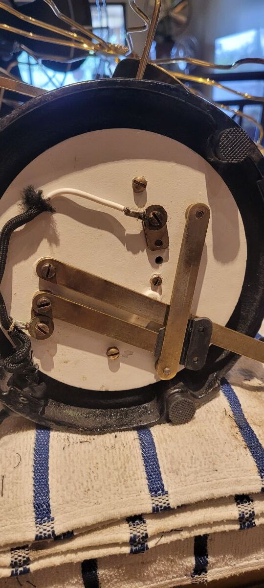

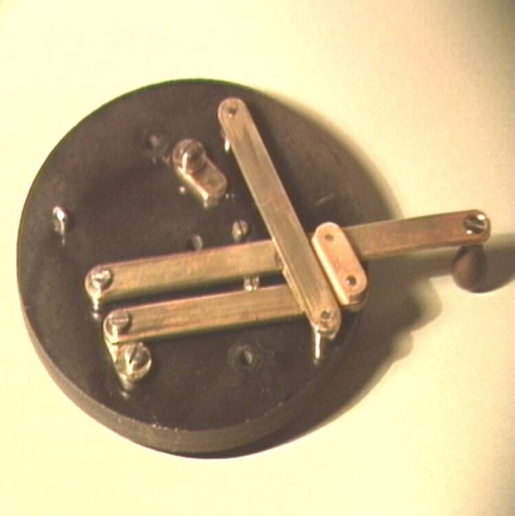

  17. Anthony Lindsey
    Need your help!
    Pictures and a video of switch at the end. I see the spacer moving as the switch touches it. Could that be issue? 20250705_094955.mp4
  18. Anthony Lindsey
    Need your help!
    Well...... When I pull back a couple millimeters the fan runs at 1.4 amps at the same speed as when the switch in all the way pulling the 3 amps. Once I pull the switch halfway back it drops to around .9 amps and runs on low. So it has 2 completely different speeds, Hi and Low so I don't think it is dropping half the coils on "High" as there would not be a lower speed once I pull the switch back to the middle where I do get a nice low speed. The fan runs nice and smooth and cool on both Hi and Low as long as the switch isn't all the way to the very end.

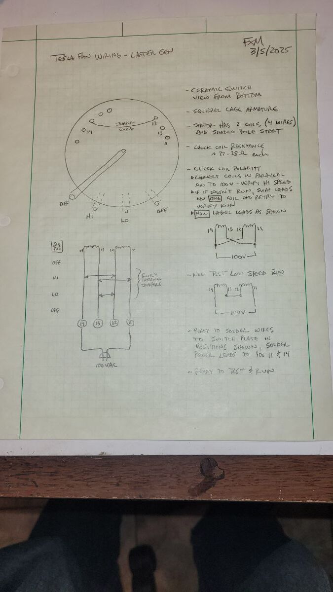

  19. Frank McCormack
    Need your help!
    I agree with Russ, look at the design of the switch. When you have the switch in the high speed position its pulling 3amps. If you back off a bit and the amps drop to half, you are dropping out one set of coils and running on half of the motor. Thats interesting and seems pretty good to me, how is the temperature during a long run? If its moving air and not heating up, that might be a good feature. And the amps are reasonable for that coil so i dont think its harming it. I'm attaching my wiring notes for the tesla, it highlights how a set of coils can drop out if both jumpers are slightly out of sync.
  20. Marc Sova
    Is it worth it?
    Hmmm. I mean….im a hardcore road tripper. I drive lots for work, and drove three hours one way some months ago to get my minty 77 pedestal. The price on this is great…but I’m always concerned when something looks like it’s been monkeyed (“restored”) with somewhat (ie- brass polished etc). Don’t know what else they might’ve done (hack job doing a headwire maybe?). I dunno….if it was very orignal looking, nice soft patina, I’d probably def be more inclined to drive that. Of course that’s only about $50 in gas for me in the Pontiyota ViBeater. But still….its a good deal for sure.
  21. Russ Huber
    Need your help!
    I would be tempted to check out the two contact positions on the porcelain terminals at the 1.4 position as opposed to the high position. What are those lever contacts touching in those positions to that 4-wire head cord.
