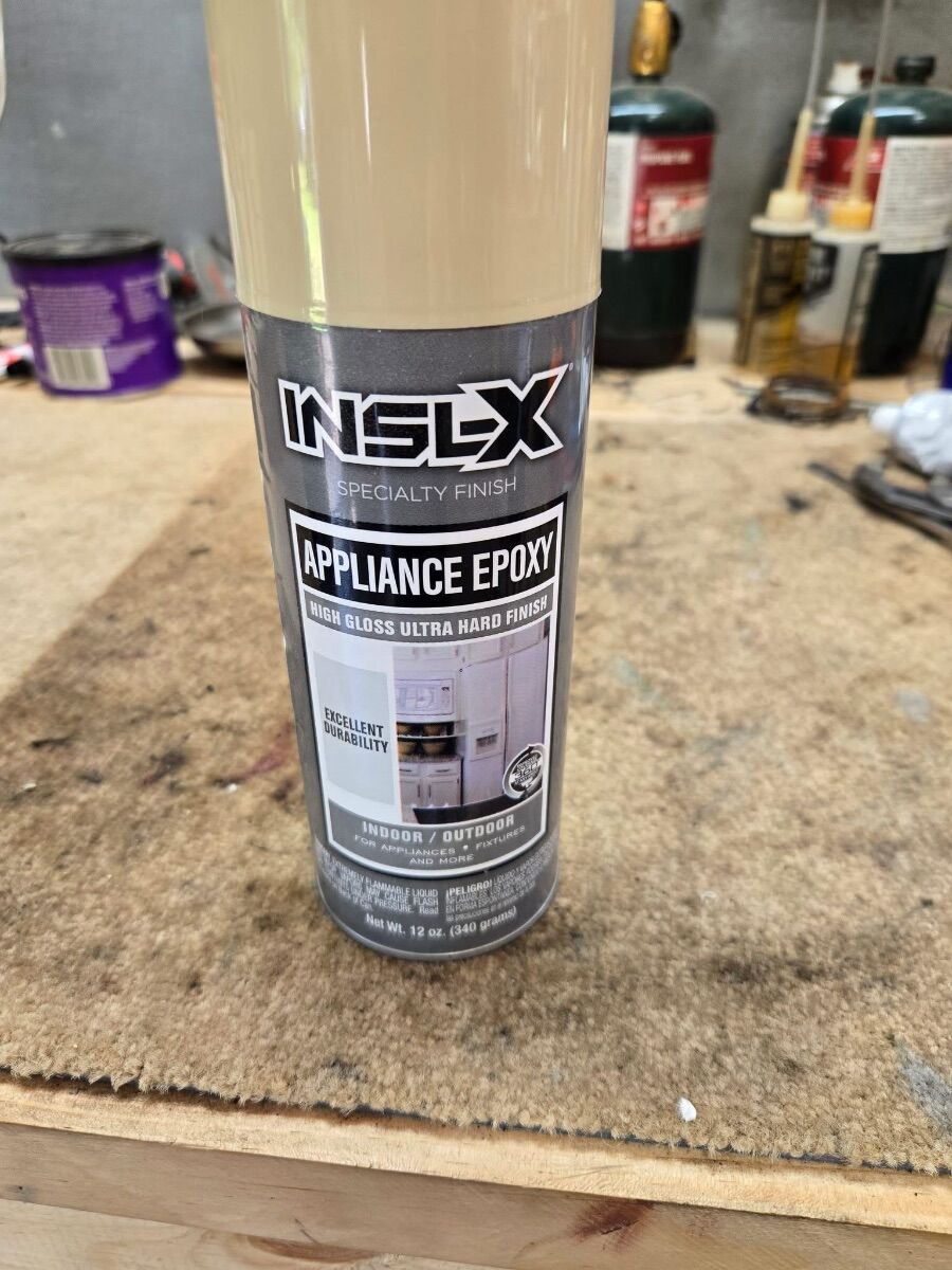

  8. Thomas Peters
    Insl-X Appliance Epoxy (gloss)
    It is a Benjamin Moore product. Check with them for availability.

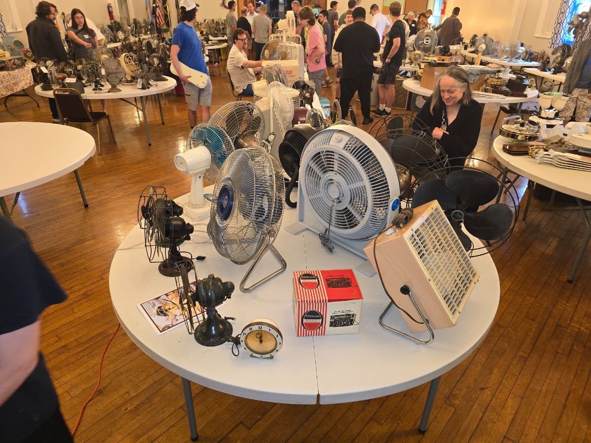

  14. Robbie Lawrence
    LEHIGH VALLEY!!
    Pleasure as always to see you. So happy you were able to make it! Love to hear how happy everyone was and how smooth everything went. See you next month!!!

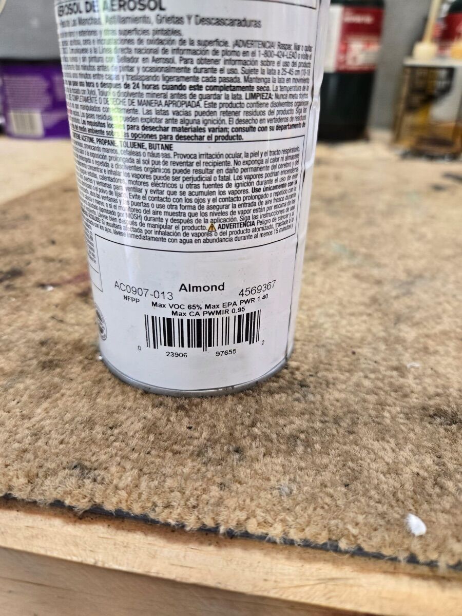

    Anyone know where to get this brand appliance epoxy? Can’t seems to find it in a google search. Maybe it’s not sold in the USA? Saw it posted on a fb group and the poster seems to have gone dark. I’m familiar with the brand having used some of their interior bonding primers and what not. But not seen this product before. The almond color seems to be a real good match for ivory fans AND more importantly it comes im gloss. Rustoleum appliance epoxy only seems to come in satin in Almond and Biscuit etc. Only black seems to come in gloss.

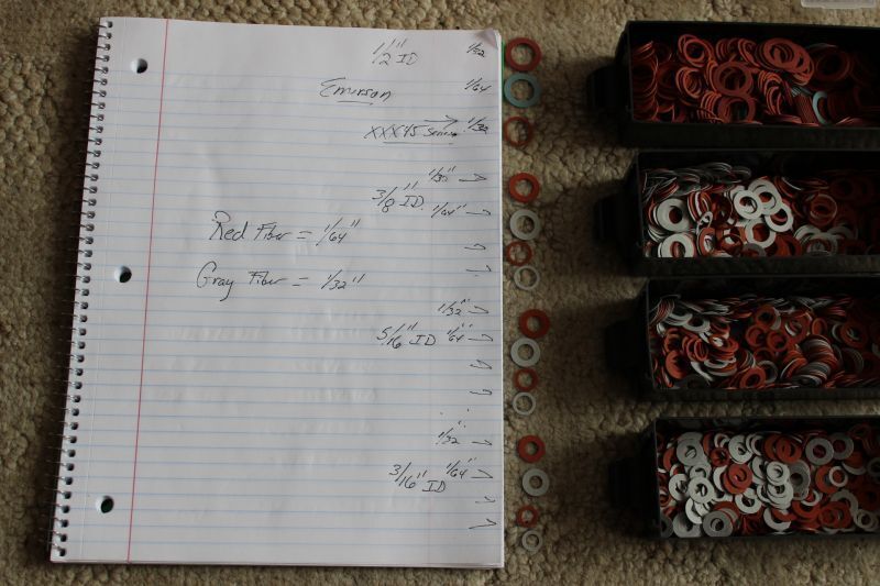

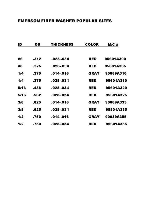

  26. Gotta love McMaster. You can snug rotor/armature end play on nearly ALL popular shaft sizes WITHIN 0 to 1/16".
  27. Here's a list of common Emerson washers and the SKU from McMaster Carr. I think they come in pouches of like 25+ each.
