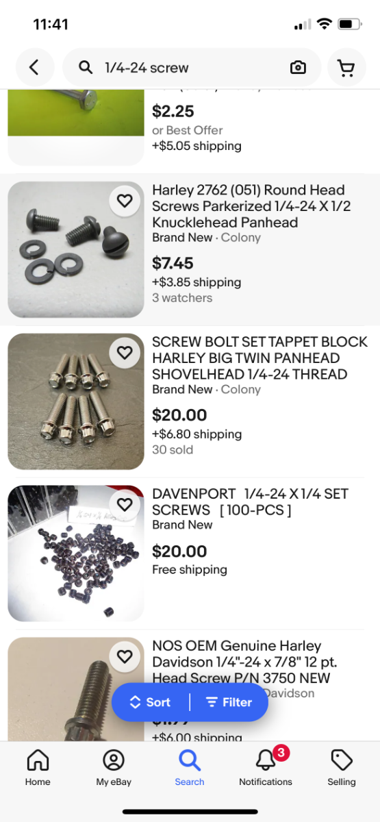

  2. Sidewinders use 1/4-24 screws. Not the common 1/4-20 or 1/4-28. Darryl Hudson makes replacements. Also, they are used on some old Harley Davidsons
