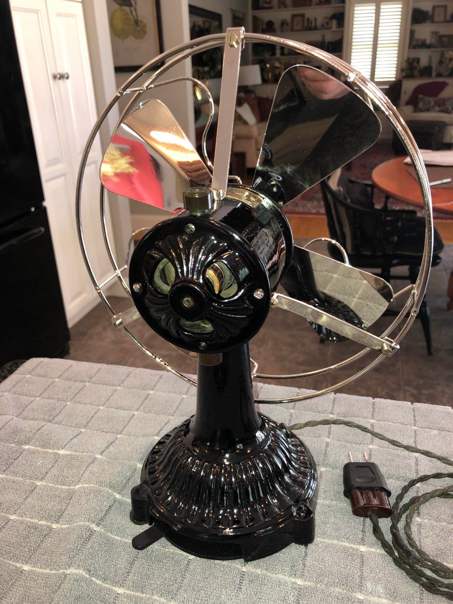

Dr. Max Levy fan nearly complete
Friends:  Today I was notified by the local plating shop that I use that they had completed the stripping and replating of the cage, struts and blades of the 1905-1908 Dr. Max Levy fan. The fan is nearly complete except for the front and rear oilers. Recall that Darryl Hudson has the one original oiler in his possession for reproduction when he is feeling up to doing the job.
IMG_3352.thumb.JPG.d7c0cb6351ee97ff3d12dbbfdd306472.JPGIMG_3357.thumb.JPG.05287017d547a5d893b1a17ded82ac69.JPGIMG_3356.thumb.JPG.c56ace855352b0a4cc0a3cc8cd512777.JPGIMG_3355.thumb.JPG.a7662fea22d2c180c5f855d5896274b5.JPGIMG_3354.thumb.JPG.7562d58821c60055c3da9751a1aaa508.JPGIMG_3353.thumb.JPG.c5a04ceb1a78fd8c9a72e0aea0f26015.JPG
The variable frequency drive in the video is programmed to run the fan at 42 cycles (Hz) and 150 volts. Note the long spin down time which is unusual (in my experience) for a brush fan. Rick Powell's japanne makes this fan every bit the elegant beauty that it once was.

It being a series motor (150V - 42Hz), I am sure it could be ran on full-wave rectified 120V - 60Hz without detriment.  Might run slightly slower.

Beautiful David, I can’t say it any other way. Now who polished the nickel?
The plating was done by South Shore plating in Quincy Mass., friends of New England Brass Refinishing. The cost was $200 to strip all the old nickel off down to the brass and re-apply the nickel. It was done in ten days.
