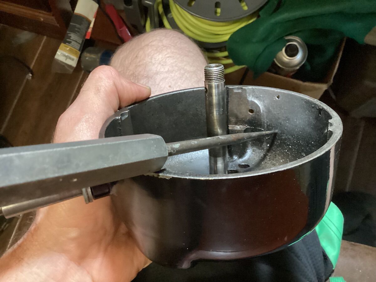

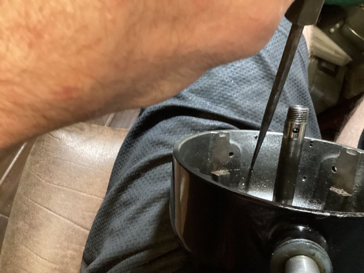

So here’s what you do.A long sharp punch.Mine is actually a Utility Punch Scriber before I’m corrected.I found out on the first one is if you go straight on the center it will mushroom the stud and it’s stuck.I came in at an angle and hit the outer edge of the stud and it knocked into the hole.At that point I just hit it straight on and they popped right out.The buggered hole to top left was my first attempt ,the rest came out clean
Thought I would pass that on.
Oh and I did it in my lap just like the pics.Not too hard but solid taps.

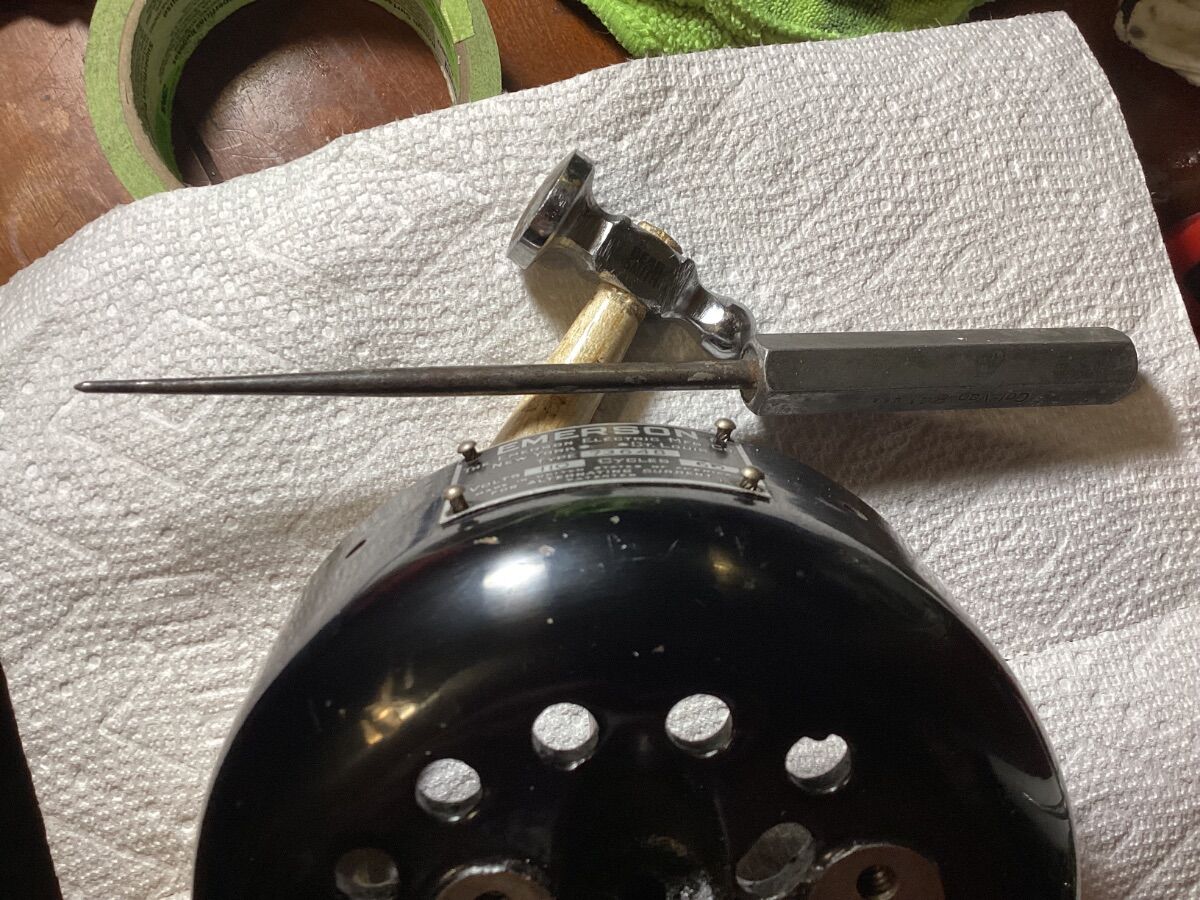

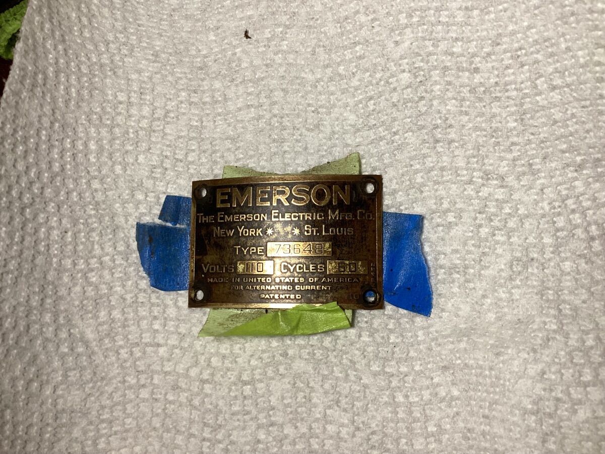

I did another in less than a minute.Its the long punch that is the trick.The tape is just to keep from losing rivets.Also undamaged.The rivets we’re longer on this one so I lightly tapped them flush before punch.

I actually started with the center punch and it will and did wedge the rivets in harder if it doesn’t hit straight on with the limited space in the rear.Thats when I used the long punch.Jims method grinding to a point would work better  as far as the center punch I’m sure.

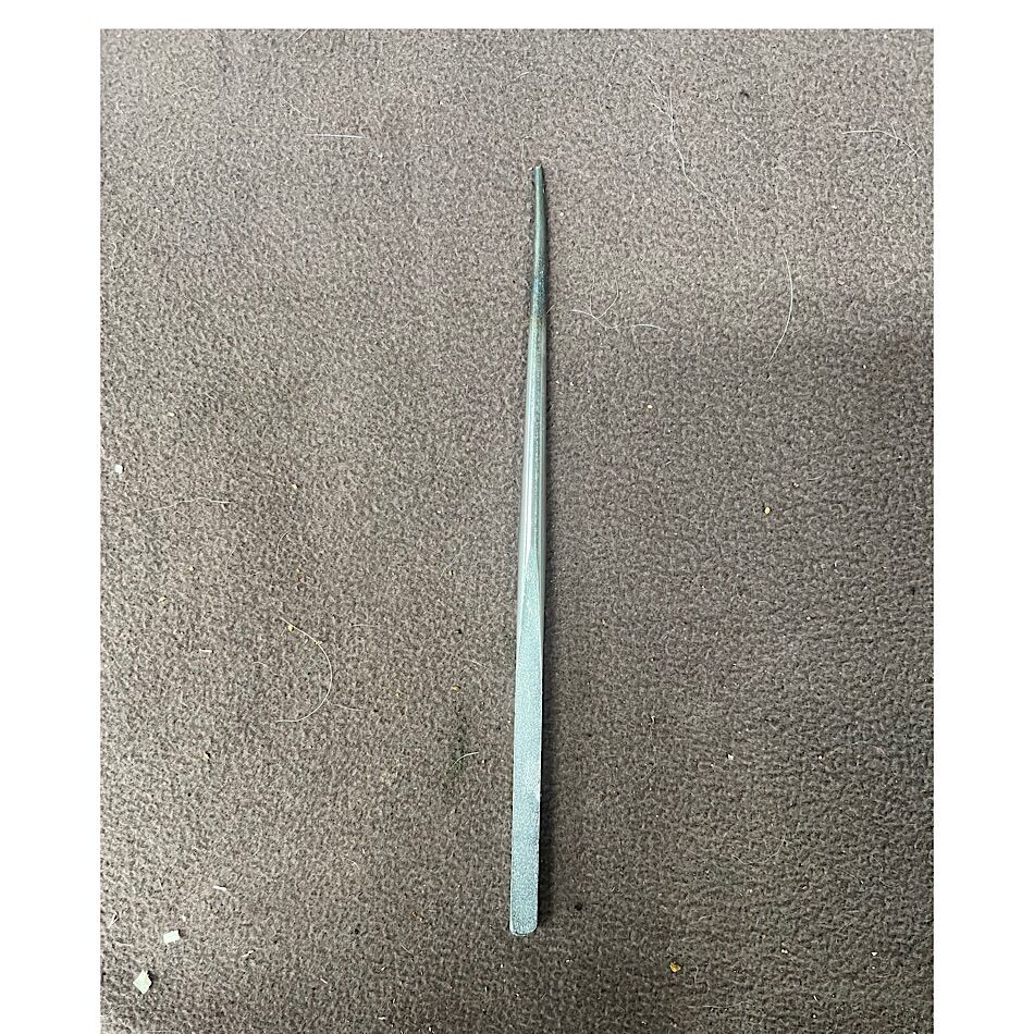

I use a long punch that a ground the tip to a fine point.

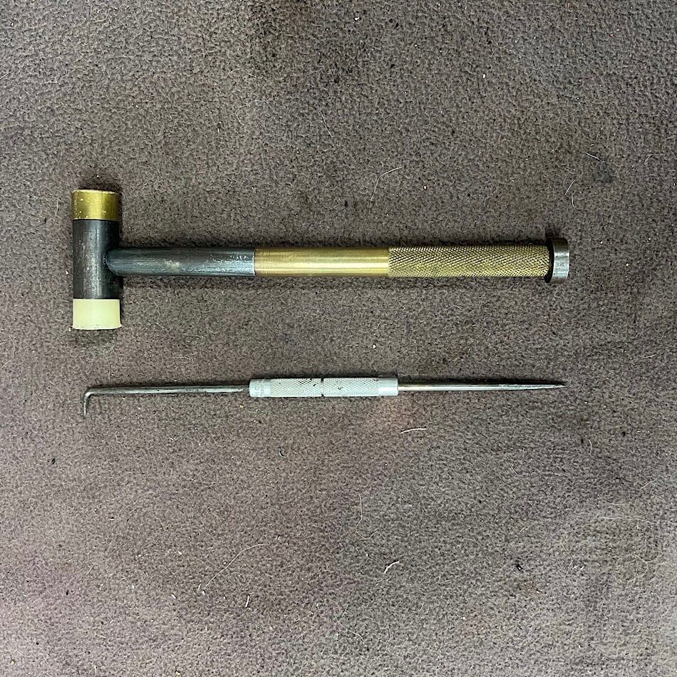

Been using an old double ended pick for a while now.  I use the small 90 degree end first then the straight section. Works well with a small hammer.  I’ve also use a long punch I had that I heated and bent the end slightly to make the job easier.  I use the appropriate one for the size of the motor casing.
