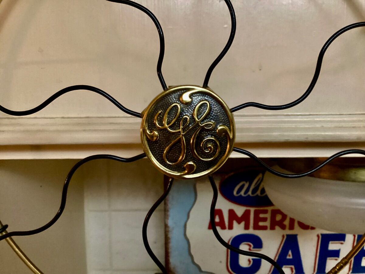

Marc Sova Posted July 13, 2024 Posted July 13, 2024 (edited) How were inventory tags typically finished? Trying to decide if I should put black in this inventory tag like the motor tag?….or just leave it solid brass. I couldn’t tell how it was originally. I’m leaning towards just solid brass. It sort of looks like there’s black in the before photo but the ivory fab was overpainted black many years ago maybe in the 1940’s when a machine shop acquired it. Edited July 15, 2024 by Marc Sova Quote

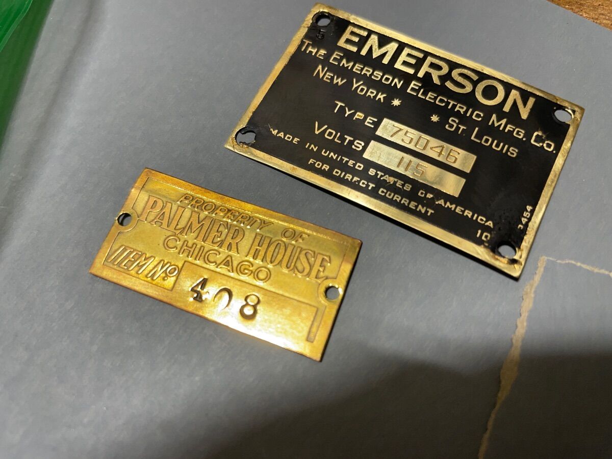

Marc Sova Posted July 15, 2024 Author Posted July 15, 2024 3 minutes ago, Patrick Ray said: Wish I had a pic of one I've done. But you can split the difference. I've used brass aging solution on tags and darkened the background then polishing the high spots. You can control how aged the brass becomes to choose your level of highlighting. Not as sharp of a contrast as brass against black paint. But it creates a nice contrast. Oh wow thanks. I’ll have to get some of this to have on hand. Yeah I think I’ve decided I’m going to leave the inventory tag raw brass. But maybe I’ll use this on it to speed the natural process. I like the idea of the background being a little darker….but I definitely don’t want the background dark black like the motor tag I just restored as seen in pic. I think that will look horrible mounted on the ivory strut. And I don’t think it was that black to begin with. Honestly I would’nt be surprised if it was originally just brass without the oxide in the recesses. I just dont know if they would’ve went through the extra finishing process for something that was just a very small tag for the purpose of having a number stamped in it by a janitor or whatever. As much as I like how my motor tag turned out (not perfect but not bad for my first ever and considering I jacked the corners up removing it) I think a black oxide would look way better. Not su “painted”. Quote

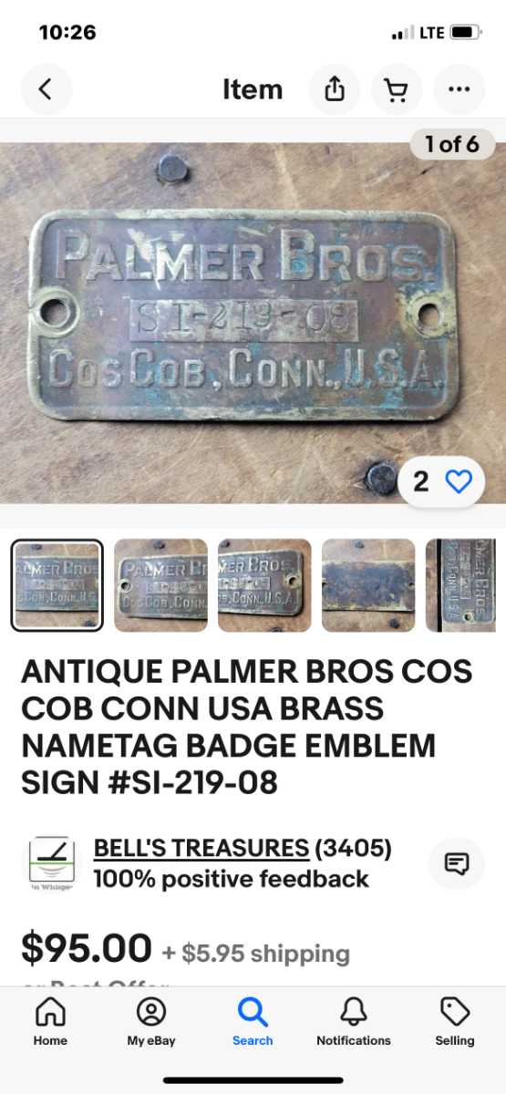

Marc Sova Posted July 15, 2024 Author Posted July 15, 2024 Also…,I did find this online….its not from the planet house but it appears to be a similar sized sort of inventory tag but does appear to have the oxide in the low spots. But certainly not to the degree of looking heavy black. Quote
