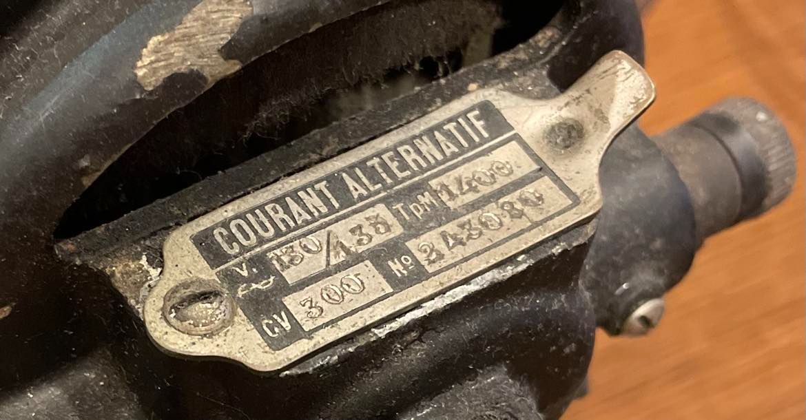

Martinot Tag
Trying to figure out if the 130/133 is Volts/Cycles.     It looks like the Cycle symbol under the V.
opinions?
That is the sine wave symbol for Hertz; indeed that is a 130 Volt 133 Hz motor.
Edited by Paul Michael
typo
1 hour ago, Paul Michael said:
That is the sine wave symbol for Hertz; indeed that is a a30 Volt 133 Hz motor.
Thumbup.gif.4798e76b8fc381abeee9d072496a6f33.gif  130V, 133Hz...
Since it's a series motor,...
it'll run just fine on bridge
rectified 120V~ 60Hz.
I have a similar situation. Regarding the bridge rectifier, you indicate a 120V rating is sufficient. What amp rating would you suggest?
Would going with a higher rating than 120V cause any harm?
opinions?

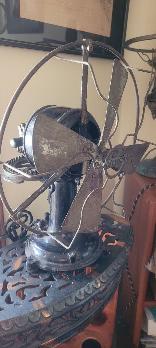

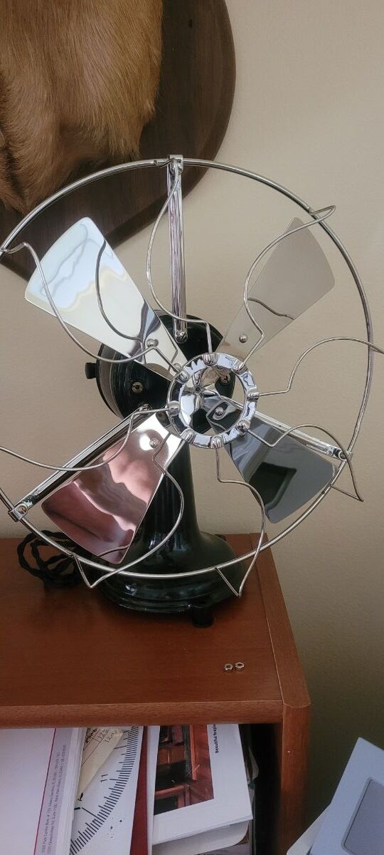

Hey Anthony, is this 10" or 12" fan?
And as a veteran motor winder once said “Half the voltage, half the cycles.” But I’d go with the what Jim said.
I did not get that one but I have 2 Martinot fans.  12" stationary and 10" oscillator
