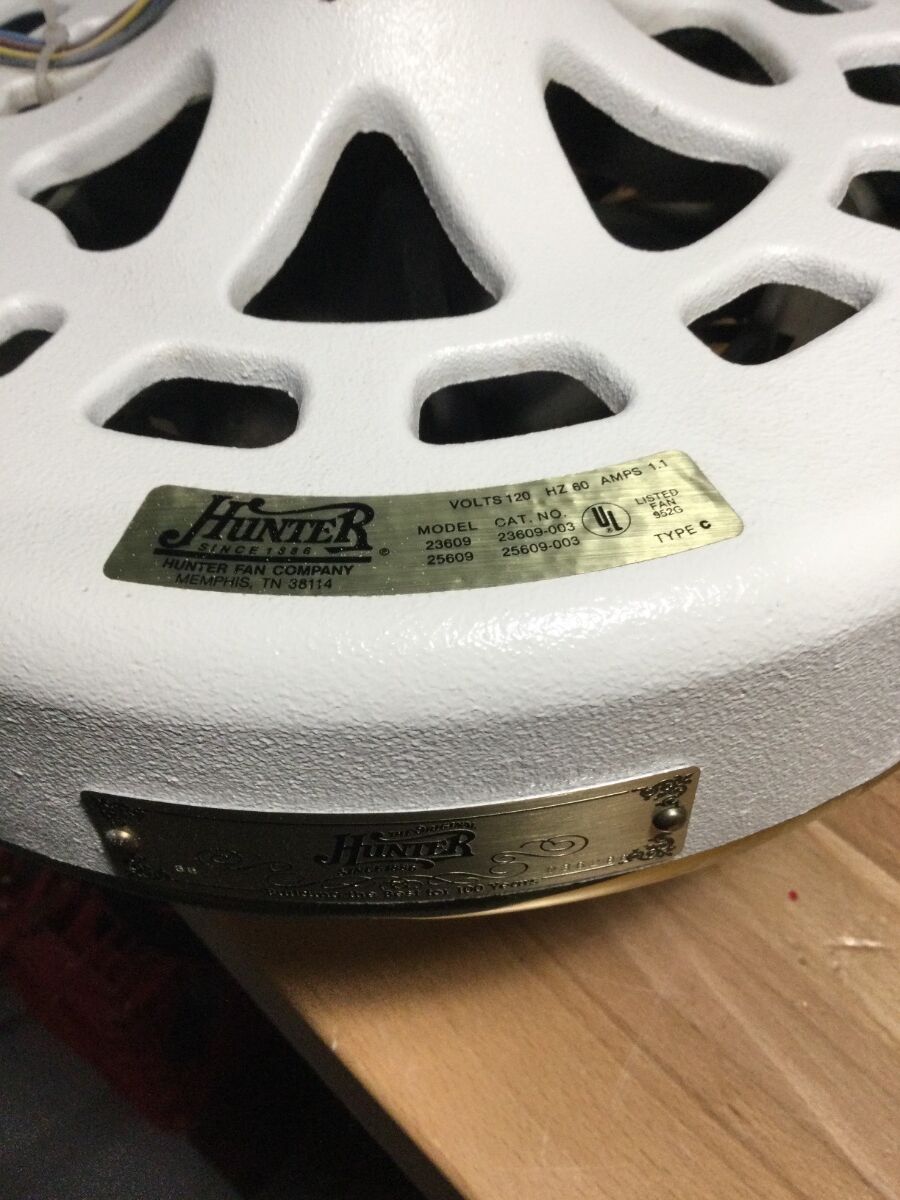

Looking for mfg. date as well  any other information on this hunter ceiling fan I purchased at flea market. Thanks!
Later model original before they went to the junk motor.
I think I see an "88" stamped on the left side of the Hunter tag, making it a 1988 model.  This fan uses an efficient 1.1 Amp PSC motor.  A solid fan, and a great runner.
I do see a number 88 on tag ; thanks for the help !
