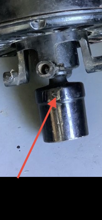

Louis Weedman Posted February 14, 2023 Posted February 14, 2023 Where are you located? I have a bunch of ceiling fans from that era, but most of them need restoration. Quite a few have threaded holes where you can add your own light attachments. Either that, or they can have a fitter for a schoolhouse globe. 1 Quote
Evan Atkinson Posted February 14, 2023 Posted February 14, 2023 (edited) Congratulations on the purchase of your first home. 1920's ceiling fans are in plentiful supply (with some exceptions) and are generally cheap to buy and have tank-like reliability with the proper maintenance. The only truly "factory" integrated light solution (for most of these) may well have been in the form of an enlarged, trumpet-shaped light fitter and a schoolhouse globe, attached to a slightly modified oil cup/switch housing. Anything fancier was usually a special order (per the customer's wishes) and assembled at the dealer level, not factory. So as Louis said, most of these 1920's ceiling fans (Century, R&M, Hunter, Diehl, GE, etc) had threaded plugs on the "nose" of the fan (really the bearing cover/oil well/switch housing assemblies), plugs that could be removed, and short threaded stems with light sockets installed. Glass was always the customer's own preferred choice, whatever was available at the dealer. Some models (the Westy sidewinder) even had more than four plugs in the faceplate where one could install multiple stems and sockets. You'll probably want to control these fans with a variable-speed wall control, rated for the amp draw of the fan. Edited February 14, 2023 by Evan Atkinson Quote

Evan Atkinson Posted February 24, 2023 Posted February 24, 2023 (edited) On 2/22/2023 at 9:28 AM, Levi Mevis said: I can't tell in the pictures, but are any of these fans able to have a light fixture added to them? And I'll see if I can shoot an offer to one of them. They both should allow you to stub-out small 1/4" or 3/8"?? pipes from the threaded plugs on the switch housings. You can add sockets and shades to these. Edited February 24, 2023 by Evan Atkinson Quote
