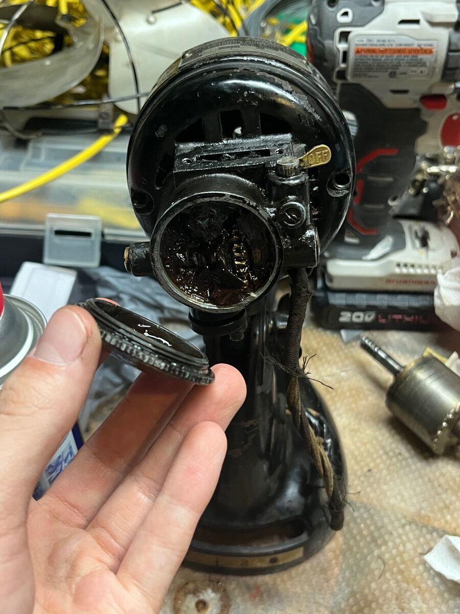

Alex Koh Posted March 19, 2023 Posted March 19, 2023 I'm new to working on these later Century fans. Is there a way to open the gearbox on both of them without destroying the pot metal? Quote
Stan Adams Posted March 19, 2023 Posted March 19, 2023 If that rear cap doesn't screw off by hand, then no. I have owned both of those same model fans in the past & both of them turned into basket cases. 1 Quote
Alex Koh Posted March 20, 2023 Author Posted March 20, 2023 13 hours ago, Stan Adams said: If that rear cap doesn't screw off by hand, then no. I have owned both of those same model fans in the past & both of them turned into basket cases. Do you remember which way the cap unscrews? Quote
Stan Adams Posted March 20, 2023 Posted March 20, 2023 Been a very long time, but quite certain it is CCW Quote
Alex Koh Posted March 21, 2023 Author Posted March 21, 2023 I'm not too sure where to go from here. I started chipping away at the rubber gasket that in between the cap and tried soaking it in penetrating oil and the cap won't budge. Quote
Jim Henderson Posted March 21, 2023 Posted March 21, 2023 The pot metal threads are probably fused and distorted. Quote
Alex Koh Posted March 23, 2023 Author Posted March 23, 2023 Sucess. Turns out the rubber trim was the problem, after picking away at it and sitting the back cap in a pool of WD40 it broke loose. The cap is still perfectly intact. Quote

Alex Koh Posted March 23, 2023 Author Posted March 23, 2023 12 hours ago, Anthony Lindsey said: you should run to the store and buy a lottery ticket. Sadly that luck may not work again for the second century. Somebody tried opening it with a tool and damaged the cap a bit. I’ll still give it a try in the future but I’m expecting it to fall apart. Quote

Alex Koh Posted May 23, 2024 Author Posted May 23, 2024 I decided to try my luck at the second one and I managed to get the cap off. It’s a little tight to screw on but the threads are perfect. Quote
