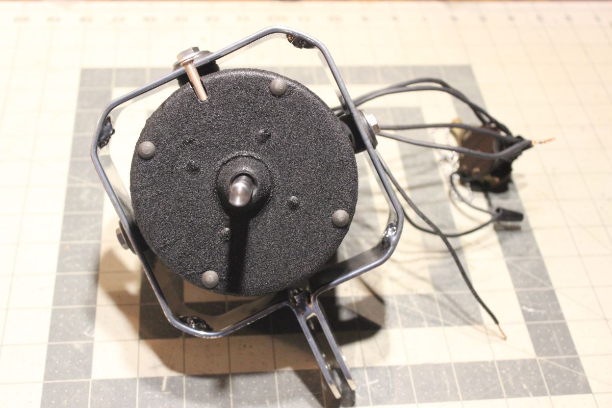

When I realized the original motor was a trainwreck, I just couldn't scrap the rest. It took some time, but I finally located a vintage motor appropriate for it brand new still in the box on the web.  I picked up all the stainless-steel hardware to slap it together last night. I have to fabricate front and rear motor bearing oil tubes.  Next step is putting together the 3-speed pull chain levolier switch for it. I have the stuff, just need to clean and rewire it.
IMG_2357.thumb.JPG.93c8509216612cdd45216b2948901d17.jpg.2913921655fb174818bfac63dabee680.jpg
This is one of the most challenging circulator projects I have ever done. It is no mystery to me why so few, if only the one exists.  It literally takes 2 people (4 hands and patience) to assemble the fan head with guard. My brother and I did this yesterday. The motor frame with motor/speed control/levolier, front cast cover, stamped rear motor cover, and guard have to be assembled aligning holes on each at one time.  It's coming together and looking much better than when it came to me, but I have a machining issue obstacle in the way of the last step to finish it. I anticipate next week I should have pictures.
186300719_InternationalAirCirculators.thumb.jpg.fd182a0b0770cec646a59e66d687d569.jpg.df5a7ae9558d560809bff45586a48222.jpg

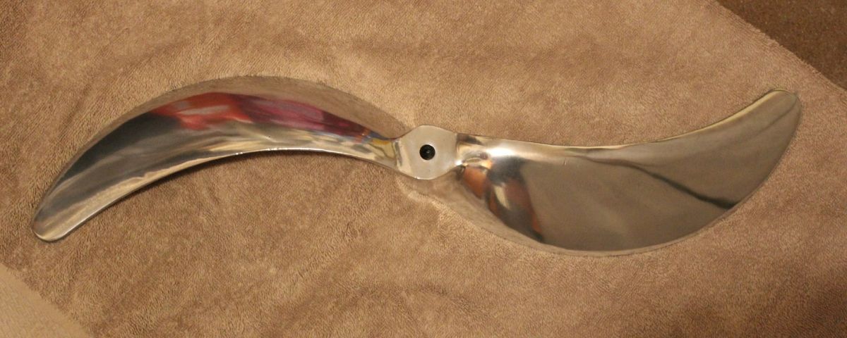

The rotor shaft diameter on the Ballentine motor was an unusual 27/64", or .422 diameter.  I purchased the new Dayton motor because it had a 3/8" shaft diameter. I took the blade to a local machinist today and had him bore out the original unusual Ballentine shaft diameter size from 27/64" to 7/16" on the blade hub. This way I was able to order and use a slotted shaft reducer bushing with 3'8" ID and 7/16" OD to mount the blade securely to the 3/8" shaft.
