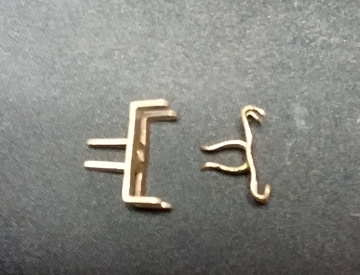

Louis Luu Posted May 9, 2023 Posted May 9, 2023 I'll be getting a hold of an original from Vic Valencheck. They should be relatively easy to draw up and printed in brass. Thank you Vic. 1 Quote
Doug Wendel Posted May 9, 2023 Posted May 9, 2023 If you had the pattern or sample to work from, it looks like it cut just be cut out of sheet brass and folded to shape. Quote
Louis Luu Posted May 9, 2023 Posted May 9, 2023 41 minutes ago, Doug Wendel said: If you had the pattern or sample to work from, it looks like it cut just be cut out of sheet brass and folded to shape. You are correct. My only problem....my fingers are fat and clumsy. With CAD and printing....this will save me the hassle. Quote

Vic Valencheck Posted May 9, 2023 Posted May 9, 2023 Louis, I'm sending the clip out today. Hope it works out for you. 1 Quote

Louis Luu Posted May 13, 2023 Posted May 13, 2023 I can see why these would be a pain to cut by hand...really tiny. I will see if I can have it preform so there is less bending necessary. Quote

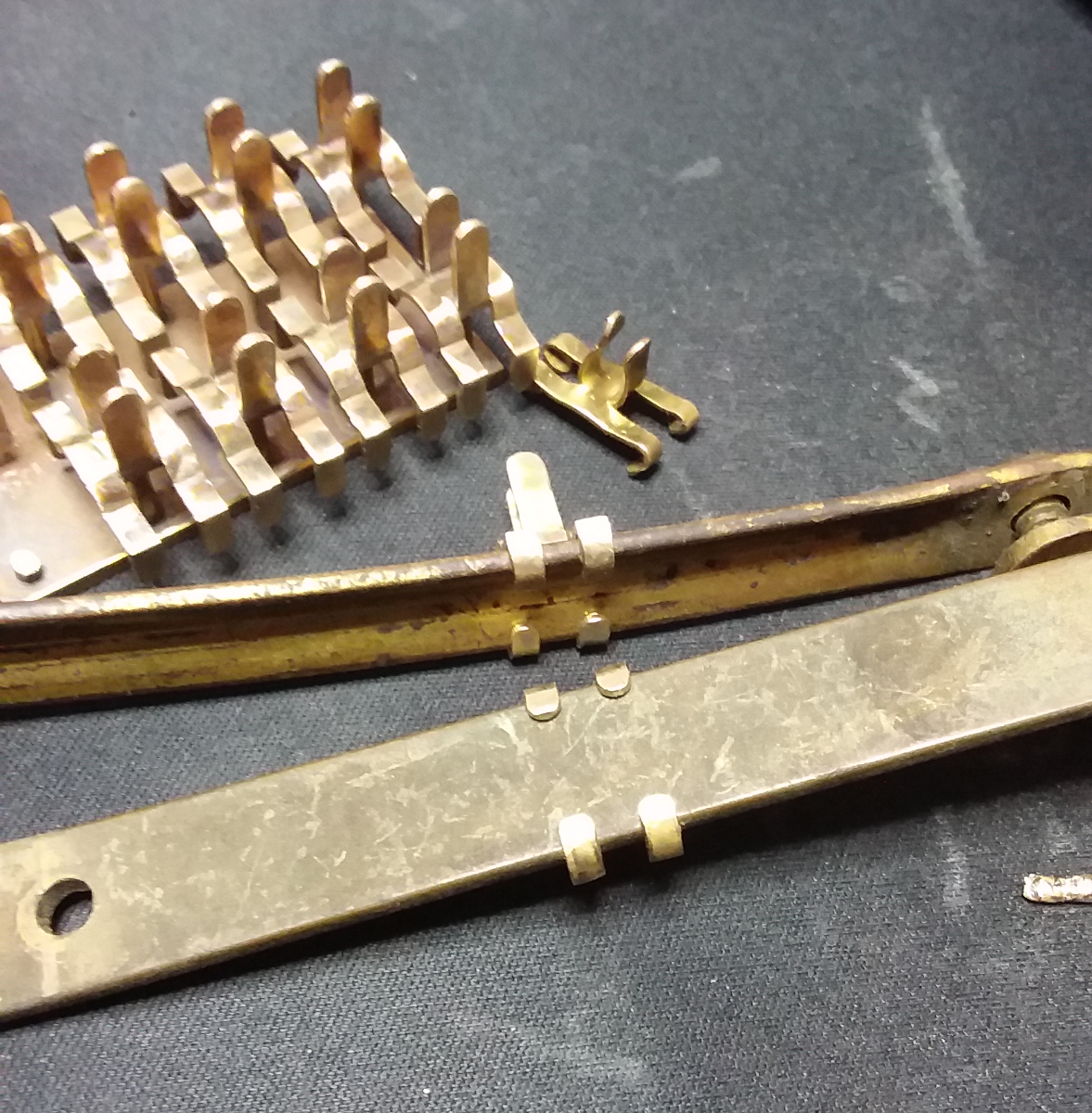

Louis Luu Posted May 19, 2023 Posted May 19, 2023 (edited) I'll be drawing them up this weekend and will order end of the month. I have studies the Jandus C-frame struts. The struts came in two styles...flat and the typical GE with the back middle curve ones....need to make both styles. Please post here if interested so I have a rough idea how many to order....Thanks. Also, it turns out there are two types of styles for the Jandus C-Frame struts. Ones that have the curve in the front and ones that are curved backwards. I will need to make both so the clip fits on the struts. The curve on these struts face front. Note how the struts attaches to the motor The curve on these struts face back. Note how the struts attaches to the motor. Edited May 19, 2023 by Louis Luu Quote

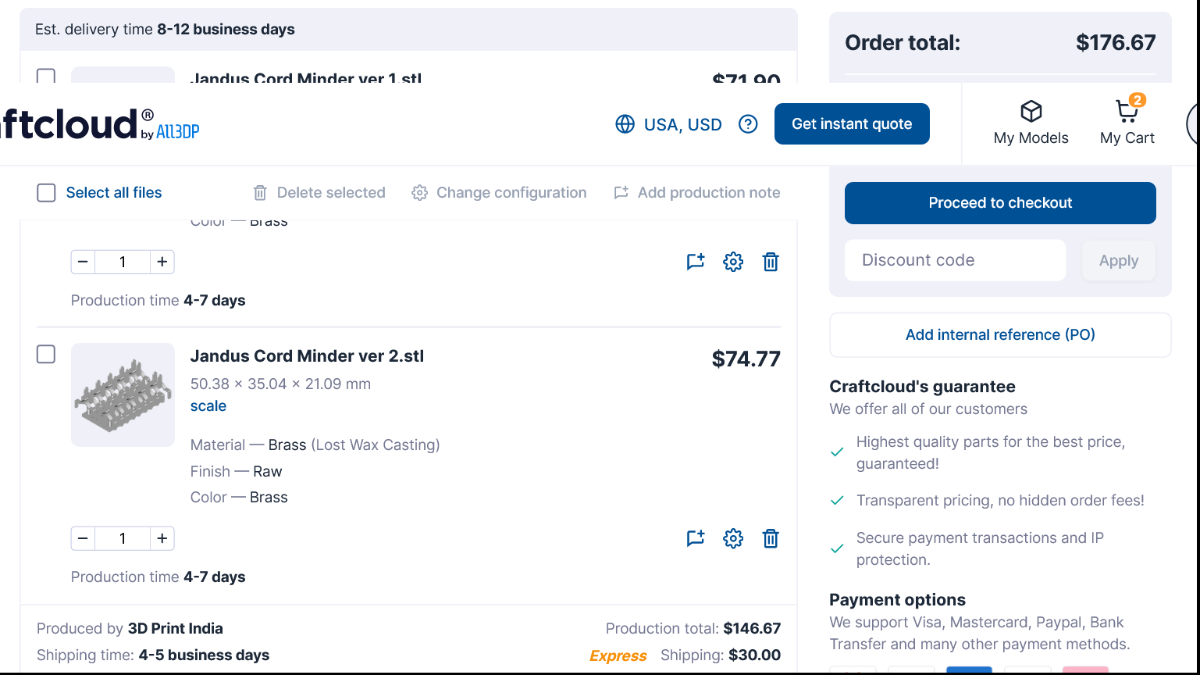

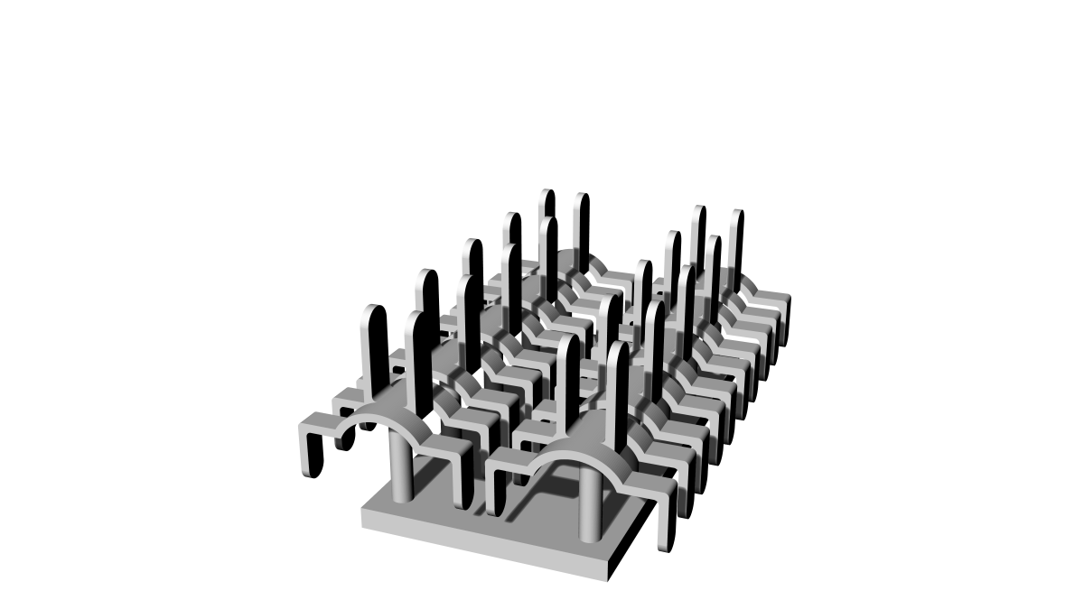

Louis Luu Posted July 14, 2023 Posted July 14, 2023 Order placed. Should be interesting to see if scaffolding in brass can be done. Yes, cost has gone up a bit, so only do this one time. Price will be around between $15-20 shipped. Only reason I trying this project out is to see how thin I can get it and if scaffolding on a large scale works. If this does pan out, I will proceed with the Emerson back oiler. Quote
Louis Luu Posted July 14, 2023 Posted July 14, 2023 I ordered a total of 20 (10 of each version). If you have already placed order here, I will reserve. If you need extra, please order now. Only one time as I don't see a lot of demands for this. Quote
Louis Luu Posted July 14, 2023 Posted July 14, 2023 As for the challenge of printing/casting in brass. The minimum thickness is 0.6mm...really pushing it. I measured the thickness of the material of Vic's original cord minder and it is 0.8mm. The problem with this is normally it is not scaffold. The only reasons to scaffold: If you were to print each piece, the cost adds up real quick. The benefits of scaffolding is also accuracy as it treats the object as one large piece. Printing tiny piece/casting is very problematic. Quote
