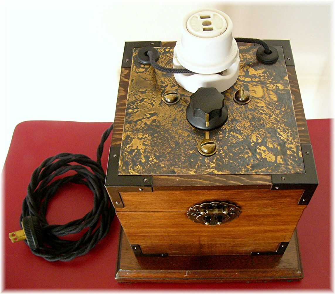

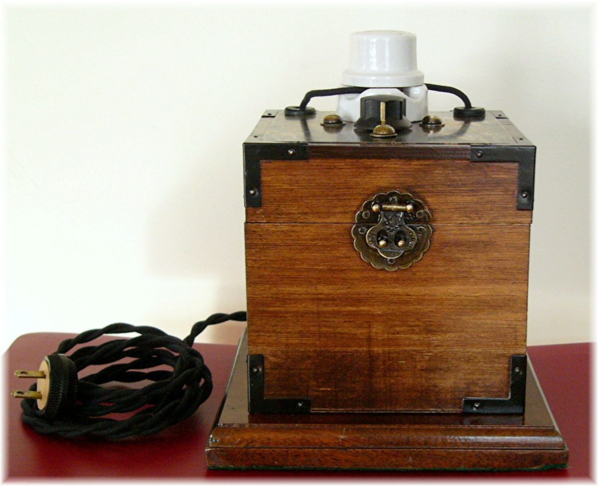

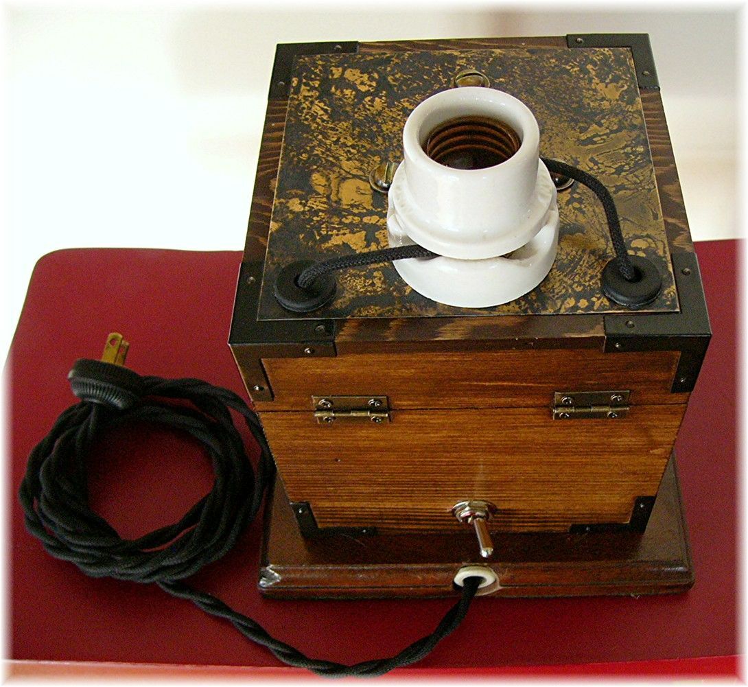

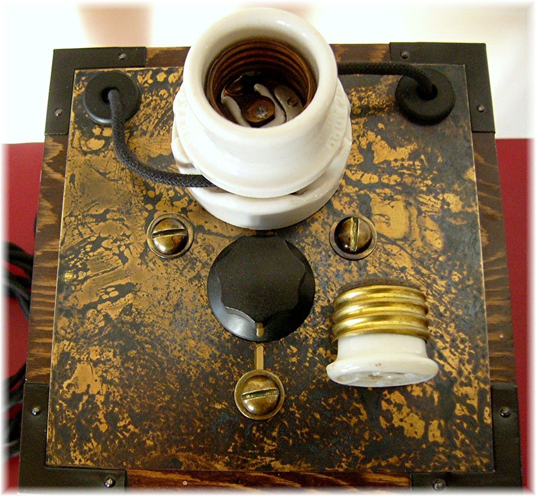

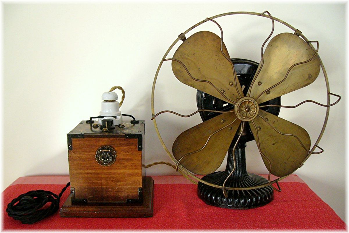

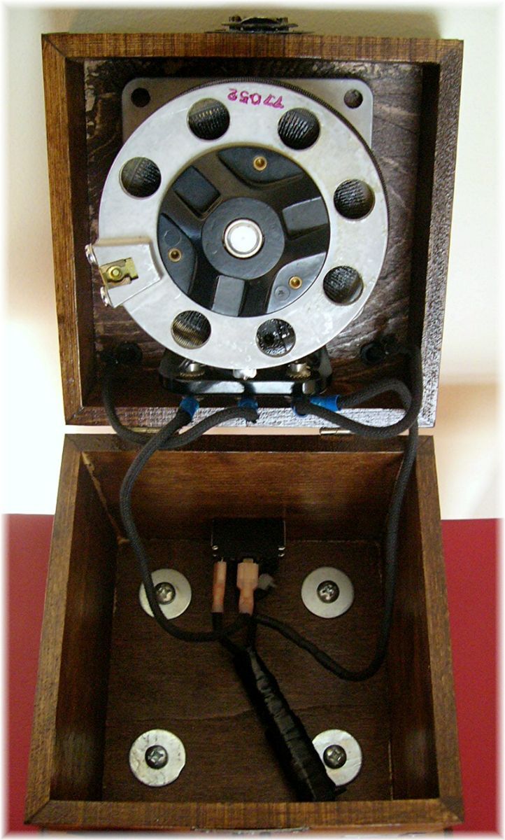

Russ Huber Posted May 27, 2024 Posted May 27, 2024 (edited) A variable transformer I built for operating a Tesla fan motor on 100 VAC. All you would have to do is put a full wave bridge rectifier inline to the AC output. You could actually toggle (two position/center off) the output of the variac transformer alternative AC or DC current to the outlet on the box. I bought an exposed 3.5 - 4.5 AMP variac off of Ebay to build it. I had it fused as well if you look inside. The box came from Hobby Lobby mounted on an old wooden plaque I had. The sheet brass came from a trophy shop, cut by them to size. I used a chemical process for the patina on the brass. Edited May 27, 2024 by Russ Huber 1 Quote
