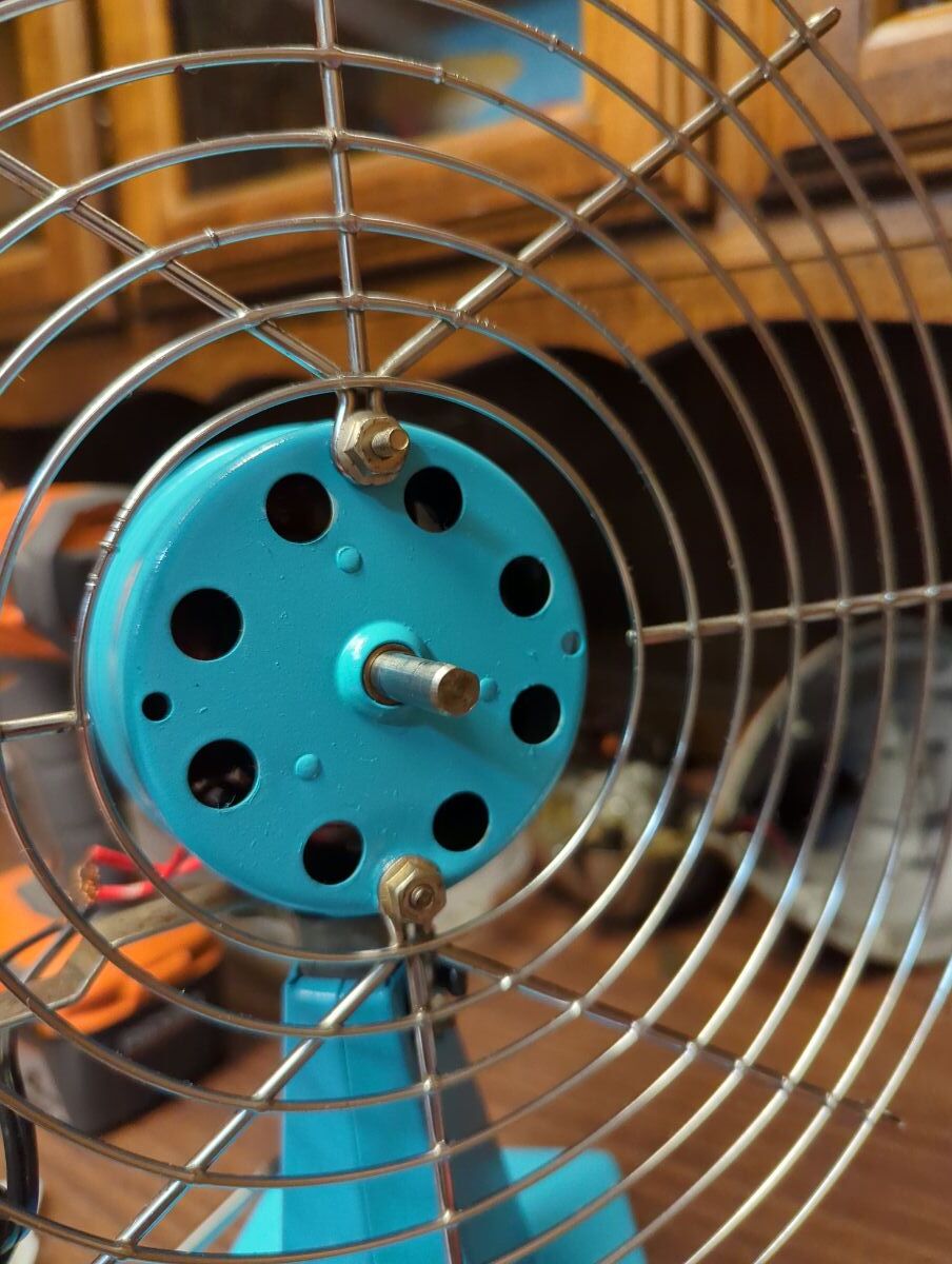

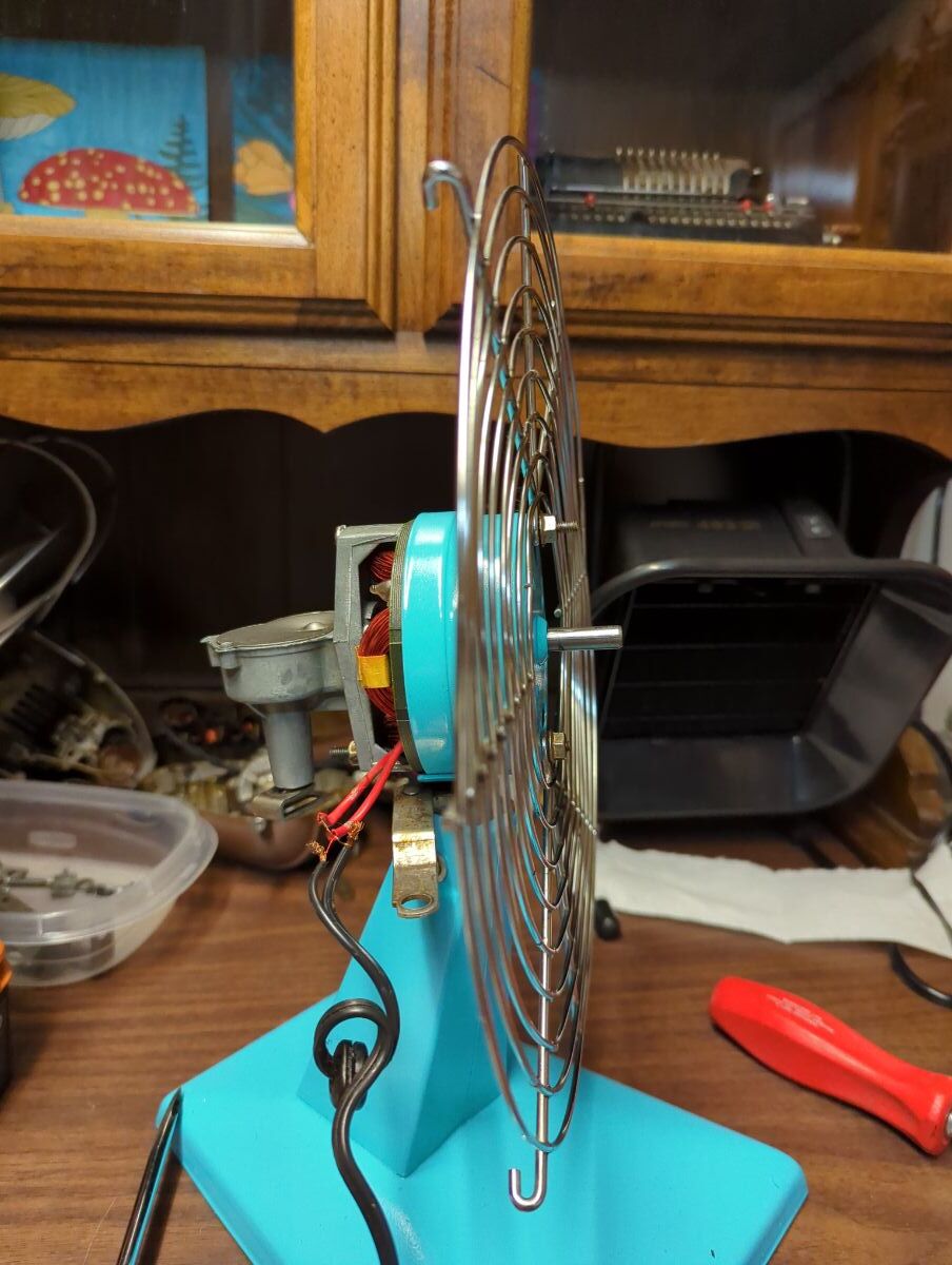

Ok so I have run into this problem several times. Prior to disassembly the fan works fine. After I reassemble the fan the shaft doesn't spin freely or feels sticky. When spun by hand and when power is applied. I used the same amount of spacers and re adjusted the screws several times...
Take the blade off and whack the shaft with a screwdriver handle several times from all sides. If the bearings a the rounded self aligning type, it will knock them into alignment.

To be more specific17196071498652613170968768930640.thumb.jpg.68d55597e0acd07cae0995db62880980.jpg
