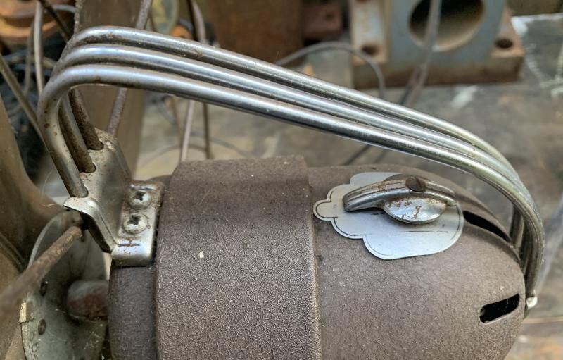

looking for any info on this fan, wiring, switch,       does it have a capacitor's or not?  any info would be greatly helpful.  thanks  in advance.

I believe this fan more than likely is just a simple shaded pole motor, so no there will not be capacitor in it.
More than likely this is either a two or three speed fan, the swiitch is that chrome pointer thingy on the back of the motor housing bell that within the little silver art deco skyscraper decal it would of originally said Off 1 2 or Off 1 2 3 or Off High (Med) Lo(w) but it looks like the speed control lettering (or numbering) has long since worn off.
As for the wiring, if it is just a simple shaded pole motor, it will just have a 2-wire headwire, and with that setup you just wire one side straight to the motor from the power cord and the other side to the switch.
