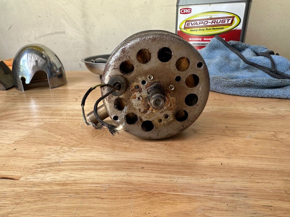

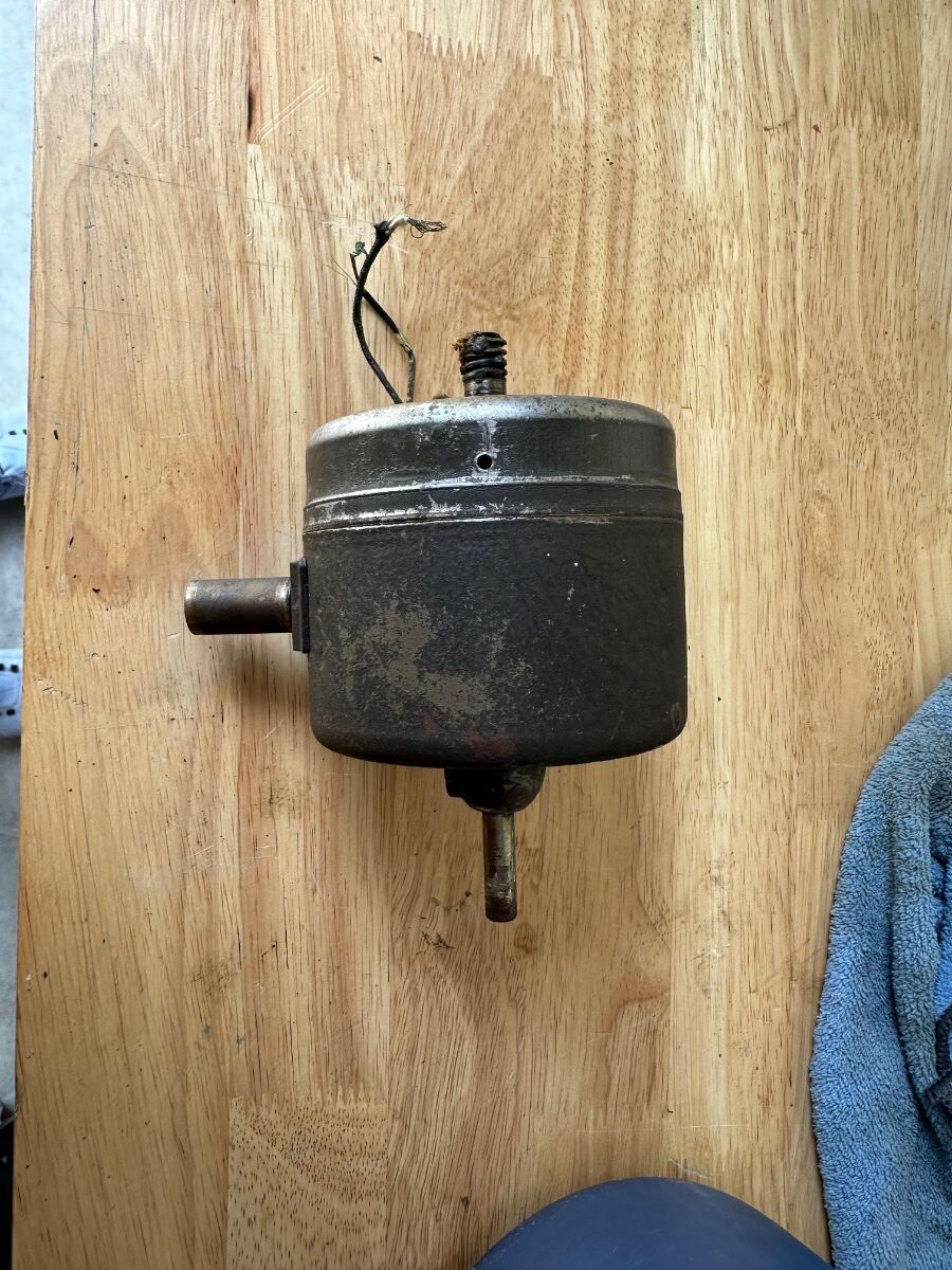

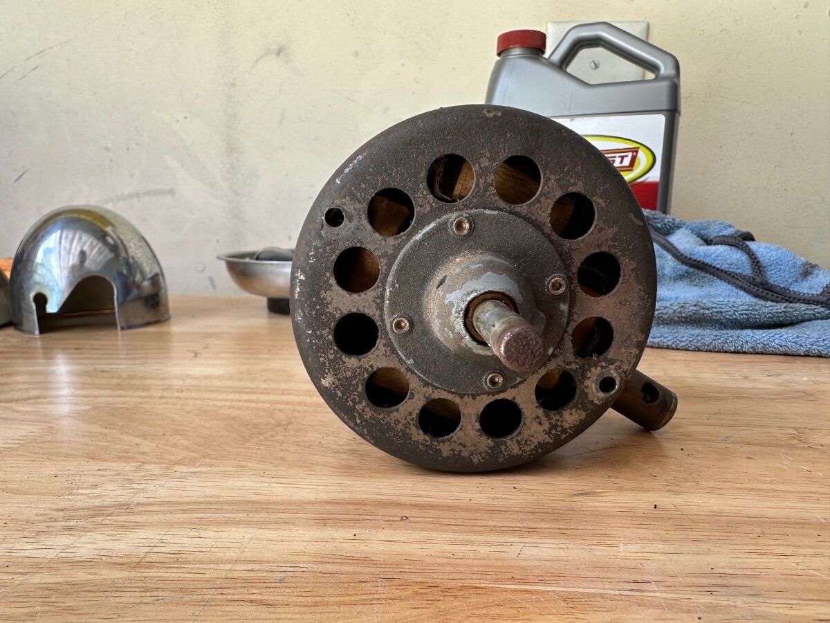

Good afternoon. I hope everyone is having a great day. I was going to disassemble this wizard and redo it, but for the life of me, I cannot see where to separate the two pieces of the motor housing anybody have any ideas? I certainly don’t want to mess it up and may just leave it intact and clean it from there.
If you have a fine wire wheel on a bench grinder or hand drill, wire wheel the front rotor shaft clean of rust, crud and metal burrs. Next you simply start tapping the front of the shaft using a RUBBER hammer and watch for the casing starting to open up. Don't beat on it, just give the front shaft some taps. There should be a set screw or two on the worm shaft to release it off the shaft.
