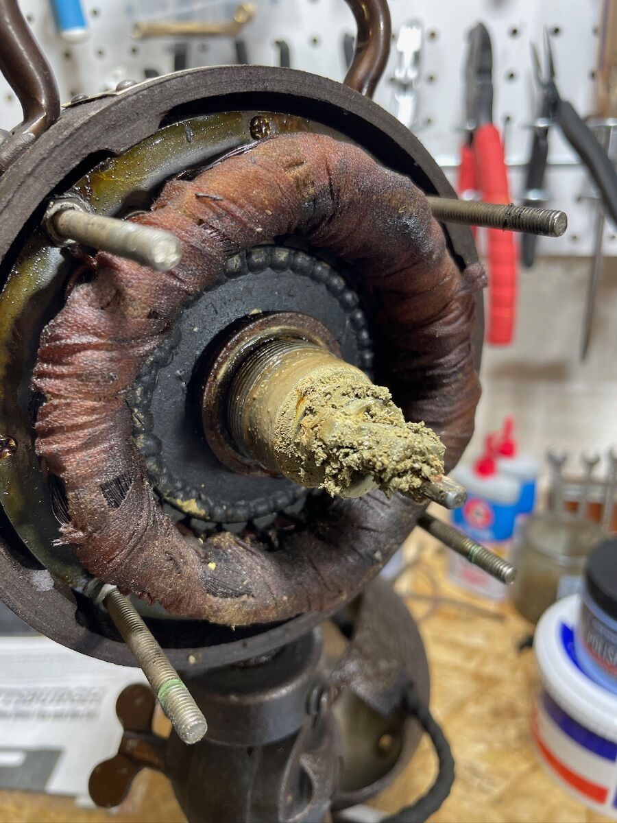

Marc Sova Posted March 22 Posted March 22 On 2/9/2025 at 3:10 PM, Patrick Ray said: For whatever reason, I've found these later Emersons to be more stuck than earlier ones. Just my luck or type of oil used from the factory? 🤷 Who knows. But you can try a heat gun to try and soften the gunk keeping the hub on. Caution! Hub will be hot! Use a pair of good gloves to spin that hub off. Remember: it's reverse threaded! Worst one I ever had was this AN. I’m not sure what the hell someone put in it for oil lol. Maybe spray lithium grease??? Lol. I finally got it cleaned up and running. Quote
