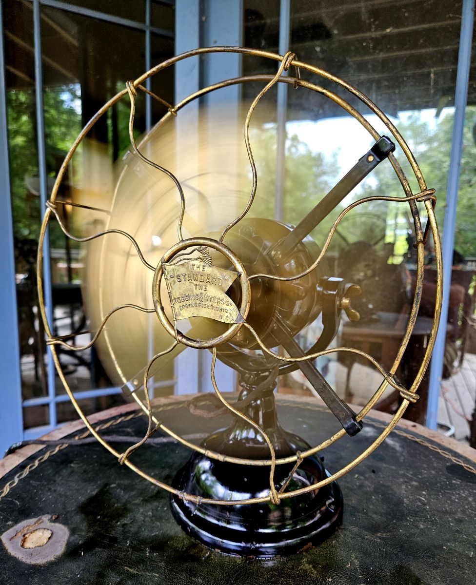

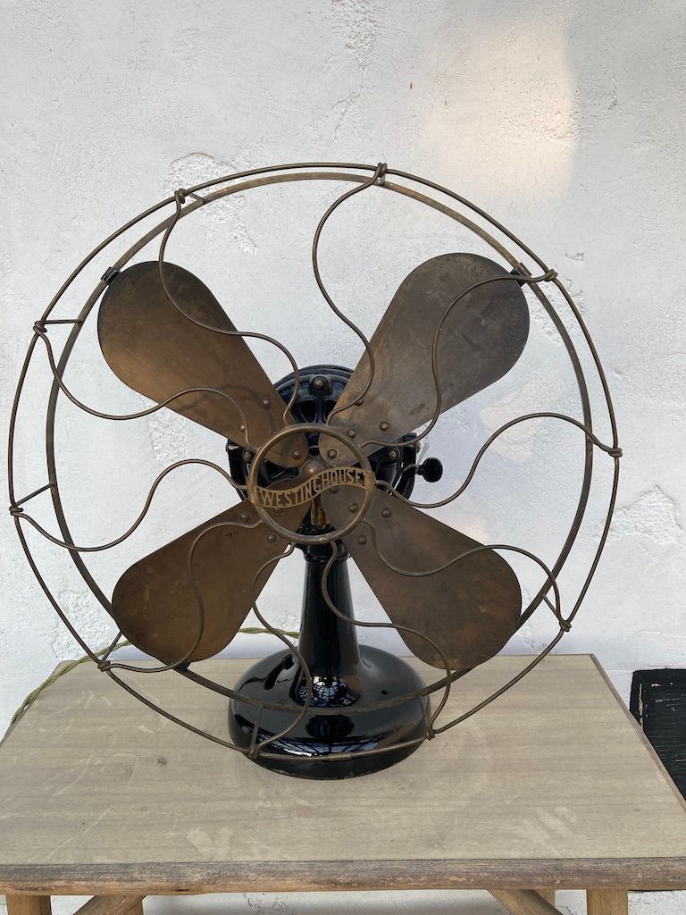

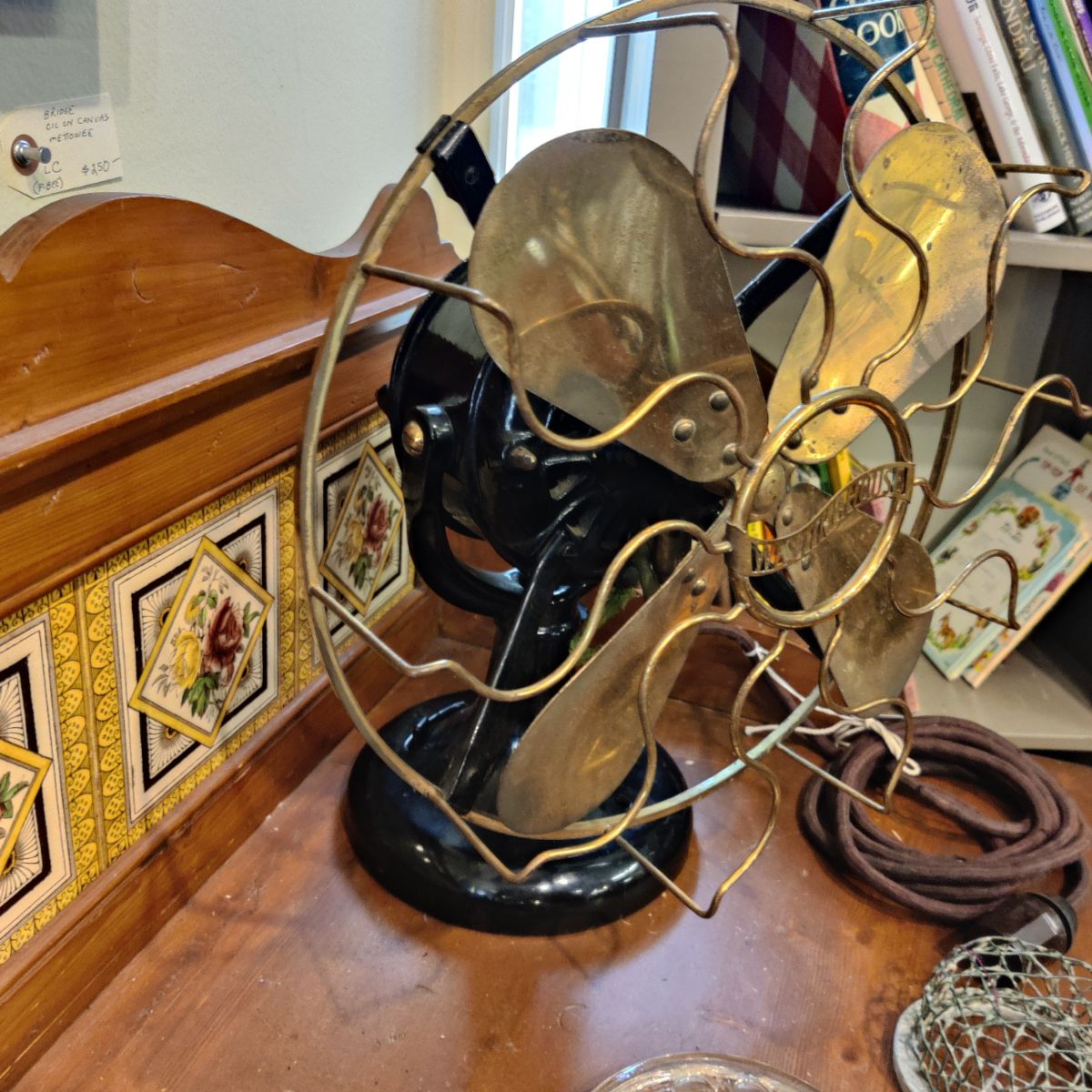

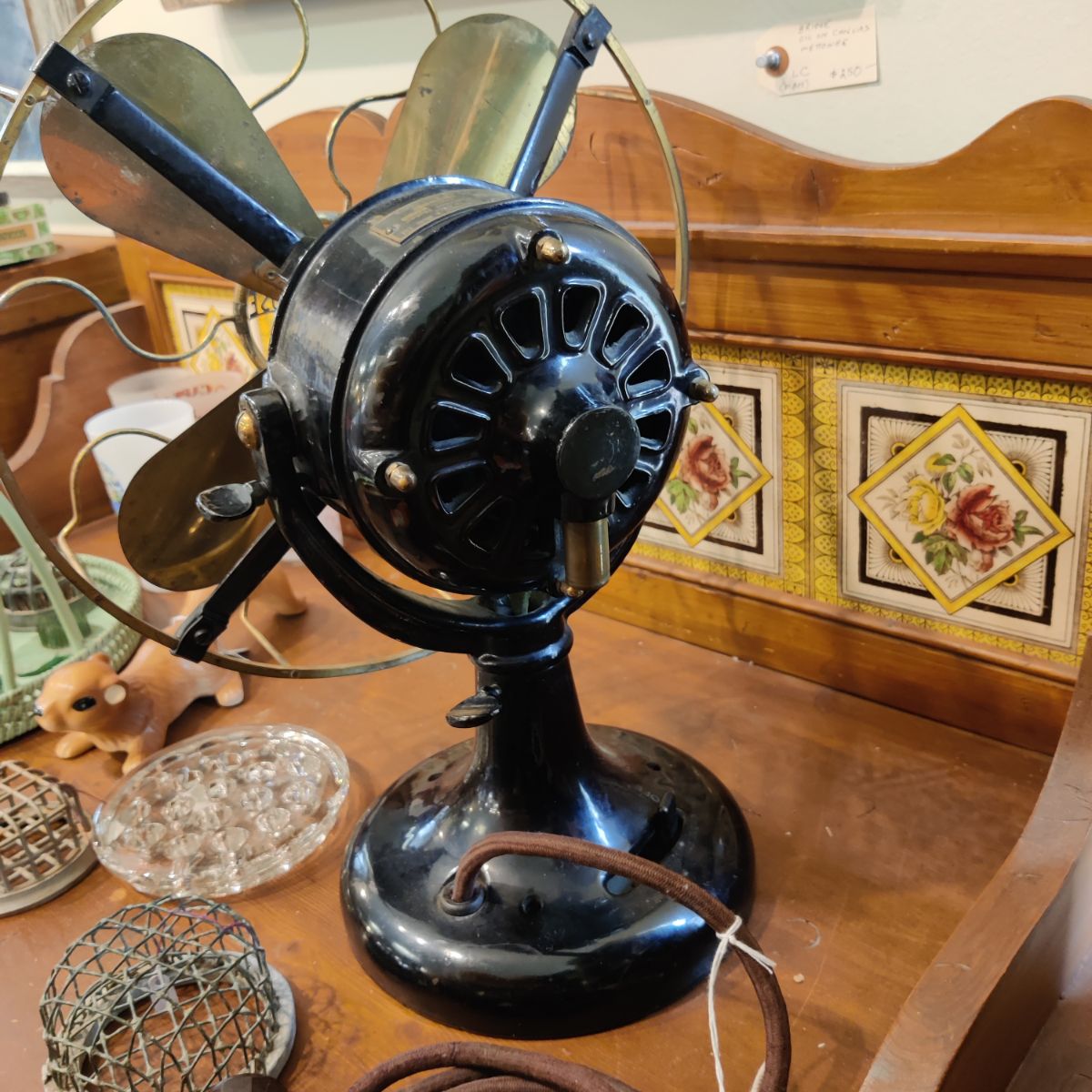

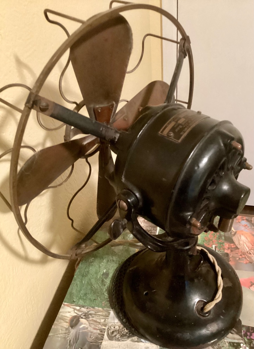

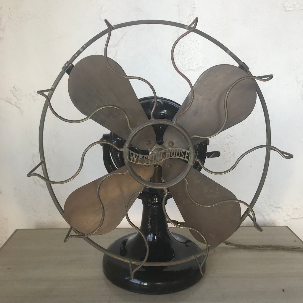

Jay Buchholz Posted August 6, 2023 Posted August 6, 2023 (edited) Hi all! Just brought this Westinghouse home and I've been looking on the site for details on this one and haven't had much luck. I think this qualifies as a "Tank", right? Any way I could find out the year it was made? I'm going to replace the headwire and cord but other than that I think it's beautiful just how it is. Edited August 6, 2023 by Jay Buchholz Photos 1 Quote
Jay Buchholz Posted August 6, 2023 Author Posted August 6, 2023 (edited) Welp, answered my own question. https://www.fancollectors.org/info/mbr/reference/west.htm What makes a Westy considered a Tank? Edited August 6, 2023 by Jay Buchholz Words Quote
Steve Stephens Posted August 6, 2023 Posted August 6, 2023 Hi Jay, you got a very nice example of a fan that I am very fond of. They are "built like a Tank" is where the name came from. Who named it that? That was before my time as a can collector or AFCA member. Great fans and one of the easiest to find of an "early" fan. Make sure the starting switch contacts are clean and they should do great cooling duty. As for the year, I have to refer now to my own blog; earlyfans.com I think your fan is a 1907 or, possibly, a 1908 model. See if the center ring of the cage is solid or rolled and hollow in the middle. I do need to get back to my blog and make corrections and additions. When running your fan be sure it comes up to speed in a short time like several seconds or a bit more and the centrifugal switch cuts out our you can risk burning out the starting circuit. If you hear continual gentile scraping unplug and find out why it is not coming up to speed. And, specifically, this entry: https://earlyfans.blogspot.com/2011/03/westinghouse-tank-1905-1911.html 1 2 Quote

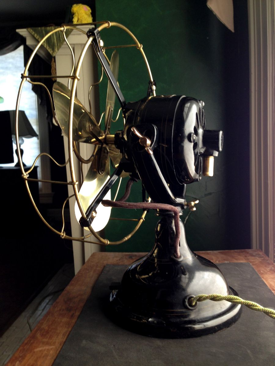

Dave McManaman Posted August 6, 2023 Posted August 6, 2023 That’s gorgeous! On the headwire, I got a beautiful, almost neon, green wire from Tony Clayton and then a tan cord with dark tick in it for the cord. It just took things to a different level in my book. Congrats on the great find! 1 Quote
Jay Buchholz Posted August 6, 2023 Author Posted August 6, 2023 1 hour ago, Dave McManaman said: That’s gorgeous! On the headwire, I got a beautiful, almost neon, green wire from Tony Clayton and then a tan cord with dark tick in it for the cord. It just took things to a different level in my book. Congrats on the great find! Thanks for the kind words! Would you mind posting a picture or two of yours with those new wires? I'll look up Tony Clayton and do some shopping soon. 😁 Quote

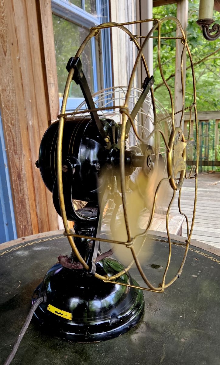

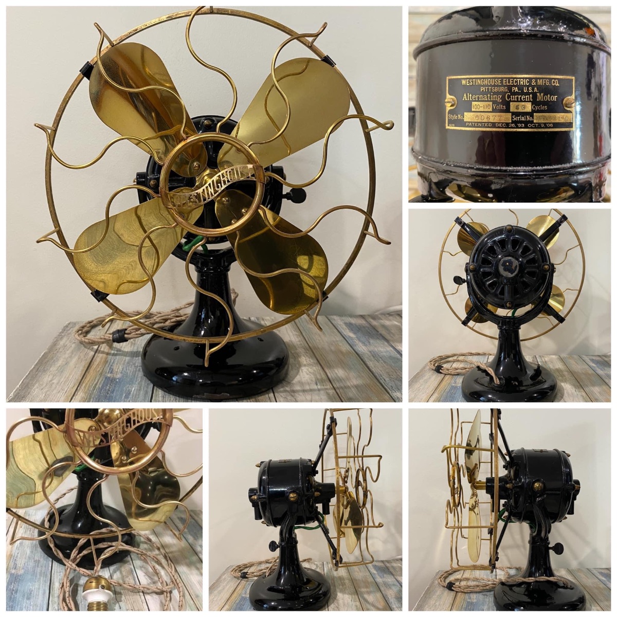

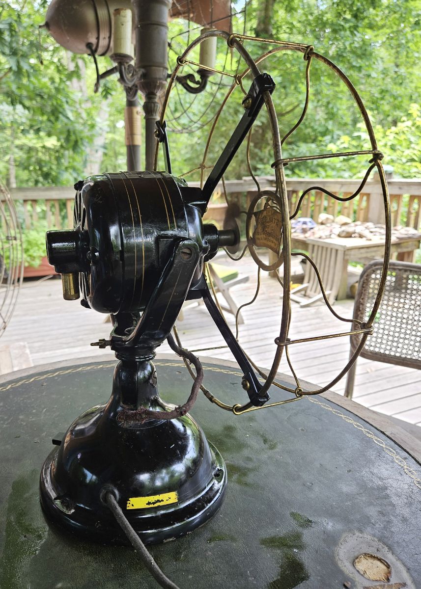

Dave McManaman Posted August 6, 2023 Posted August 6, 2023 58 minutes ago, Jay Buchholz said: Thanks for the kind words! Would you mind posting a picture or two of yours with those new wires? I'll look up Tony Clayton and do some shopping soon. 😁 You can kind of see the green wire peeking through. 2 Quote

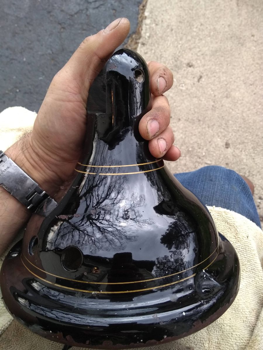

Jay Buchholz Posted August 6, 2023 Author Posted August 6, 2023 2 hours ago, Dave McManaman said: You can kind of see the green wire peeking through. She's a beauty, thanks for sharing! Is there a recommended product or method for cleaning up the japanning? I've sprayed or powder coated most of my fans but I really want to keep this one original since it's in such nice shape. Quote
Dave McManaman Posted August 6, 2023 Posted August 6, 2023 I used acetone on an old cotton tshirt to get the decades of environmental gunk off. Japan can take a lot! 1 Quote
Paul Carmody Posted August 6, 2023 Posted August 6, 2023 (edited) I left mine all natural other than an internal cleaning and service.It can run all night and day and only get slightly warm. I like them either way.If I get another ,shades will be necessary to look upon it. Edited August 6, 2023 by Paul Carmody 2 Quote
Patrick Ray Posted August 6, 2023 Posted August 6, 2023 I've had very good luck with buffing the Japan. Makes it shine like new again. I have a cordless buffer with 3"pads that I use along with Chemical Guys automotive compounds and waxes. 3 Quote
Patrick Ray Posted August 6, 2023 Posted August 6, 2023 I wrote about some of the process here: https://new.afcaforum.com/index.php?/topic/1039-cleanup-on-a-21666/#comment-6517 1 Quote

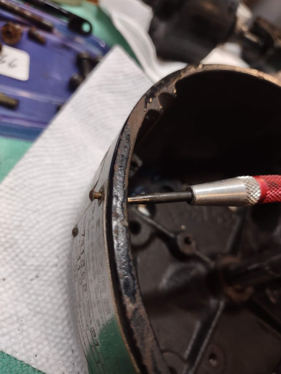

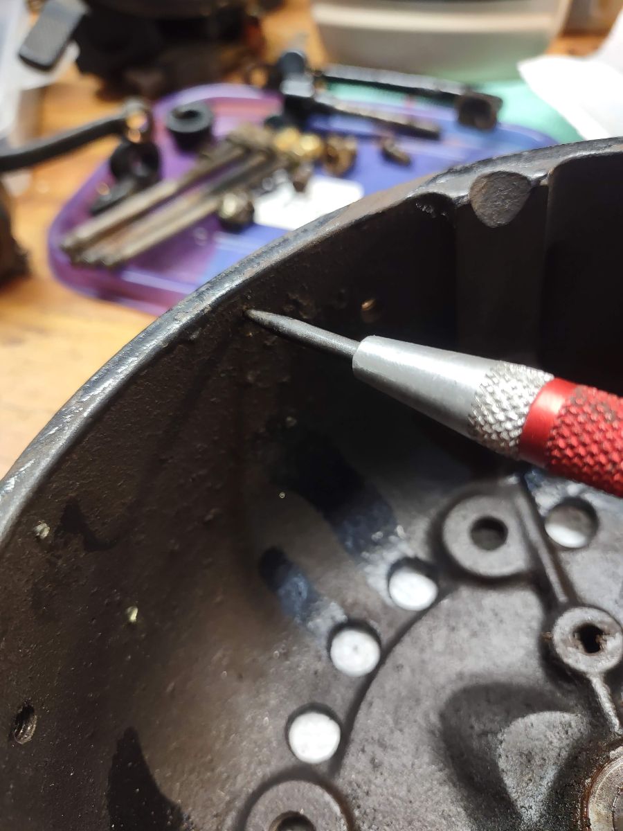

Jay Buchholz Posted August 7, 2023 Author Posted August 7, 2023 14 hours ago, Patrick Ray said: I wrote about some of the process here: https://new.afcaforum.com/index.php?/topic/1039-cleanup-on-a-21666/#comment-6517 Patrick that's a great write up and I plan on following it - thank you for sharing! One question if I could: how do you safely remove rivets for reuse? I've not had good luck with motor tag rivets in the past. Any tips you can share are greatly appreciated. Thanks! Quote
Patrick Ray Posted August 7, 2023 Posted August 7, 2023 I like using an automatic center punch to drive them out. After removing the part of the rivet that is folded over, the center punch easily drives them out. I'll typically reuse them. Quote
Jay Buchholz Posted August 7, 2023 Author Posted August 7, 2023 Got it, thanks. Would you mind sharing your process for reinstalling the rivets too please? I'm clearly out of my element here! 😳 Quote
Patrick Ray Posted August 7, 2023 Posted August 7, 2023 4 minutes ago, Jay Buchholz said: Got it, thanks. Would you mind sharing your process for reinstalling the rivets too please? I'm clearly out of my element here! 😳 Sure! After polishing the heads of the rivets, I'll put a tiny drop of gel-type super glue into the hole of the motor housing (I do this to ensure it's nice and tight). Then I just tap the rivets in with a light hammer. 1 Quote

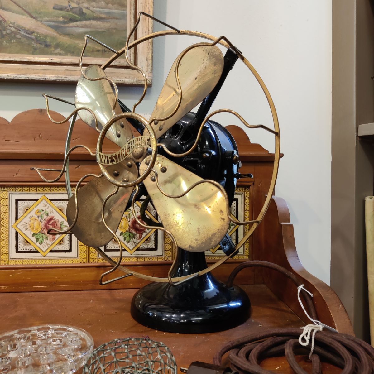

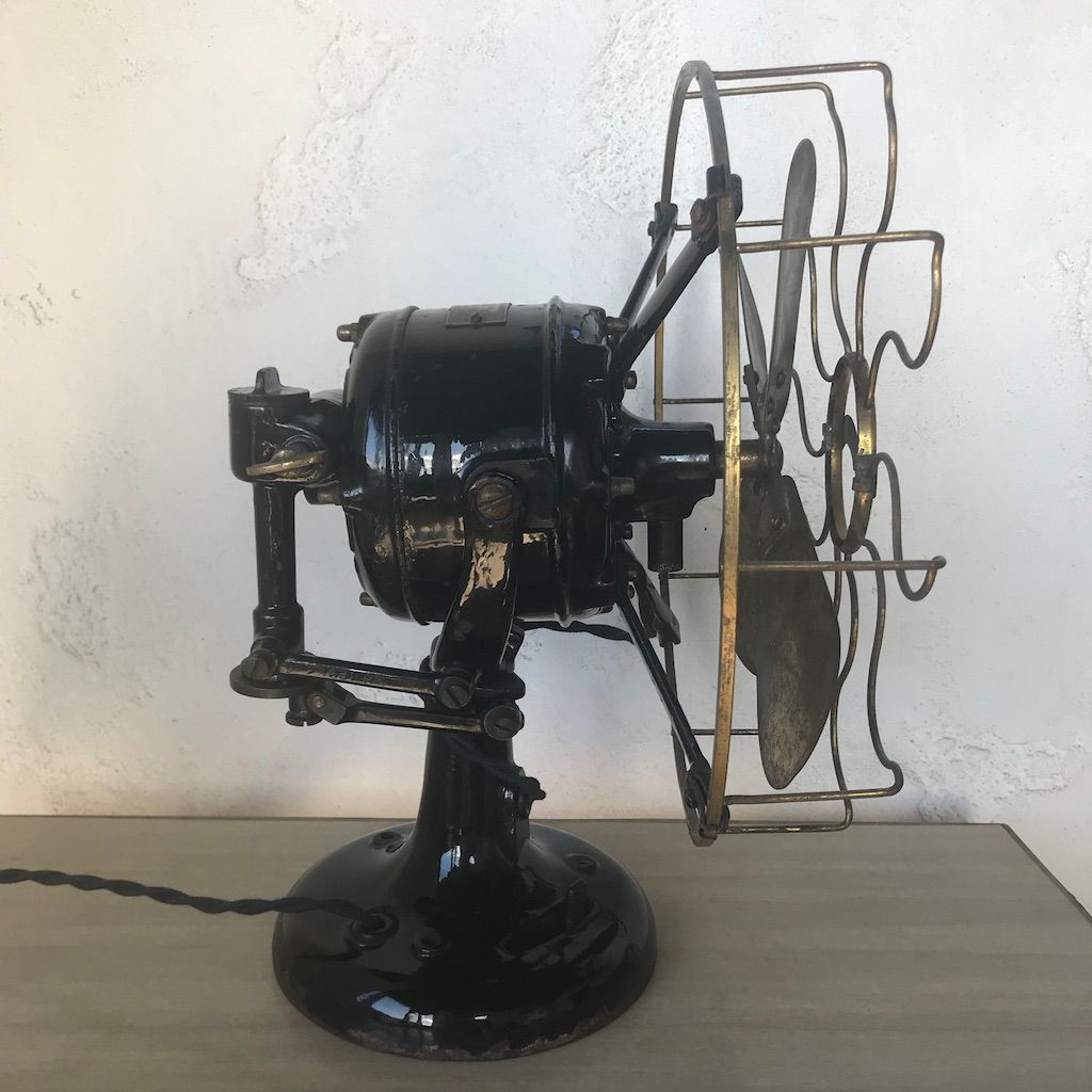

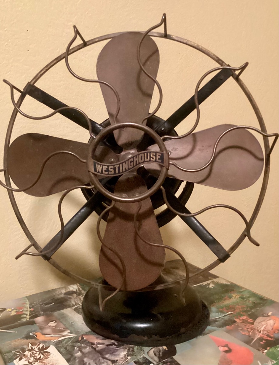

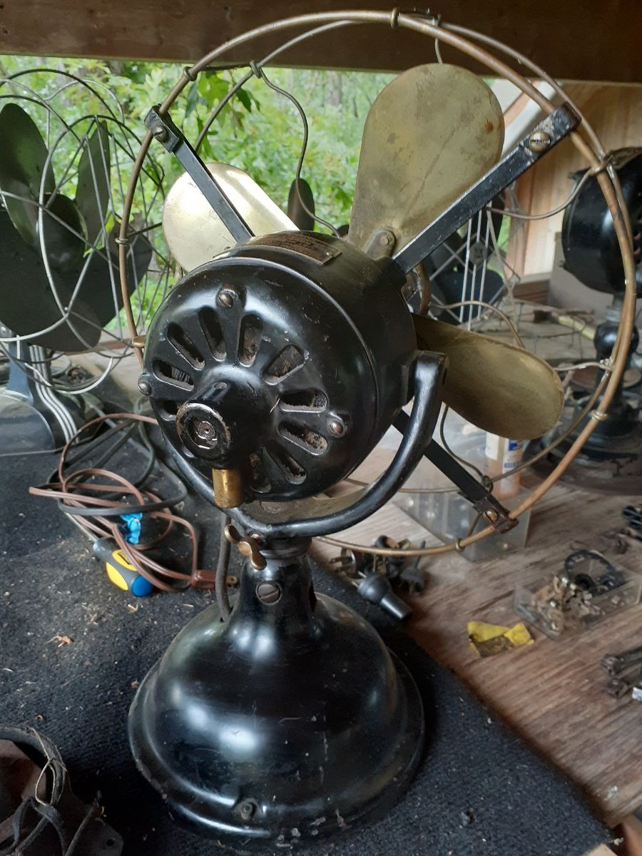

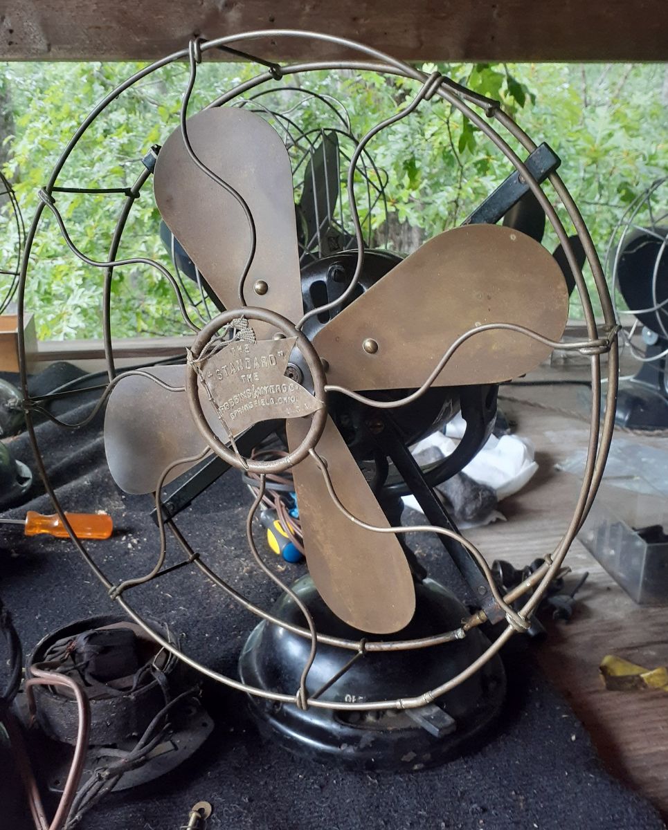

Tom Morel Posted August 8, 2023 Posted August 8, 2023 That is a nice example of one of my favorites. We had a collector here several years ago now who was especially fond of them. Westinghouse used these motors for variety of different models. Here's a few of mine: a double lever oscillator (1911), a 12" (c.1908), and a 16" (c.1907, same as yours). If you grow fond of them, they will accumulate - I have more that I keep around. Nice find. of fans. 1 Quote

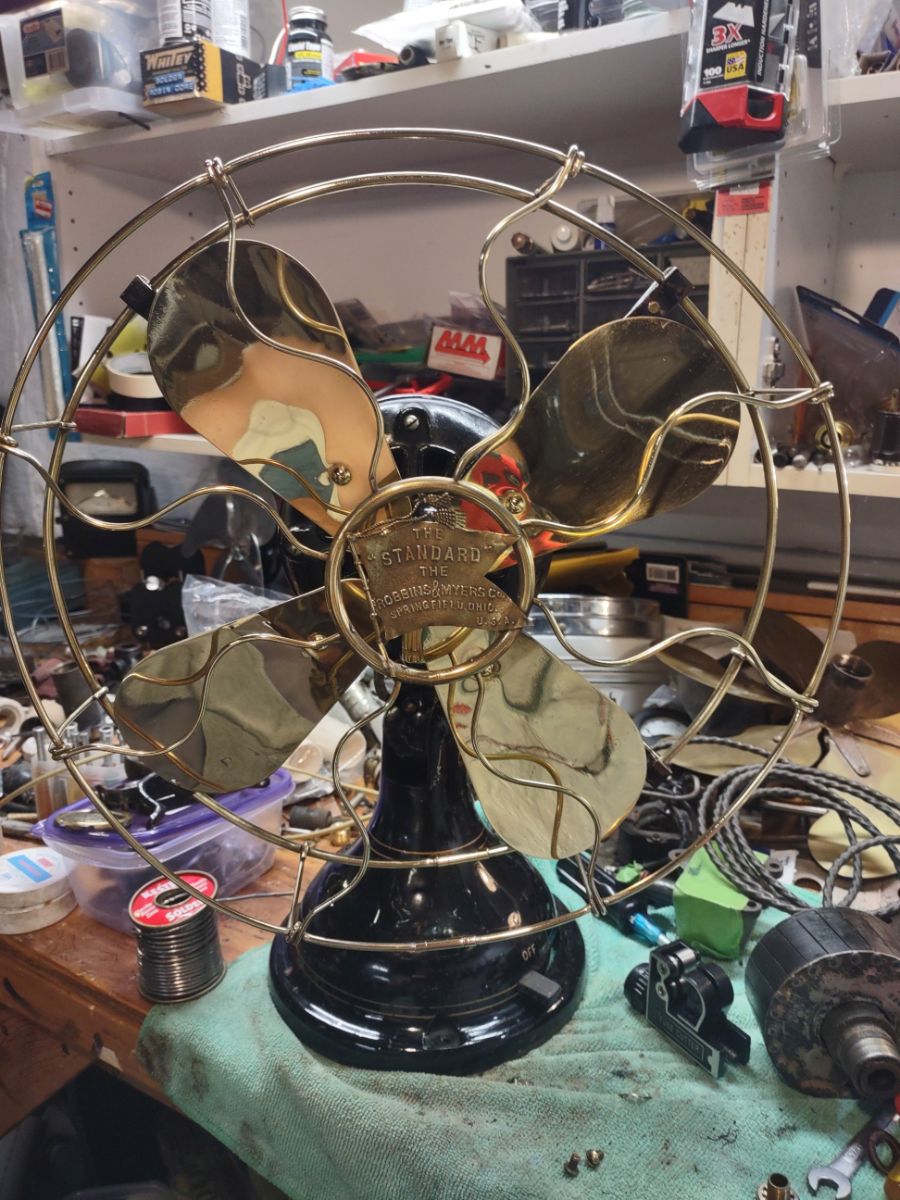

Steven P Dempsey Posted August 8, 2023 Posted August 8, 2023 I always called the R&M "Tanks" - - heavier built then a Westinghouse. LIST 1404 Quote
Steve Stephens Posted August 8, 2023 Posted August 8, 2023 1 hour ago, Steven P Dempsey said: I always called the R&M "Tanks" - - heavier built then a Westinghouse. LIST 1404 I love my R&M 1404 fans but they are a design about 7 years later (1911 vs 1905 for the Westy) design and I think the Westy motor is better looking But the R&M does not have the sometimes cranky centrifugal start switch. I'll keep and like them both but it's the 1404 that I run much more often. Quote
