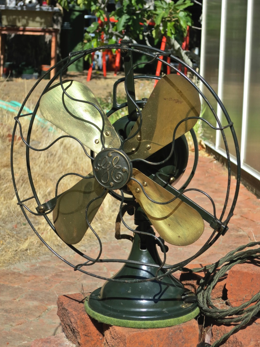

During a Fanfair trip I saw this GE in an antiques mall in the Midwest and plugged it in to find that it did not run.   I think it was $95 which was a good price and the fan looked original.  I put it back then reconsidered and bought it.  The problem it turned out was a power cord wire that had come off of a terminal under the base.  After putting the thumbscrew back tightly the fan worked great.   I added the felt on the base and cleaned the original paint and added a new power cord.
