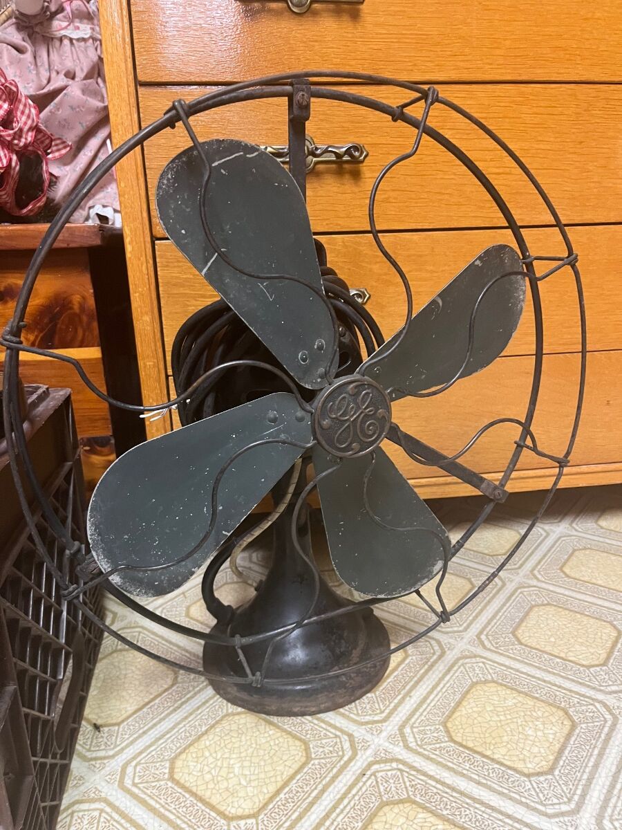

39CE4E54-B22F-4FAA-BF78-39C8DC8DF4AF.thumb.jpeg.de31f5750aaa64d9f0f4e74f7d74b9bd.jpegI have a GE 75425 form R5 that i am restoring. It came with a steel blade and struts. It has a brass cage. I believe this should have a brass blade. Is that correct? If so does someone have a 16” blade for this fan they would sell? I am also looking for a source fot the rubber feet. There are 6 and all are missing. Thanks in advance for any help.
Yes, your fan should be brass.   Is it now aluminum or steel?  Aluminum would be starting in 1930.
