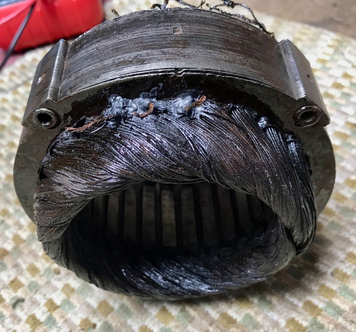

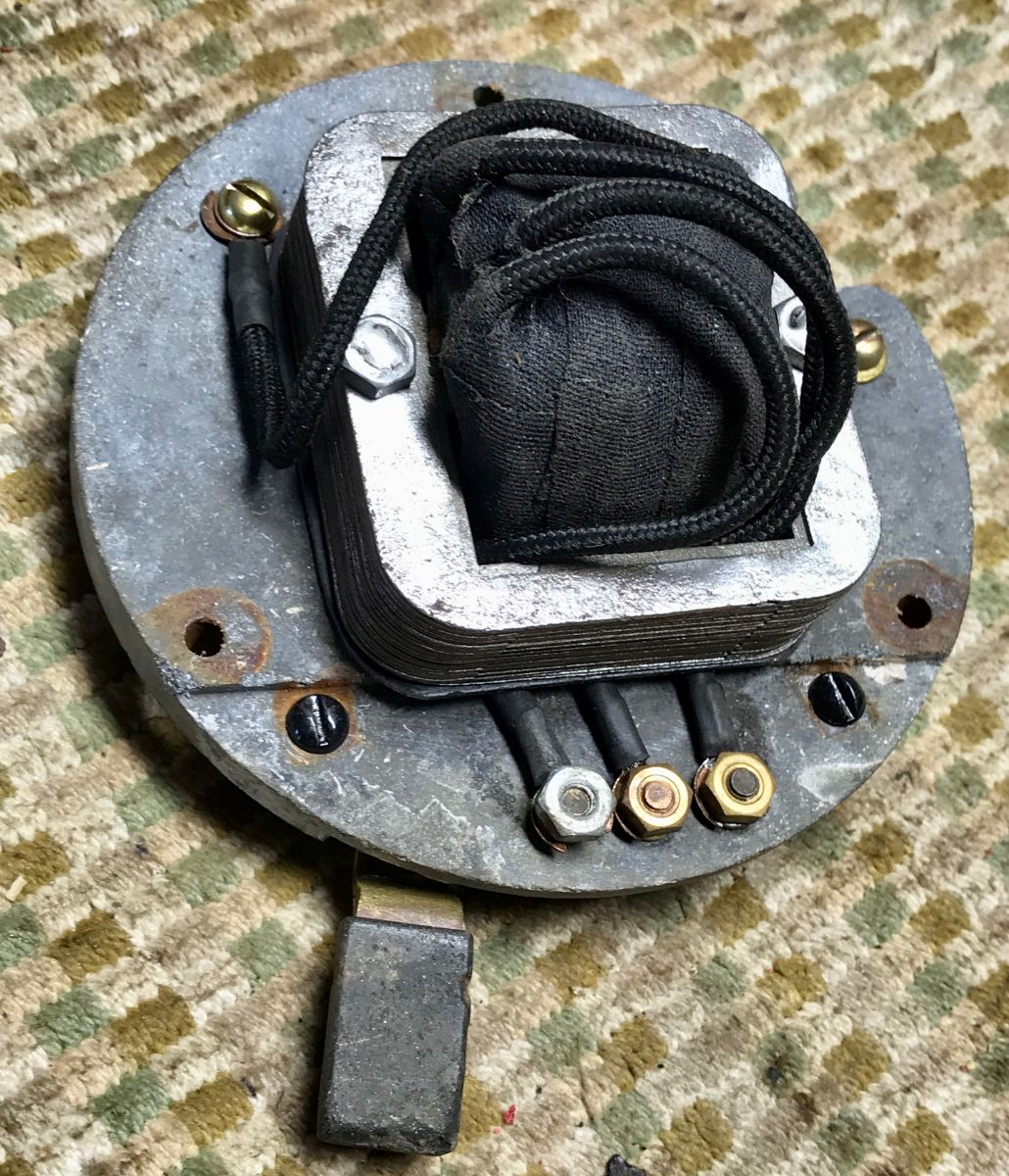

This is the first polyphase stator and switch that I've worked on, so I could really use some help. First I'm trying to determine if the Ohm readings are normal and I have a good stator or not. From left to right I have 27 ohms on wires 1-2, 114 ohms on both 1-3 and 2-3, which seems suspect. I had to replace the wires on the switch and I'm getting these readings to the fly wire. H - 4.3, M - 7.1, L - 8.6 ohms. Is the switch good and wired correctly?
I would love to get a wiring diagram of the switch and stator connections for this fan please. The speed coil is wrapped with string, not tape, I did that when I replaced the wires.
take & jumper the stator leads to the speed coil, I just did this on a 3 star, it was the 5th combo & the fan took right off, the previos ones nothing.
