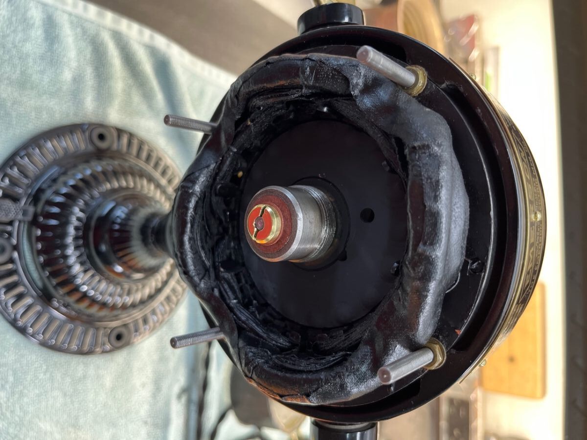

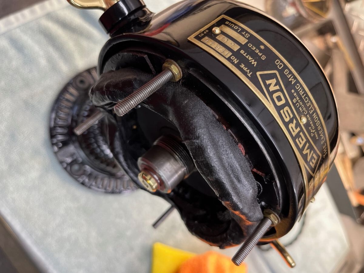

When I got this fan it not have any washers on the blade end just the keeper nut. I need to know what goes there, I put some washers behind the nut (just a guess)
There would be a thin brass washer that fits over the brass slotted keeper shoulder slightly larger outside diameter than the brass slotted keeper. The needed fiber washers behind the washer for rotor end play. Go Bobby, go! 🙂
Thanks Russ, Got it!
