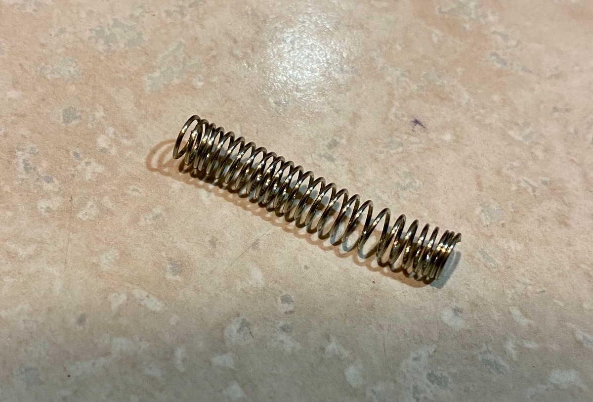

So I grabbed some ordinary 22g wire, a wooden chopstick, and a drill. Two minutes later, and without much care to getting it perfect, I turned out a spring … of sorts. Not great and not one designed to fit anything. Just a “what the heck” moment to see what would happen. I suspect mimicking some of the oiler springs or brush springs will be more complex but I’m learning, again, that it sometimes pays to just try it.
