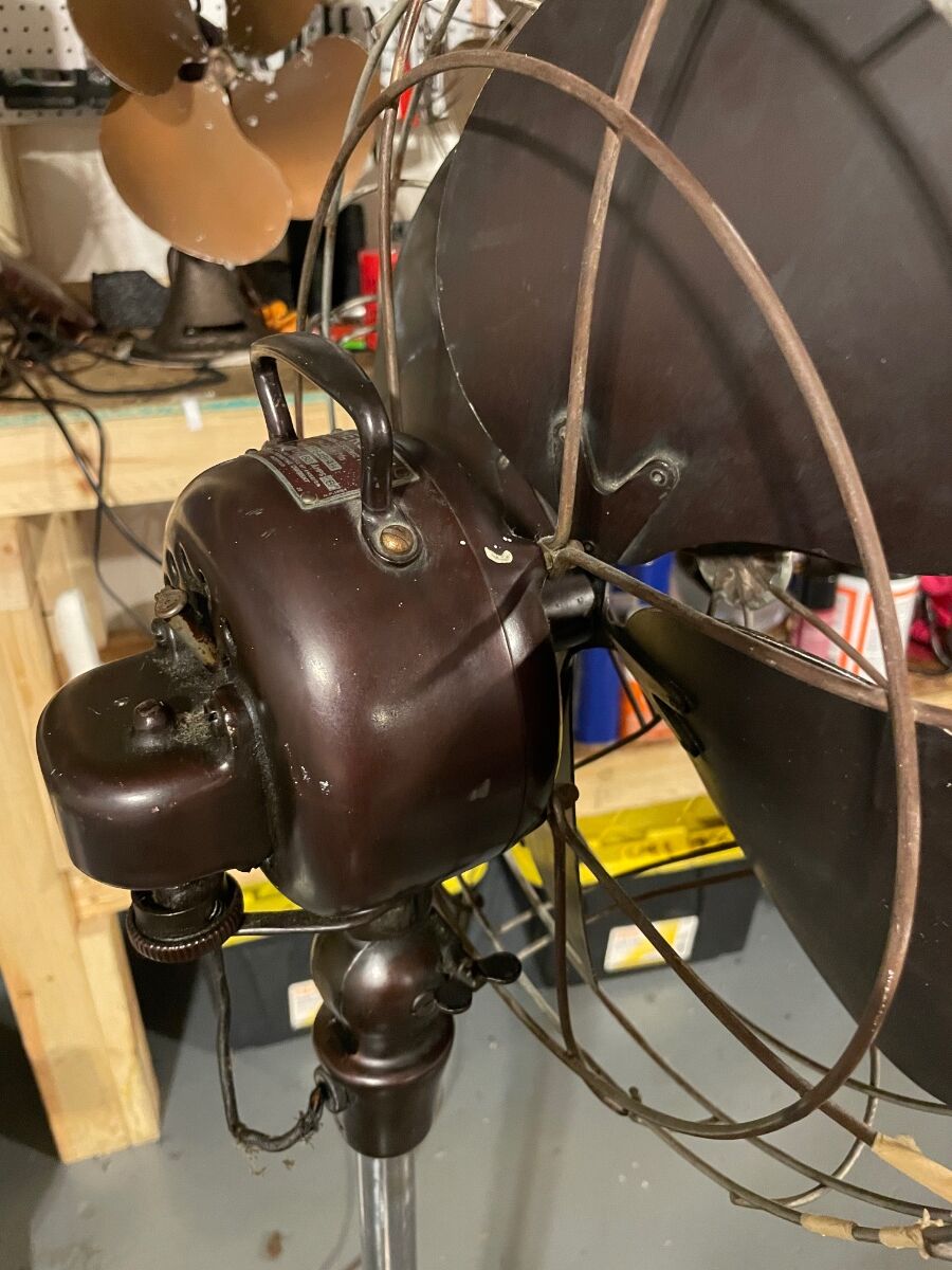

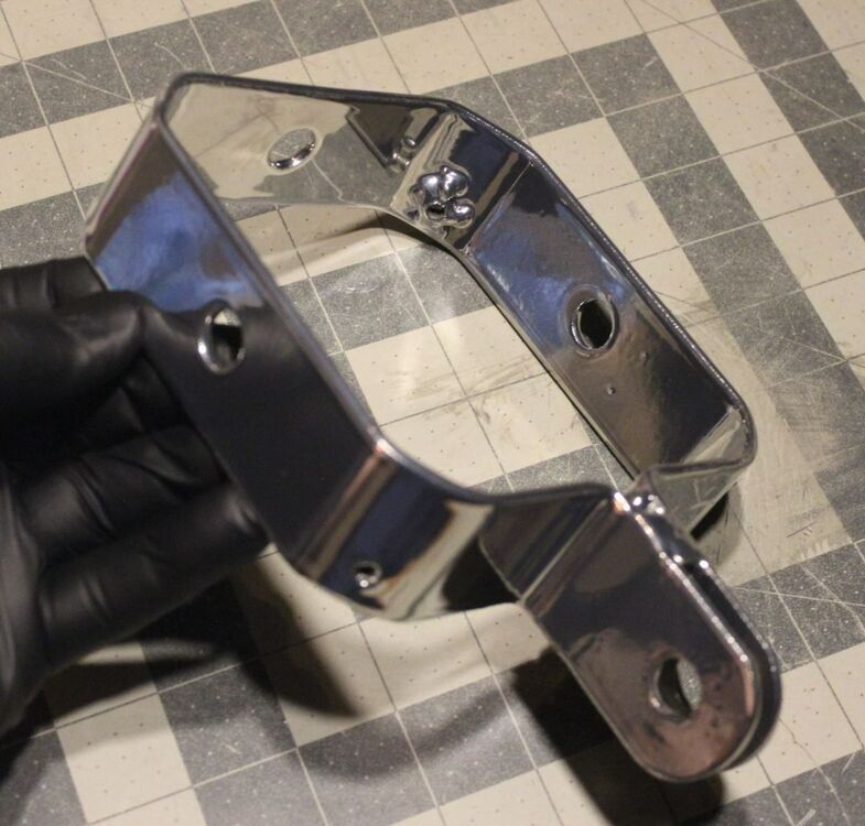

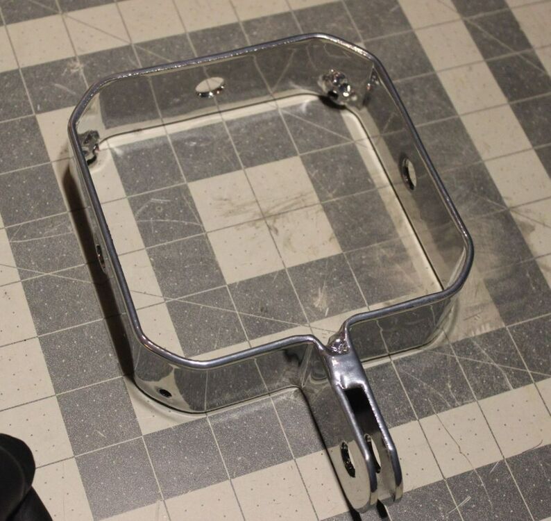

Marc Sova Posted May 15, 2024 Posted May 15, 2024 So Im led to believe the cage on this pedestal Emerson 77648AH I got yesterday was cadmium plated? Did it look like chrome? Or would it have been “warmer” like nickel??? The place where I got the imperial swan cage plated said they could do nickel too (apprently it’s the first step under chrome?). It would have a warmer look to it but would also dull and tarnish(?) unlike chrome. Pondering that for this cage. Quote

Marc Sova Posted May 16, 2024 Author Posted May 16, 2024 7 hours ago, Bill Dunlap said: Cadmium plating process is highly toxic. That's why it has mainly disappeared. In it's place, zinc plating has become the norm. Not to be confused with hot dip galvanizing, which it something entirely different. It's cheap, but they usually quote large lot prices, like 50$ for 25 lbs. so it may not be an option. Nickel plating is nice, but more expensive, but my opinion is that it won't hold up well under constant use, ie. it will rust quickly. I can get the cage chromed for $100. That includes them doing all the stripping and prep etc. I can’t imagine powdercoating being much cheaper. But….i want the look to be closer to original. If chrome is too mirror like then maybe the powder coat is better. Quote
Lane Shirey Posted May 16, 2024 Posted May 16, 2024 Chrome is too shiny. Cad plating when new looks a lot like fresh aluminum. Be careful if sanding that cage, as the sanding dust is very toxic, even if it gets on your skin. Minimally, wear gloves and a face mask. Better yet, do it outdoors. 1 Quote
Marc Sova Posted May 16, 2024 Author Posted May 16, 2024 2 hours ago, Lane Shirey said: Chrome is too shiny. Cad plating when new looks a lot like fresh aluminum. Be careful if sanding that cage, as the sanding dust is very toxic, even if it gets on your skin. Minimally, wear gloves and a face mask. Better yet, do it outdoors. Yeah for sure on the PPE. I’d definitely do it “wet” too with wd40 or blue magic too. That’s kind of what I liked about taking it to this Plating place. They would just dip it in a couple different vats of whatever chemical juice and do all the stripping and what not. But yeah, it sounds like the powder coat might be the best option. Thanks. Quote

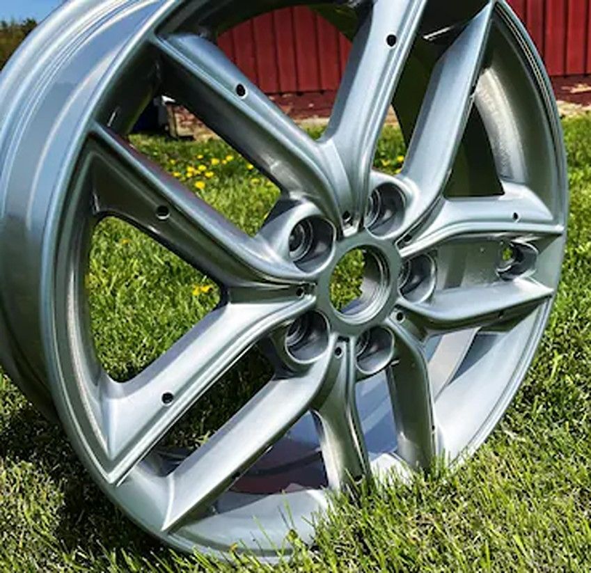

Russ Huber Posted May 19, 2024 Posted May 19, 2024 (edited) Simulation chrome and clear coat powders. SUPER CHROME PLUS | UMS-10671 | Prismatic Powders CLEAR VISION | PPS-2974 | Prismatic Powders Edited May 19, 2024 by Russ Huber Quote
Russ Huber Posted May 19, 2024 Posted May 19, 2024 (edited) Polished aluminum and clear coat powder. POLISHED ALUMINUM | HSS-2345 | Prismatic Powders CLEAR VISION | PPS-2974 | Prismatic Powders Edited May 19, 2024 by Russ Huber Quote
Russ Huber Posted May 19, 2024 Posted May 19, 2024 If you're just doing one guard per, say, go talk to a REPUTIBLE powder coater. They have powders like this in stock and have the ability to match what you seek. I have ordered in bulk from Prismatic for multiple future projects. Quote

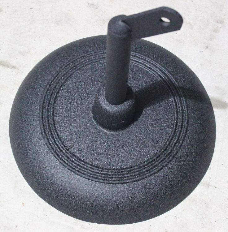

Russ Huber Posted May 19, 2024 Posted May 19, 2024 I ordered this wrinkle finish below in bulk from Prismatic, but the powder coater had their own wrinkle finish from their supplier. Powder coating finishes are expanding big time. Quote
